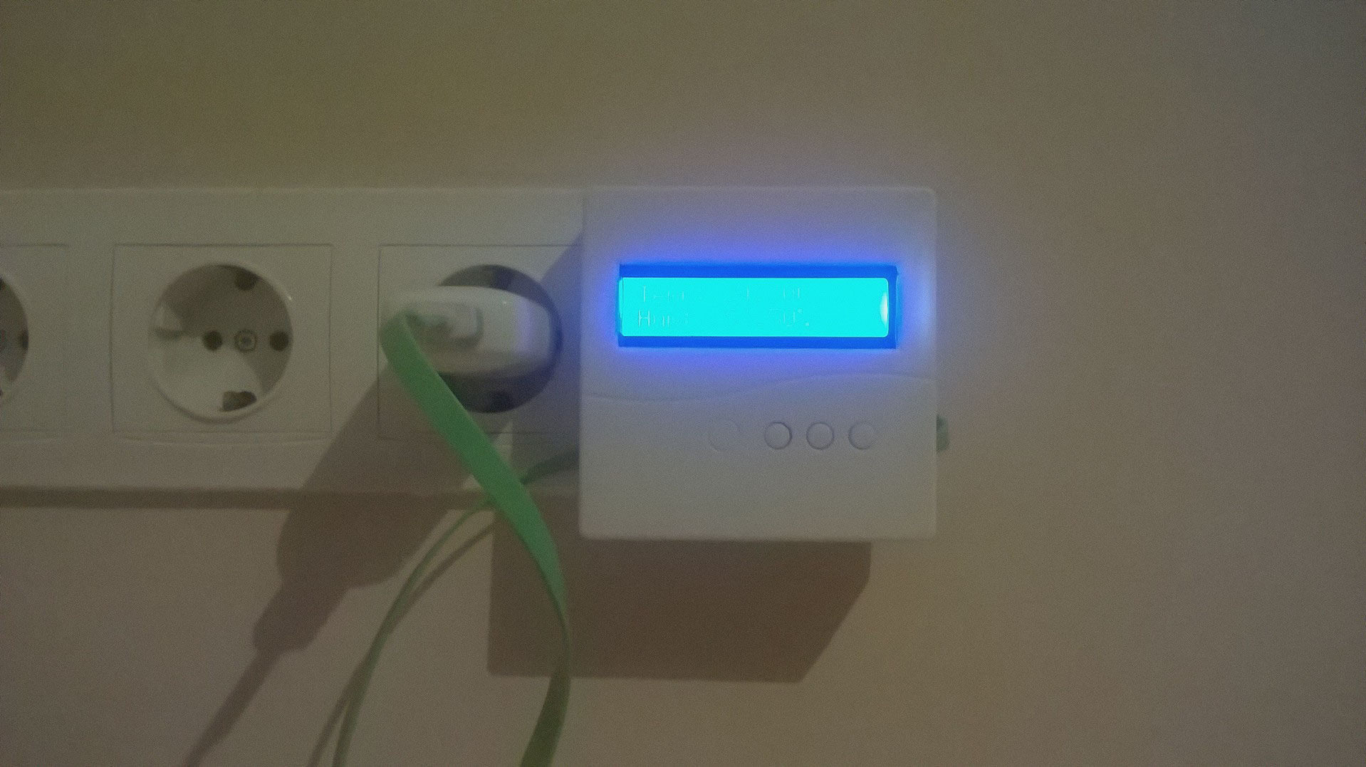

My first node is simple room thermostat, tracking room temperature and humidity. It has DHT22, ESP8266 nodemcu, 1602 LCD with SPI, and enclosure that I have find on ebay (http://www.ebay.com/itm/221886834275?_t ... EBIDX%3AIT). Image is taken with phone
There is some problems with LCD, I need to update setup with voltage booster, LCD are on 3.3V from ESP and I will need to feed with 5v. My next setup have 1602LCD on 5V.
