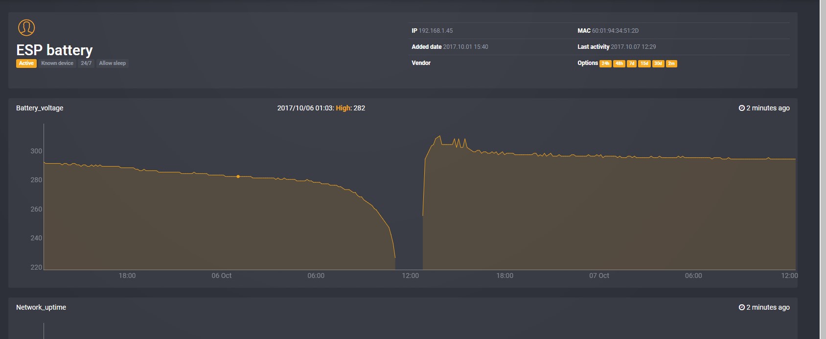

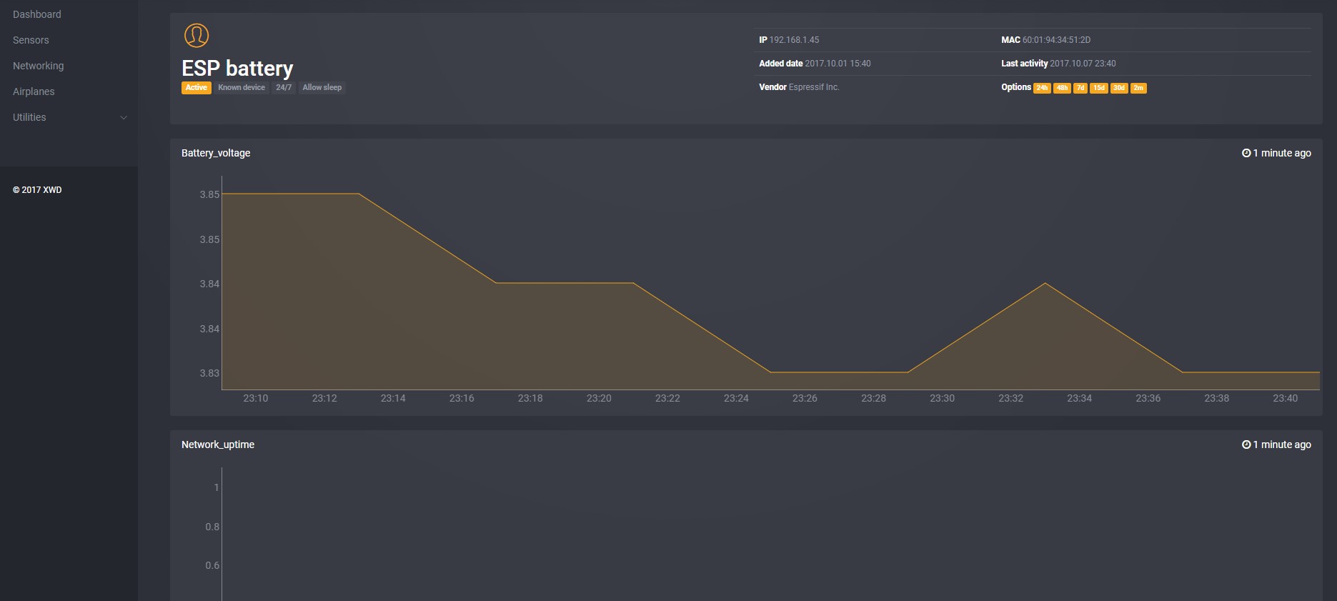

That sensor also measures voltage? as I'm not that interested in current value, probably the current will be at the highest value when the ESP will be turned on from sleep, and indeed the measurements will not be quite realistic , but I don't mind having the voltage measured only once at 5 minutes, as I will set sleep interval ~5 minutes, will the voltage drop that much when the board will be ON from sleep?
These are the measurements made until now, the maximum value is around 300 .. so ~0.3v with the wiring I made a few days ago. I will try to make some scripts in my dashboard to find out when the voltage drops at a higher rate, to send a notification to my phone when the voltage drops faster, as I can see at low voltage, the battery voltage dropped quite fast. The values are not useful now, but I will see when I will be able to measure from 4.2v

As the board already had a 220k resistor I connected an 100k one inline and now I finally have a good reading
I used this formula to match the reading with my multimeter
%value%*4.4/1024
In the morning I will check again to compare the voltage on my multimeter with the reported voltage, hope it will still be synced.
