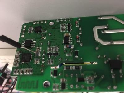

I received the device today. The flash was success full with ESPEasy, without problems.
BUT it don't know which two GPIO's are used for the relais. Any ideas? Please help
For flashing I used this picture. Pin: VCC (3.3V), RX, TX, GND
and set this ESP PIN GPIO00 to ground.

I received a Sonoff Dual today, it has the SIL F330 chip on it which controls the relays. I would like to use the Sonoff with ESP EASY and Domoticz.moelski wrote: ↑29 Dec 2016, 08:28 Hi !
Hmm Looks like simple send some data over the Serial port.We have to send the hex value:
0x00 both off
0x01 relay one on
0x02 relay two on
0x03 both relays on
..but how?
But I wonder a Little about the INT / E-FW Connection.
But sending some data within a new plugin is really straight forward![]()
Since i'm new to ESP EASY (and only got an Oled screen and a led working on a NodeMCU v3 board), i don't quite understand how to get the Sonoff working with the F330 chip. Where can i find more information about this?
Flashing the Sonoff shouldn't be a problem, but the working with the F330 chip is a problem.

Hey I got the ESP dual working without any plugins or anything other than basic esp easyrfromr wrote: ↑21 Dec 2016, 17:13 Hello,
What you need to do is take a wire solder it to the pin of the ESP then solder the other end to the transistor driving the relay. then when you drive the pin high the relay goes high. However the downside of this is you lose the function of your LEDs that note the relays on and off
I will see if I can get a picture tonight of what I did

So that's kind of a "dirty" solution to the problem i think.bobbybeans wrote: ↑14 Mar 2017, 18:28Hey I got the ESP dual working without any plugins or anything other than basic esp easyrfromr wrote: ↑21 Dec 2016, 17:13 Hello,
There is someone that has this woring with his own ESPurna firmware.
Would it in any way be possible to implement his code for controlling the F330 chip into ESPEasy?

opps completely forgot to get the picture, but yes i agree it is dirty and i did it before espruna even had it working. I will keep it, till espeasy has it workingBounceMeister wrote: ↑20 Mar 2017, 11:00So that's kind of a "dirty" solution to the problem i think.bobbybeans wrote: ↑14 Mar 2017, 18:28Hey I got the ESP dual working without any plugins or anything other than basic esp easyrfromr wrote: ↑21 Dec 2016, 17:13 Hello,
