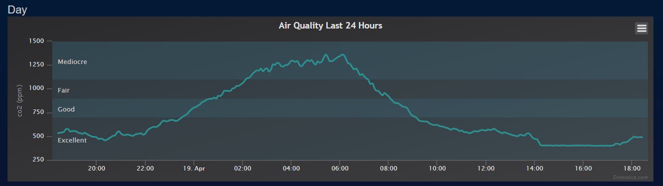

What is best to use in combination ESPEasy and MH-Z19B and Domoticz, air quality or custom sensor?
I have two CO2 sensors, the first one worked perfectly with air quality from March 18 to April 7, then it did not constantly refresh the data in Domoticz, now switched to custom sensor.
The second one works perfectly with air quality.
My question, what can this be due to and which one is preferred?
Personally, I like the air quality one better because it makes the quality visible.

i would use the air quality sensor in domoticz
it's graphs are way better and it actually talks about CO2
this sensor needs the nvalue so you need to use the rules
Publish domoticz/in,'{"idx":349,"nvalue":[Slaapkamer#PPM],"svalue":""}' // CO2 sensor in domoticz needs Nvalue

now that the weather is getting better i also notice the levels at night rise.
good to know that the sensor is still measuring higher levels
