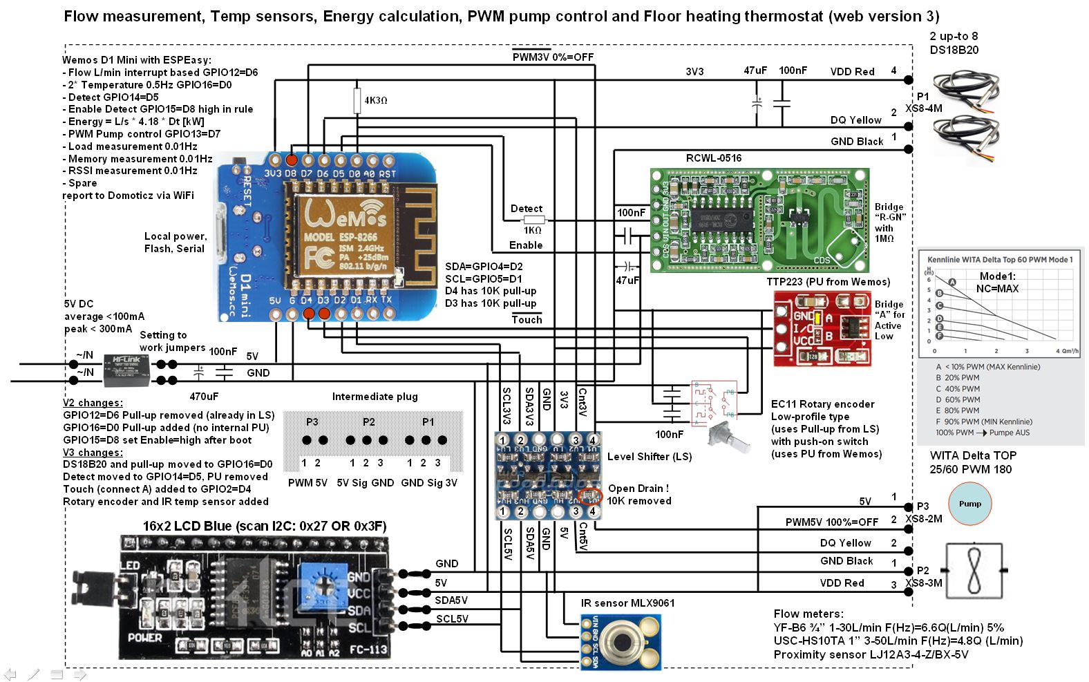

- Electrical scheme
Re-arrangement of GPIO's
DS18B20 and pull-up moved to GPIO16=D0
Detect moved to GPIO14=D5, PU removed, current limiter resistor added
Touch (connect A) added to GPIO2=D4 (has PU on the Wemos board)

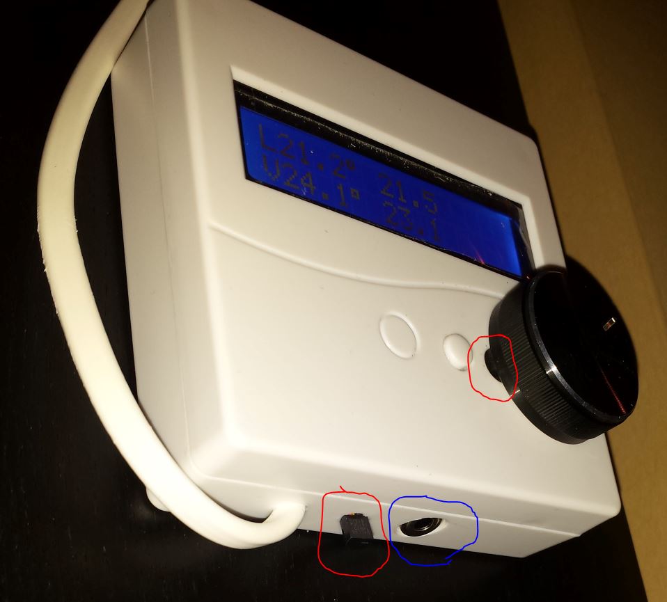

Optional Rotary encoder added, uses PU of the Level Convertor (in that case the Flow meter and PWM are not used and have no plug)
Rotary encoder switch added to GPIO0=D3 (has PU on the Wemos board)
Optional IR temp sensor MLX9061 added for air and floor measurement (hole trough the housing on position of Flow meter plug)
For IR temp senosor, see patent reference: viewtopic.php?f=2&t=5955&p=32481#p33929

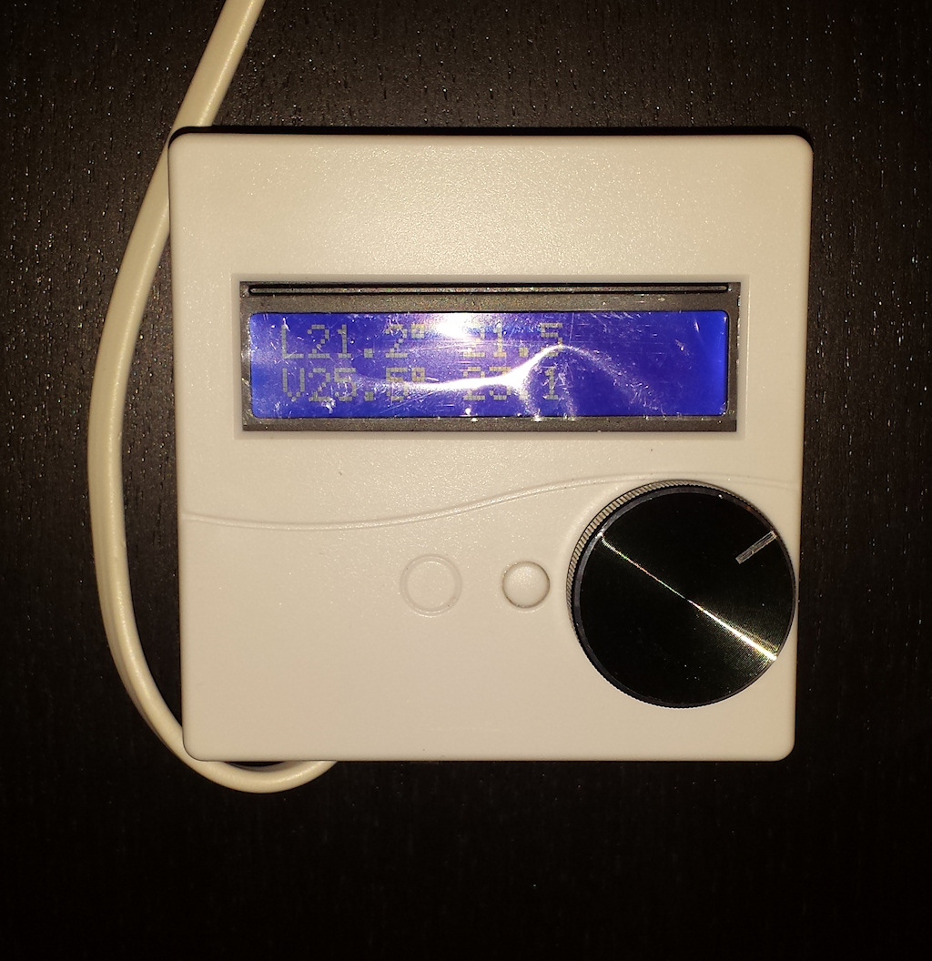

This set of components just fit in the 86 Plastic Project Box (8.6*8.6*2.6cm), that has on the backside a DIN rail adapter.
I/O
- 230V, less then 1.5Watt
- XS8-4 M-plug: 2 up to 8 DS18B20 sensors
- XS8-3 M-plug: Flow meter like YF-B6, USC-HS10TA or proximity sensor LJ12A3-4-Z/BX-5V
- XS8-2 M-plug: WITA Delta Top 25/60 PWM 180 pump

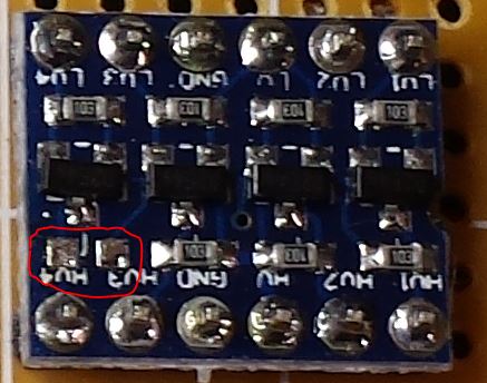

The level converter is modified: from channel 4, the 10KOhm Drain resistor is removed,
to support max 5mA PWM current as needed for the WITA pump.
The RCWL-0516 is modified, the 220 Ohm Antenna resistor is replaced by 330 Ohm ([edit]: 470 Ohm not correct) to reduce the detection range.

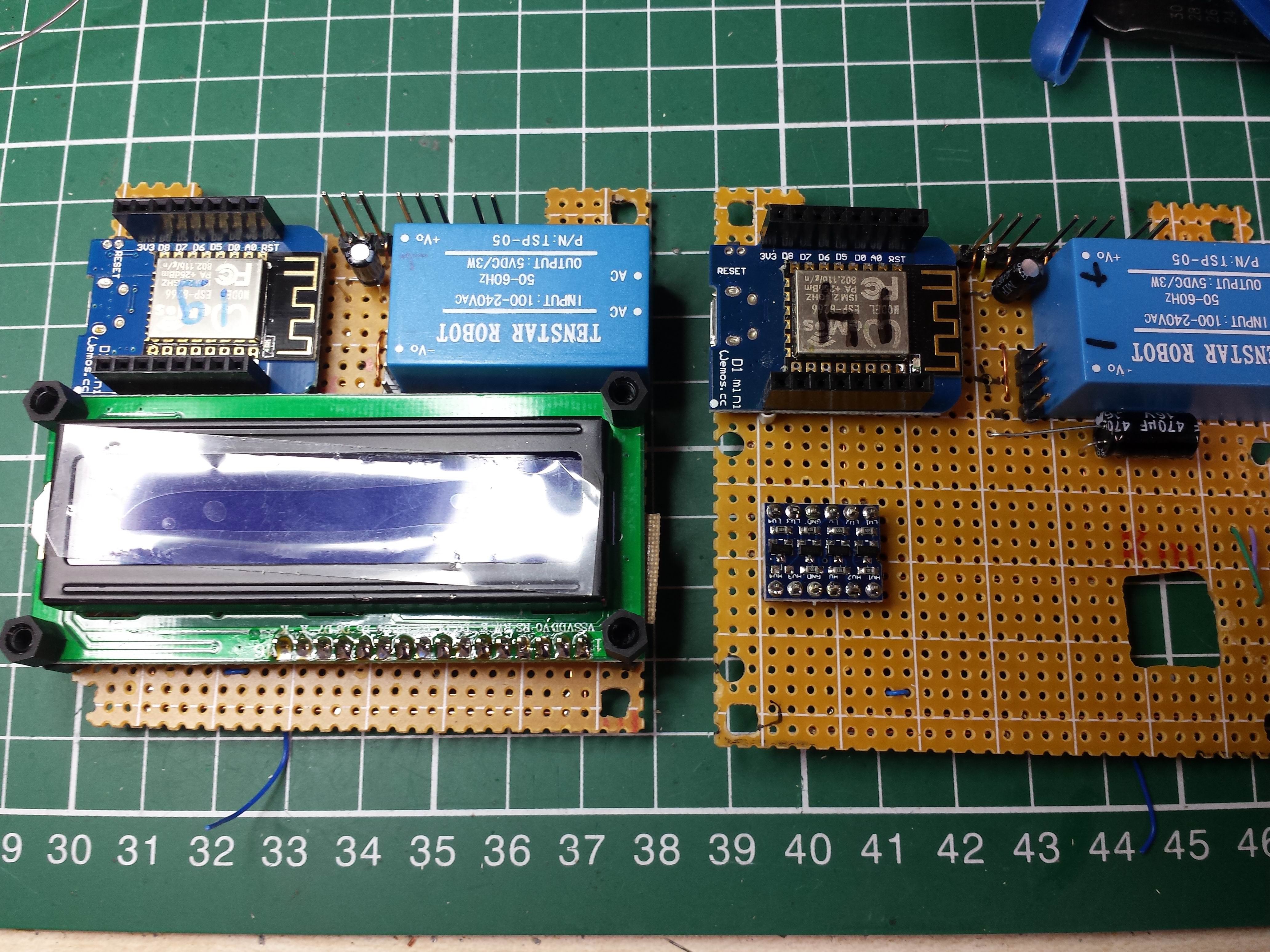

Currently I have 6 units under production:
2# housing closed & under test
2# housing open & under test
2# soldering & waiting for parts
[edit 3-11-18]:
update to scheme V2
Pull-up Cnt3V removed (PU already in LC)
RCWL-0516 330 Ohm still under test
Enable RCWL-0516 added against alarm flooding
Capacitors added against false alarms

Building suggestions 1
(description level: beginner/intermediate)
Sorry: Board problem with pictures, need to solve this
Create a drilling template, print it on sticker paper (see picture below) and use some dish-washing liquid on the box before you sticker it to move it in the correct position (drying needs some time). Make sure... on the bottom side, check the sliding screw holes!
Mark the drilling positions with a piercer, drill 1mm, then 5mm.
Use the step cone drill, for smooth result, to enlarge the 3 right holes to 8mm.
Remove, by cutting, the internal plastic screw protection (we need all the space in the box).
Use 4mm slanted head screws to mount the DIN rail adapter (not upside down!) and isolate the screws.
Cut the middle set of 3 out of the 5 supplied buttons and glue them in the box (to fill the holes, no other function).
Left: top UP, Right: bottom UP:
Pic1
Wire the plugs with slanted CAT5 cable. Check the XS8-4 pole for numbering, I have seen different number schemes. No problem as long as you don't mix order batches (as I did).
Prepare a 230V cable, add the Power Cord plug, where using ferrules and crimper plier gives a nice and safe result (see BOM)
Pic2
I don't have the experience for PCB design and production. To prevent lead-times, re-work and lead-times again, I used my eighties skills of soldering and Wire-Wrap.
Cut a 79.5mm * 79.5mm PCB board (mark it with a Stanley knife and break along the lines).
Clear 8mm space for the plugs. Drill mounting holes on the corners and holes for the LCD spacers (10.6 and 41mm from the top, very close to the side). Clear some space (10.9*10.9mm) for the LCD back-light potentiometer (12.9mm from top and from the right).
Check your LCD, I have seen some different sizes for this potmeter.
Clear the copper around the 230V side of the power supply.
Solder the 5V and 3.3V power-line. The Ground-line has 2 Via's: 1 under the level shifter and one to pass the 5V line. The 5V power supply goes via 2 jumpers (for setting to work) to the 5V- and Ground-line. The 3.3V line is feeded by the Wemos D1 Mini.
Pic3
Pic1
Pic2
Pic3

Check the LCD for a correct mounting of the I2C print (straight, in parallel with the LCD)
With my second batch of 2# LCD's this was not, and it took a lot of de-soldering rework to get it corrected. Lessons learned: buy seperate LCD an I2C units.
Place some isolation tape in the free space between the LCD an I2C unit, to prevent contact if we close the box.
Use 2 times 4 spacers of 6mm (see BOM) : under and on top of the LCD
On the back of the I2C unit there are 2 pins for the LCD back-light (with jumper).
Cut the pins, remove the PVC holder, cut again and solder a connection between them.
Turn the other 4 pins 90 decrease to go trough the PCB holes.
Check that the potentiometer of the I2C unit goes trough the cutted PCB hole
The Level Converter is placed under the LCD, also there put some isolation on the LCD.
Check that it fits between the mechanical lips of the LCD.
Also the 470uF Elco is placed under the LCD, check for the correct position, the mechanical lip of the LCD.
At the side of the power supply there is a 2*2 pin jumper configuration to decouple the PS from the circuit. Here you can insert 5V from an external power supply with current limitation during Setting To Work (STW).
The interface between PCB and connector cables is via long pins. Long pins because they are convenient for Dupont wires to measure. From PCB to the pins via a hole in front and power/ground soldered on top, plug cables soldered on the bottom of the pins. The 47uF Elco sits in front of the DS18B20 power lines for undisturbed power.
The Wemos D1 mini has it's USB connection to the outside, not optimal for the WiFi so close to the PS, but needed in case of a "hard programming".
The Wemos female connectors are convenient for measurement during STW.
As spacer under the Wemos I use 4 small cuts from plastic swab stems.
Keep the height of the Wemos below the PS height.
Also cut the long pins some more below the PS height (for the unused buttons on the cover)
For all data-lines I use WireWrap with AWG30 wire (see BOM), a simple and convenient way of connecting.

RCWL-0516 Microwave Radar modification and TTP223 Touch sensor usage:
After endurance tests with several units, I skipped the idea of replacing the resistor on the left bottom marked 221 (220 Ohm, 0805 SMD) by a 470 Ohm.
With the 470 Ohm you reduce the antenna gain.
It does reduce the detection range to around 1 meter.
But ... side effect ... it shifts also the center frequency ..I assume too close to the 2.4Ghz WiFi frequency.
Currently I use a 1M-ohm type 0805 SMD on position R-GN on the RCWL-0516 it reduces the range to 5m according to spec.
Tested on several units, and gives a good result.
My experience is that it reduces detection down to ~3 meter.
This could be caused by the close mounting to the LCD1602 with it's metal frame.
Use a 1KOhm series resistor to limit the output current.
Detection's from the RCWL-0516 are used to switch the LCD back-light on, for a limited time (via a Rule).
With the "Enable" connection it is possible to define in a rule, if the RCWL-0516 is active.
My experience so far is that "Enable" always leads to a detection ... (have to check further).
The idea is to switch off the RCWL-0516 while the LCD back-light is on, to prevent a flood of detection interrupts when people stay longer in close vicinity.
When multiple units are close to each other(like in the boiler room), I foresee that there will be only one RCWL-0516 active, to prevent interference and race conditions.
The "Detection" will then be distributed to the other close-by units via a rule and inter-ESP communication (have to find out how).
As alternative a TTP223 touch switch is mounted at the side of the RCWL-0516. (photo will follow)
This switch is a parallel possibility to switch the LCD on, for a limited time (via a Rule).
The TTP223 is connected to GPIO2=D4 with a pull-up resistor on the Wemos board (needed for boot).
Therefore the TTP223 needs to be active "Low": the pad marked "A" needs to be interconnected.
As result the red Led is always on. So I removed the serial resistor marked 121.
The TTP223 has also a double-click role for the thermostat setting.

Level shifter modification and PWM discussion.
In 2014, I modified the Grundfos UPS 25-60-180 floorheating pump's from a mechanical 3 speed adjustment to a Z-wave 3 speed plus Off remote control capability.
See:http://www.domoticz.com/forum/viewtopic.php?f=34&t=5025
Thanks to this modification the electrical usage is rather low.
During the upcoming refurbishment those pumps will be replaced as precaution (after 23 years of problem-free operation!).
The same type is still available, but also more efficient permanent-magnet pumps are available (f.i. Wilo, Gundfos, OEG)

With: 4 constant characteristics, 4 proportional characteristics, minimum operating Level, externally controllable PWM characteristics.
It has a PWM Heating characteristic:
When the PWM signal is switched off, the pump runs at maximum speed. This ensures that the system can function in an emergency, even if the controller is defective or the connection cable is broken. As the PWM signal rises, the speed of the pump falls.
And it has a PWM Solar characteristic: (not used)
When the PWM signal is switched off, the pump is in stand-by mode. This ensures that the system does not overheat.
Nice he?
There is no need to note the polarity of the lead.
PWM current is not specified (not so nice!) but after contact with Wita, they stated 5mA (@ 4.5 - 15V / 100 - 1000Hz). So, some kind of level shifting of the ESP PWM output pin is needed.
The used level shifter can not supply 5mA as it is a high resistance solution.
Therefor I removed the pull-up 10K SMD resistor of channel 4. That means it now also acts as inverter.
ESP PWM control must compensate for that. As the PWM signal rises, the speed of the pump rises.
The PWM of the pump must be connected to 5V and the level shifter pin.
(Looks somewhat strange, 5V as reference, but it acts on potential difference, in theory it must work, not tested yet).
Speed control will be based on DeltaT between incoming and outgoing.
High speed at large DeltaT.
In this way an optimal emission from the floor to the room should be possible.

Solved HW issues:
- taming the RCWL-0516 (solved with 1K serial resistor in V3)
- re-order of GPIO's (solved with V3)
- TTP223: because of the bridge "A" for Active Low, the red LED is always on, unless touched. This red light shines trough the Plastic Project Box Case. Solution: just remove the LED with a solder iron.
- The LCD has stray light on left/right sides, that shines trough the Plastic Project Box Case. Use a thin layer of Black Melt Glue to block the unwanted light.
[edit 19-01-2019] 4 solved HW issues: RCWL-0516, GPIO re-arrangement,TTP223 and GPIO re-order.

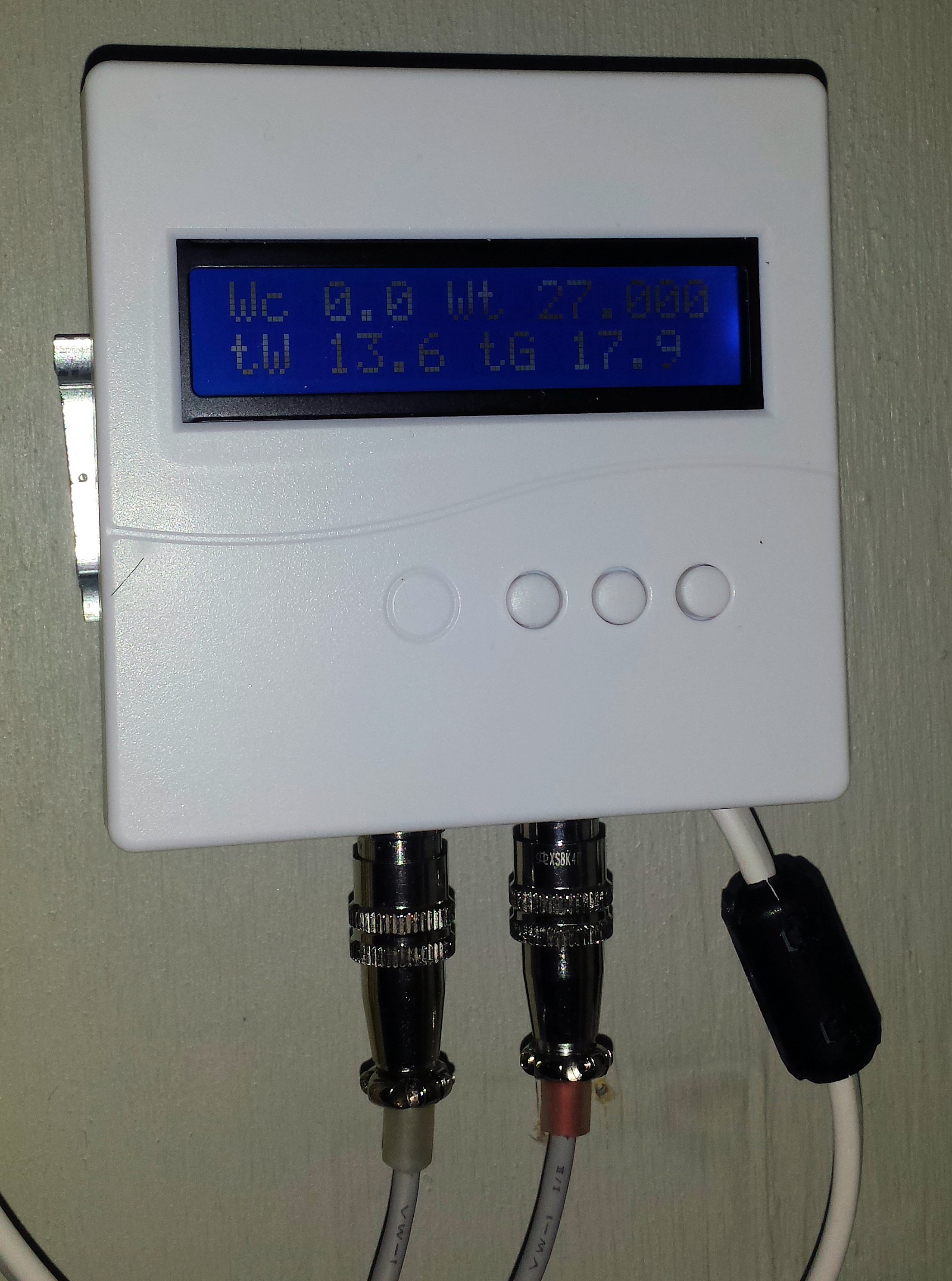

Water measurement with inductive proximity sensor switch NPN NO LJ12A3-4-Z/BX-5V
Incoming fresh water measurement with inductive proximity sensor switch NPN NO LJ12A3-4-Z/BX-5V
Make sure you have the 5V version ! Then it can be connected via a standard level converter.
To mount the NO LJ12A3-4-Z/BX-5V, I have used a scrap piece of Acryl/Acrylic.
Drilled a hole and used a heater to bend it 90 degrees.
2# clamps of 80mm, used for rain drains, hold the support in place.
Make sure that the sensor is mounted as close as possible to the rotating metal indicator.
Check the red led when the indicator is rotating.
If needed, you can use a hand file to make the blue cover somewhat thinner without damaging the sensor.
Stop filing when you see an inner circle appearing. The inner sensor is than still protected.
(was needed for my 12V type prototype, not for the 5V version)
Additionally #2 DS18B20 sensor are used:
- one for the incoming water temperature (useful)
- one for the incoming gas temperature (curiosity)
I use Aluminum Foil Adhesive Sealing Tape to mount the metal shield of the DS18B20 on the pipe.
Use the Generic Pulse counter as device, named Flow:
- GPIO-12 (D6)
- Debounce time: 0
- Counter Type: Delta
- Mode Type: Rising
- IDX from Domoticz, create a General, Counter Incremental (adjust the meter offset there)
- Interval 60 sec
- Count: 1 decimal
- Total: 3 decimal

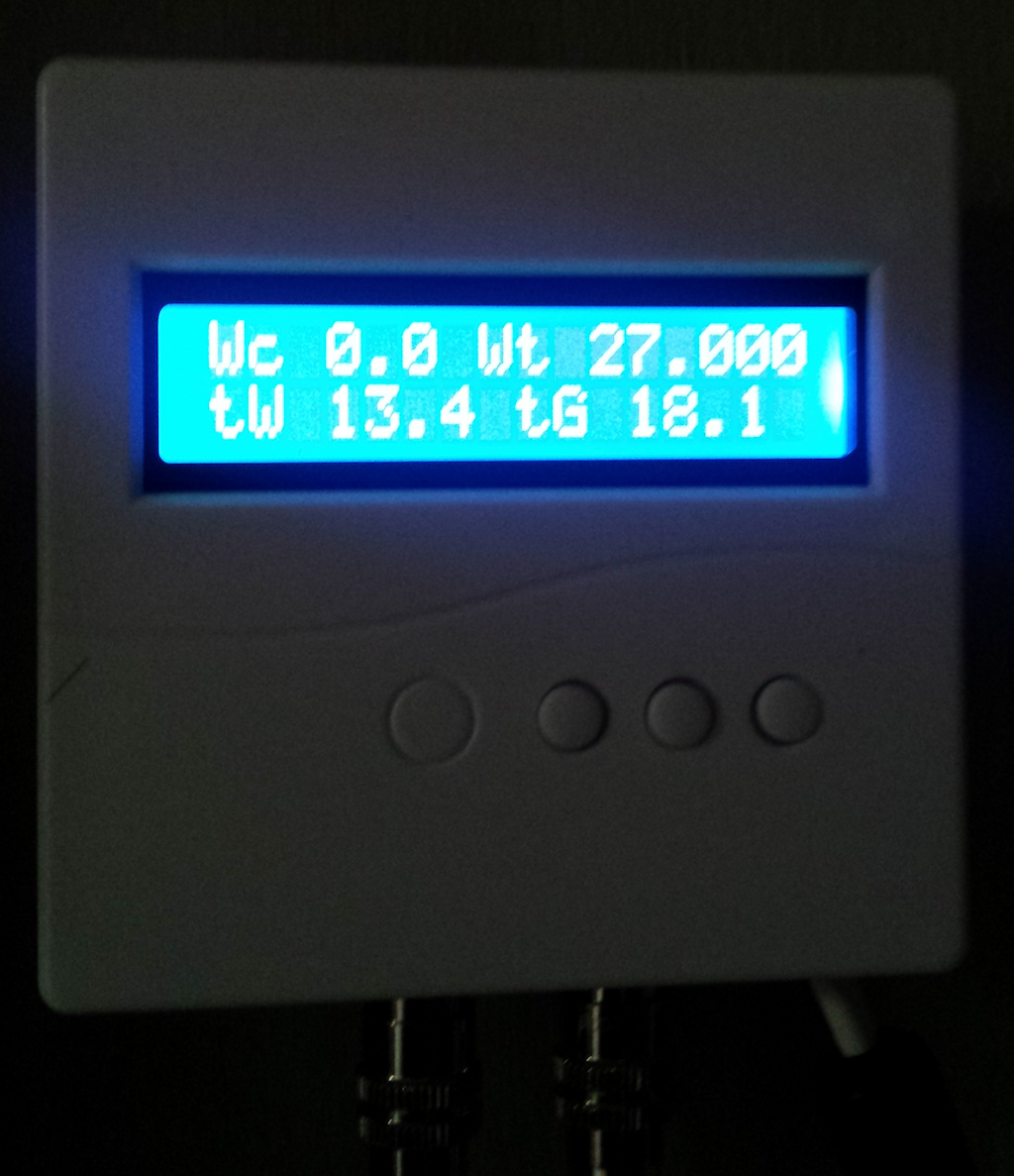

Display:
scan for I2C address: 0x27 OR 0x3F (Tools page)
Line 1: Wc [Flow#Count] Wt [Flow#Total]
Line 2: tW [TempL#TemperatureL] tG [TempH#TemperatureH]
Interval: 30 sec.
(with temperature task TempL value name TemperatureL and temperature task TempH value name TemperatureH)
. The PWM plug (P3) is not implemented here
The front-side buttons are only to cover the standard holes.
With the IDX in the Flow task, Domoticz shows the hourly water usage: L/hour.

Interval: 30 sec.
To get more than 1 value in Domoticz, I use this Rule:
On Flow#Count do
SendToHTTP 192.168.1.7,8080,/json.htm?type=command¶m=udevice&idx=171&nvalue=0&svalue=[Flow#Count]
SendToHTTP 192.168.1.7,8080,/json.htm?type=command¶m=udevice&idx=122&nvalue=0&svalue=[Flow#Count]
SendToHTTP 192.168.1.7,8080,/json.htm?type=command¶m=udevice&idx=123&nvalue=0&svalue=[Flow#Count]
- to test for the well known Domoticz peak-value bug, to 2# Type RFXMeter, RFXmeter counter: both have the same bug at the same time: now and then strange extreme values (useless!)
- to a counter Type General, Waterflow, that gives the water usage in L/min (useful! for peak usage, to check your shower)
I will use this L/min water meter also to calibrate the YF-B6 and USC-HS10TA flow sensors in a later stage.
To control the LCD for 1 minute On, the following rules are used:
On System#Boot do
GPIO,15,1 //Enable RCWL-0516, disable=0
LCDCMD,on
timerset,1,60
On Detect#Switch=1 do
LCDCMD,on
//SendToHTTP 192.168.1.7,8080,/json.htm?type=command¶m=switchlight&idx=147&switchcmd=On
timerSet,1,60
On Touch#Switch=0 do
LCDCMD,on
timerSet,1,60
On Rules#Timer=1 do
LCDCMD,off
//SendToHTTP 192.168.1.7,8080,/json.htm?type=command¶m=switchlight&idx=147&switchcmd=Off

IR Floor thermostat with rotary encoder adjustment
IR Floor thermostat with rotary encoder adjustment (first impression)
IR sensor: GY-906 MLX90614ESF-BAA (opening 45 degrees)
This thermostat operates between a maximum Air temperature and a minimum Floor temperature.
f.i. "keep the floor at 24C while the air is below 22C"
No complicated PID control, but just: burn for 15 minutes with 35C, then wait for 7 minutes.
For my current set-up (heater only, no boiler) this results in 1 or 2 burn cycles per hour. Floor hysteresis less then 0.3C.
Some impressions of the test bench.
Note: protective LCD cover is still there.
The thermostat is not in the loop, just an offline test.
Topline is Air temperature and maximum Air setpoint
Bottomline is Floor temperature and minimum Floor setpoint
Sensor positions:
For test I added 2 DS18B20 sensors (red):
- bottom
- under the knob
They do not offer a more accurate solution then the MLX9061, so they will be skipped in the next version.
The IR sensor MLX9061 (blue) has an opening of 45 degrees and is mounted tilted under an angle of ~22 degrees (4mm).
With the thermostat mounted at 1.5m height, it has a floor coverage of a circle of 1.5 meter from the wall.
That needs an unblocked view on the floor.
Take care of your feet! They will influence the measurement (not so nice!).
The sensor MLX9061 works also, as secondary Task, as air temperature sensor.
Because of the close-by electronics, both tasks need some constant temperature adjustment.
Use an IR sensor and an air temperature sensor for that.
A rotation step gives a +/- 0.1C shown as third value on the bottom line (Floor temperature adjustment).
A push on the button includes the change into the Floor temperature setpoint and removes the adjustment value.
A long push on the TTP223 touch switch (on the top, left), switches to the Air temperature adjustment (top line)
A rotation step gives a +/- 0.1C shown as third value on the top line.
A push on the button includes the change into the maximum Air temperature, removes the adjustment value and ends the Air temperature adjustment.
Automated back light by the RCWL-0516 radar sensor (works pretty well!).
Fall-back for back light: a single push on TTP223 touch switch.
Remark: The mains cable is not optimal positioned, but space is limited!
Under study:
Current sensor:GY-906 MLX90614ESF-BAA (opening 45 degrees)
Compared to:
MLX90614ESF-BCC (opening 35 degrees)
MLX90614ESF-DCI (opening 2 degrees, ideal, but expensive and large size)
Rules will be published later.
