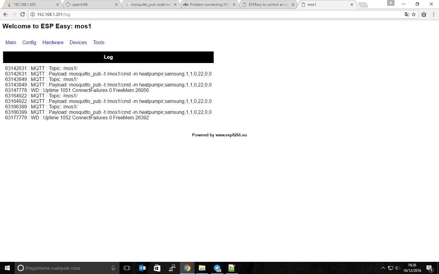

#6 Post by porfinfunciona » 18 Dec 2016, 19:30
63394177 : MQTT : Topic: /mos1/
63394177 : MQTT : Payload: mosquitto_pub -t /mos1/cmd -m heatpumpir,samsung,1,1,0,22,0,0
Sin título.jpg (163.22 KiB) Viewed 124867 times

Ah, we have misunderstood each other. The 'mosquitto_pub' is a command line tool to send out MQTT messages from the shell. So the topic should be '/mos1/cmd' and the payload should be like 'heatpumpir,samsung,1,1,0,22,0,0'.
Now your topic was '/mos1/' and the payload was 'mosquitto_pub -t /mos1/cmd -m heatpumpir,samsung,1,1,0,22,0,0'.

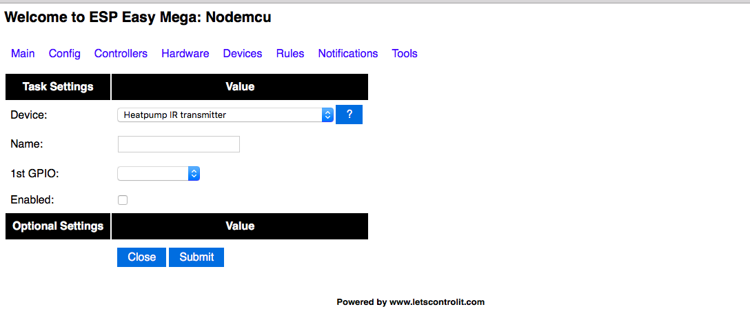

Hi again I manage (I think) to flash a Nodemcu with your code.
But I don't see the option to choose the manufactur. Skall it be so?
ToniA
Posts: 69
Joined: 26 Aug 2016, 20:37
Re: ESPEasy to control air conditioners / heat pumps
#50 Post by ToniA » 22 Apr 2017, 16:16
In ESPEasy you only need to configure the pin you connect the LED into (you can first try out with red/green/yellow/whatever color LED to see it's working).
The heatpump model is in the message, see the second message of this thread for an example. This works both with http and mqtt messages.
