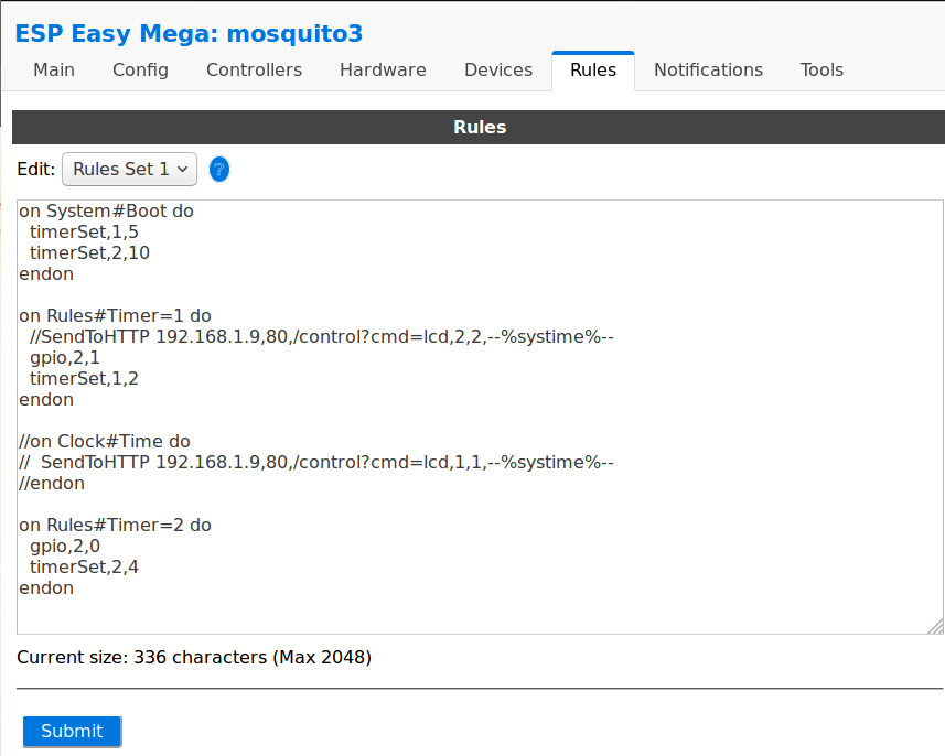

#21 Post by sentinel » 11 Feb 2018, 17:48
I think the rule is never triggered. I started 2 timers: When timer-1 expires, I switch the on-board LED on. When timer-2 expires, I switch it off. Nothing happens.
Re: SendToHTTP not working

#23 Post by sentinel » 11 Feb 2018, 18:06
here is a screenshot of my rules. Do you need another tab?
rules tab
rules tab
#24 Post by grovkillen » 11 Feb 2018, 20:16
Okay, that explains it. You cannot use timers like that. They will start tugging for that poor gpio 2. You need to do it like this.

#25 Post by sentinel » 11 Feb 2018, 20:58
This also doesn't work. My Rules are:
On System#Boot Do
 TimerSet,1, 2
EndOn
On Rules#Timer=1 Do
 Gpio,2,1
 TimerSet,2,4
EndOn
//on Clock#Time do
//  SendToHTTP 192.168.1.9,80,/control?cmd=lcd,1,1,--%systime%--
//endon
On Rules#Timer=2 Do
 Gpio,2,0
 TimerSet,1,2
EndOn

I think the timer starts but never expires?
I have also tried my code (the one in my screenshot) in a module running build 120 and it works ok.

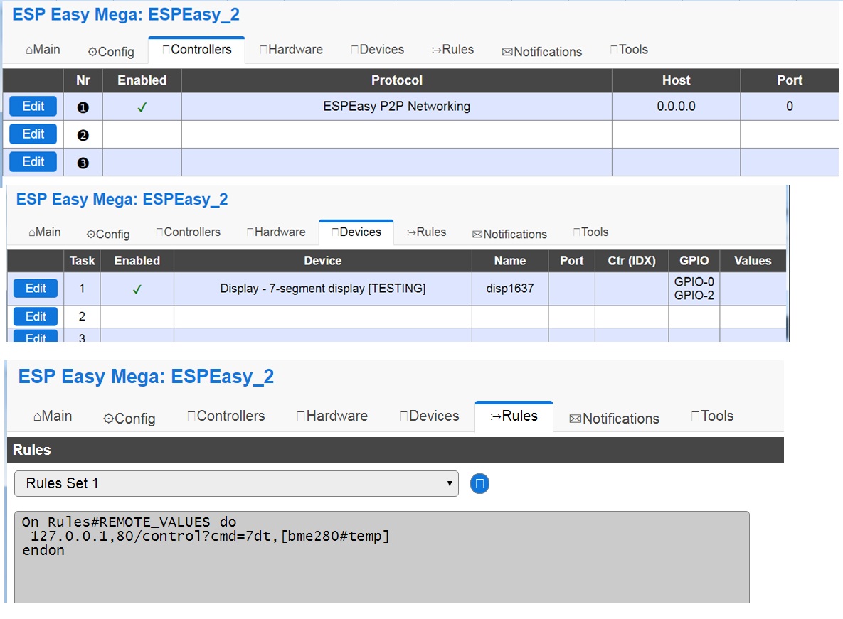

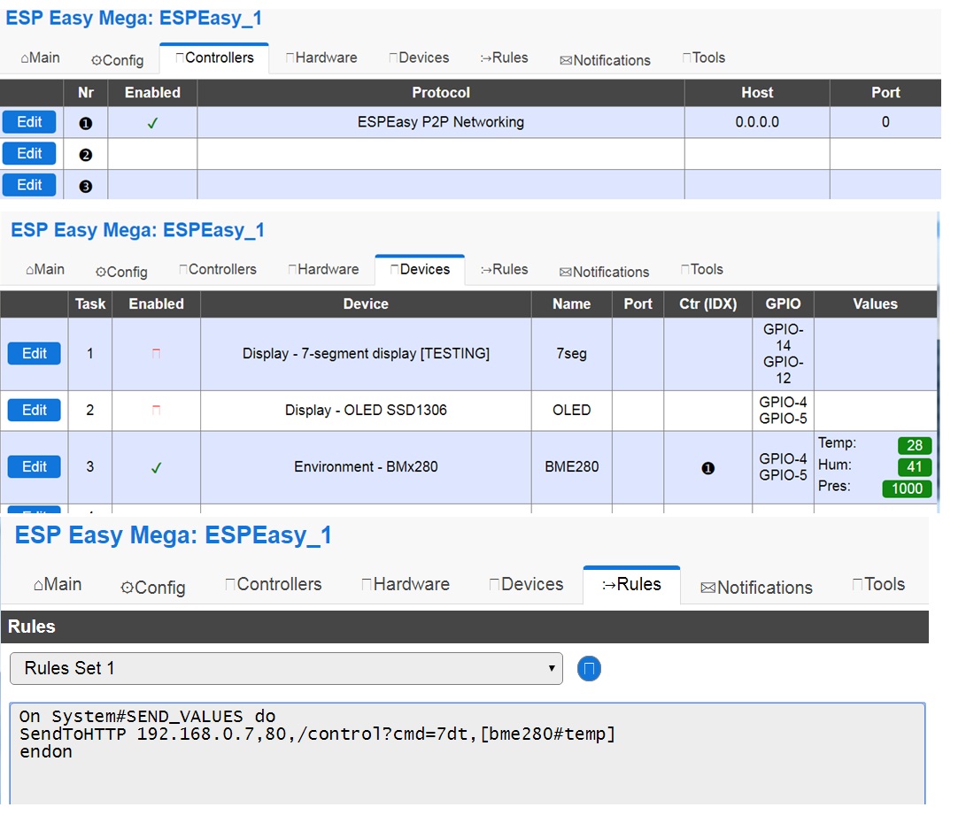

esp8266
Joined: 27 Sep 2018, 17:10
#48 Post by esp8266 » 27 Sep 2018, 18:18
Hello, all
first I want to thank the developers and everyone involved for this wonderful product - ESP Easy
with all due respect, the ESP Easy wiki lacks real, living examples, only syntax.
well, my hard:
1. esp8266 nodemcu, bme280 mega-20180822 (192.168.0.6)
2. esp8266 nodemcu, tm1637 mega-20180822 (192.168.0.7)
my task: to simplify (without mosquito and the like) transfer the temperature value from unit1 to the display of tm1637 unit2
my settings look at the attached screenshots
please correct the settings of the rules
Thank you
(I apologize for me the bad english)
The attachment ESPEASY_1.jpg is no longer available
esp8266
#49 Post by esp8266 » 27 Sep 2018, 18:22
2 attachment
#50 Post by grovkillen » 27 Sep 2018, 18:32
We are very much aware that the wiki is lacking in every aspect. We're working on a new GUI and integrated wiki which will be easier to maintain.
