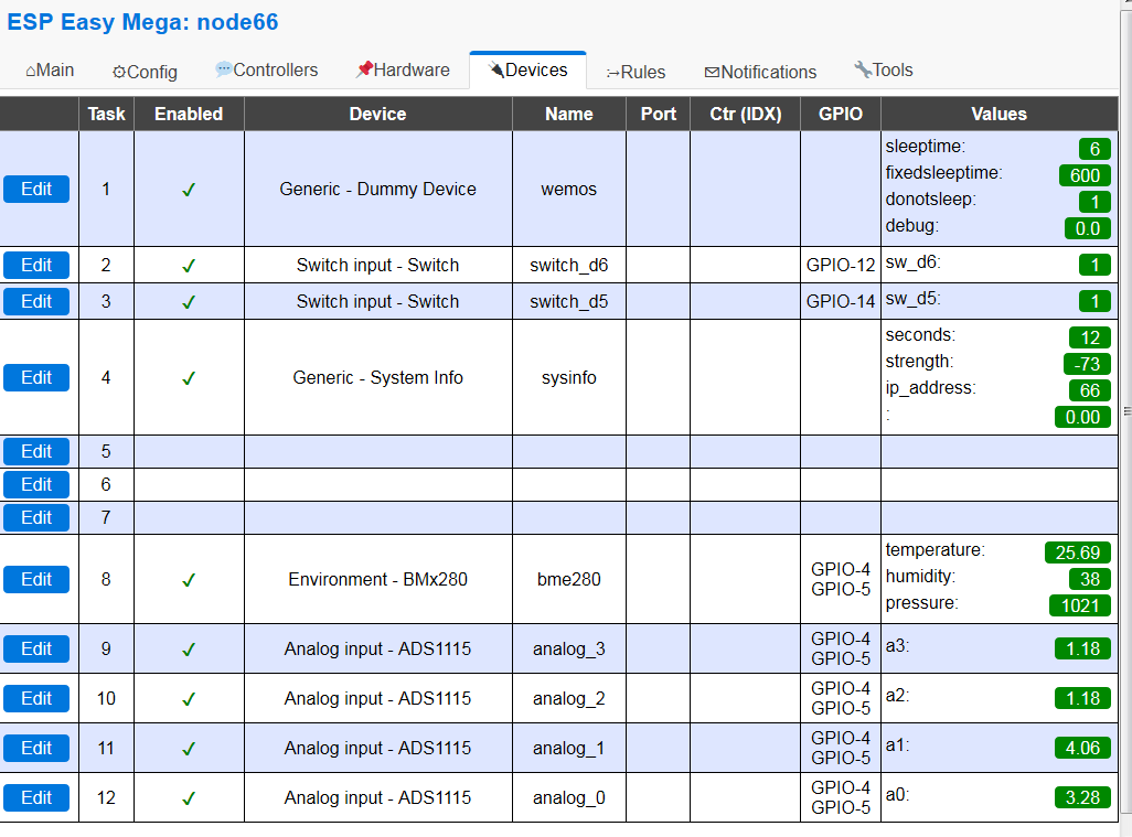

Here's a screenshot of the 'Devices' tab inside the Wemos.
At the moment we are using an ADS1115 (analog switch) to monitor and report the voltage of the solar panel, the voltage of the battery and the value of the +3V3 rail/pin.
We are also using a MQTT broker on the cloud (beebotte.com) as the student and I wanted to be able to monitor the readings at the weather station from home.
'SampleThenSleep' and 'doNotSleep' are event-commands sent from Node-RED to manipulate the operational mode of the Wemos.

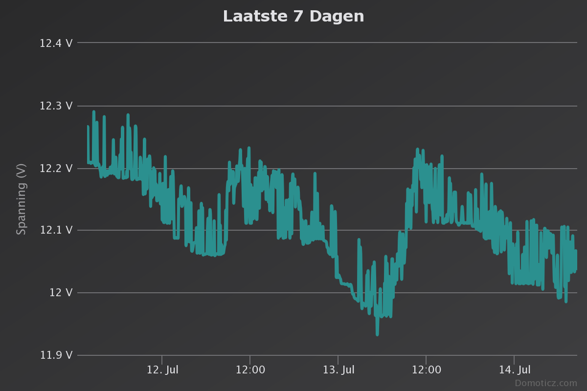

#28 Post by TD-er » 16 Jul 2020, 12:48
@wiki
What size and power has your solar module?
Apart from the less hours of sunlight in winter, there is also a temperature issue that will lower the battery voltage.
Voltage car battery during day/night
This is the voltage of my car battery during the day and night and the temperature difference is clearly attributing to the measured voltage.
On the 13th the recorded min and max. temp differ 15 degree C.
N.B. the spikes is something I'm also working on and is related to the effect of WiFi on the ADC of the ESP.

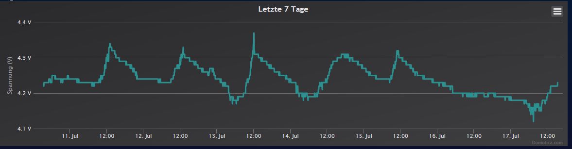

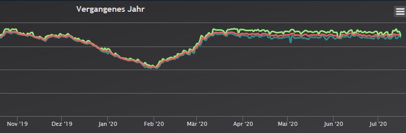

#29 Post by Wiki » 17 Jul 2020, 15:28
Details: Click
7-days of my weather stations battery voltage:
