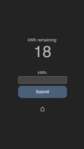

chromo23
Posts: 1007
Joined: 10 Sep 2020, 16:02
Location: germany
Re: How do i set a var# from the dashboard
#9 Post by chromo23 » 21 Oct 2021, 21:29
EDIT: You must name this file other than dashboard.esp because it won´t work.
Name the file dashboard.html or something with html
i had no problems running it here. i use the same build
edit: it should look like this (maybe in white. depending on your system colors ):
Bildschirmfoto 2021-10-21 um 21.37.53.png (21.49 KiB) Viewed 8672 times
#11 Post by chromo23 » 21 Oct 2021, 23:04
I have wemos d1 mini with a bme280 a relay and a display attached....
kwRem = myJson.Sensors[5].TaskValues[0].Value;
at this place in my setup is the sensors temperature value. thats why you see a 18 in the screenshot and thats why i turned up the heating :D
Does the page load?
if yes > is there a value?
when you don´t see a value please open the developer tools in your browser and look in the error/problems or log tab if there is an error message...
can you send your json output: yourespip/json and the values you entered in the code above....

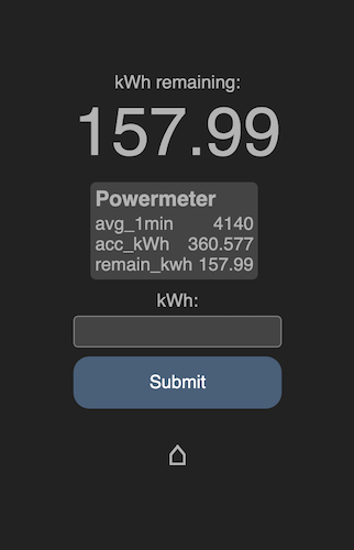

Zodiac69
Posts: 85
Joined: 13 Jun 2016, 17:20
#12 Post by Zodiac69 » 23 Oct 2021, 11:05
Hi chromo23
Yes, the page is loading now after i rename the file to x.html
I can see that the variable is getting set, %v1% is the value that i enter and set.
I can also see that in the "Devices" window, the value is displayed.

Hmmmm.. it should work. analyzed your json and the values are correct.... maybe a typo?
try it with this file... i already entered the right values and tested it:
kw.html.zip
(1.32 KiB) Downloaded 269 times

If you like this more:
Bildschirmfoto 2021-10-23 um 14.57.34.png (39.75 KiB) Viewed 8589 times
go for it:
kw2.html.zip
(2.86 KiB) Downloaded 321 times

#15 Post by Zodiac69 » 25 Oct 2021, 19:07
Hi chromo23
Thank you for your time and effort, it is working 100%
