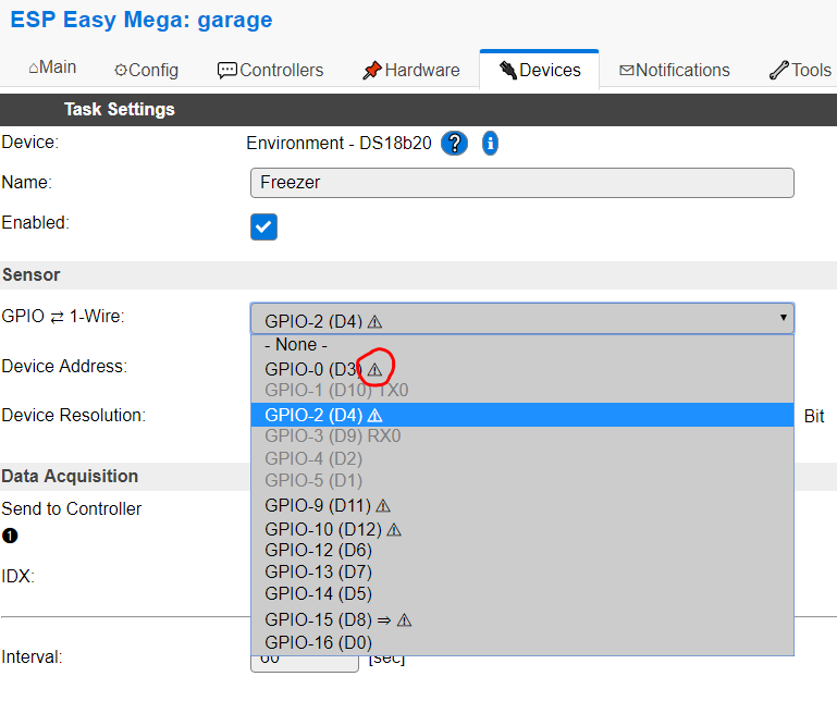

What's the exclamation point icon when selecting from the GPIO/1 Wire drop down menu when editing hardware? Pic attached to show what I mean. I can't find anything in the documentation.

The triangles are traditional caution icons. In other words, you MUST know what you are doing if you use those pins because it might be a bad idea for your application. For example: GPIO-0, GPIO-2 and GPIO-15 are boot mode pins. GPIO-9 and GPIO10 are reserved for DIO flash memory use. And so on.
Before using these cautionary pins, I strongly recommend that you use google to see how to work around ESP8266's pin restrictions.

Aah, yes of course. Makes perfect sense now. Thanks!
