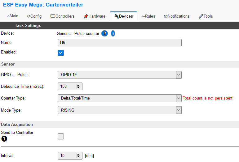

My settings are on all devices for the flow sensors are:
Flowsensor Settings
Flowsensor Settings
2019-05-22 20_51_17-Gartenverteiler.png (17.82 KiB) Viewed 16261 times

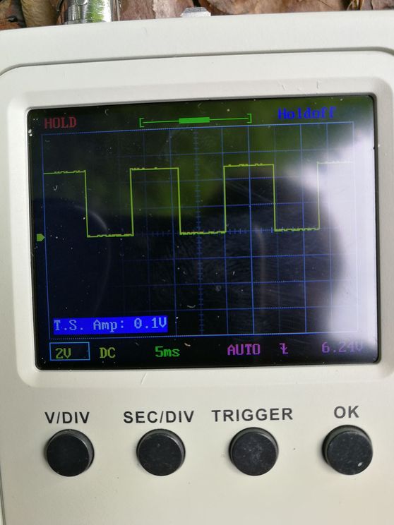

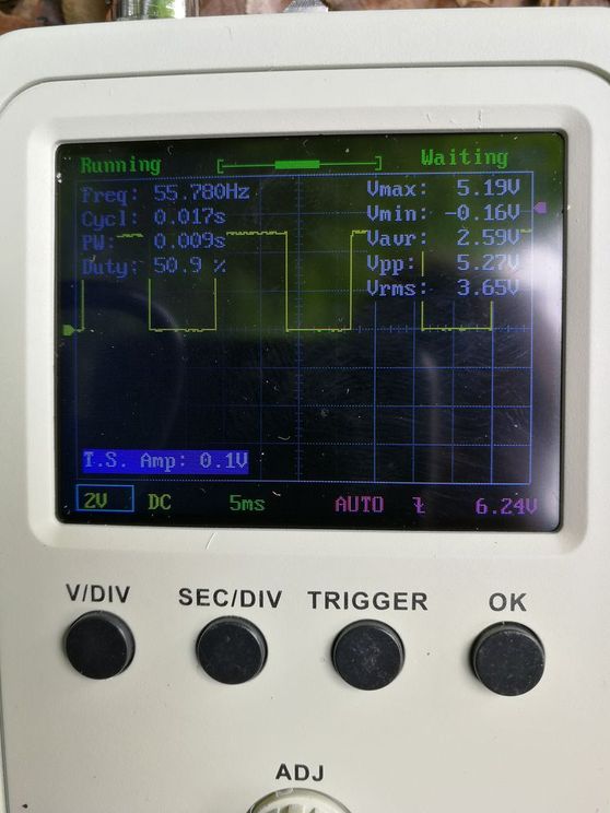

I think the signals are clean enough to do an evaluation. The flow sensors are connected to a separate power supply (5V) and are connected to the ESP via a step-down device (to 3.3V). In addition, capacitors (100nF) and pull-up resistors (10k) have been considered. I bought a very cheap oscilloscope (20 €) to look at the signals from the sensors.
