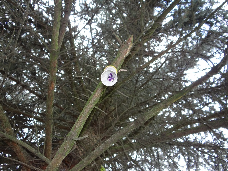

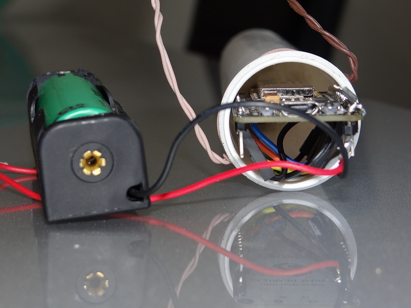

I'm using nodemcu with battery 18650 (about 3000mAh). It's running on Espeasy and wake up every 5 minutes sending voltage and data from BME280 to domoticz. I only unsoldered ground pin from CH340 and removed AMS1117. Battery is connected directly to 3,3V with MCP1703 LDO voltage regulator. It works without any problems about 6-7 weeks on battery witch is very easy to replace it. There is no protection board for battery, but you can check the voltage in domoticz and if it's under 3,3V just replace battery.
- DSC02059.JPG (129.88 KiB) Viewed 54106 times
- DSC02058a.jpg (223.75 KiB) Viewed 54106 times
- DSC02056.JPG (284.54 KiB) Viewed 54106 times
- DSC02055.JPG (331.17 KiB) Viewed 54106 times

Nice one! Thanks for sharingligeza wrote: ↑07 Jul 2018, 21:15 I'm using nodemcu with battery 18650 (about 3000mAh). It's running on Espeasy and wake up every 5 minutes sending voltage and data from BME280 to domoticz. I only unsoldered ground pin from CH340 and removed AMS1117. Battery is connected directly to 3,3V with MCP1703 LDO voltage regulator. It works without any problems about 6-7 weeks on battery witch is very easy to replace it. There is no protection board for battery, but you can check the voltage in domoticz and if it's under 3,3V just replace battery.

I like your design.ligeza wrote: ↑07 Jul 2018, 21:15 I'm using nodemcu with battery 18650 (about 3000mAh). It's running on Espeasy and wake up every 5 minutes sending voltage and data from BME280 to domoticz. I only unsoldered ground pin from CH340 and removed AMS1117. Battery is connected directly to 3,3V with MCP1703 LDO voltage regulator. It works without any problems about 6-7 weeks on battery witch is very easy to replace it. There is no protection board for battery, but you can check the voltage in domoticz and if it's under 3,3V just replace battery.
Are you able to show us a bit more of a close up of the base of the unit around the BME280?
How long have you had this working outside? I would be a bit worried about corrosion of the BME280.
Are you using this over grass or something similar?
Have you done any tests to compare to more professional sensors?

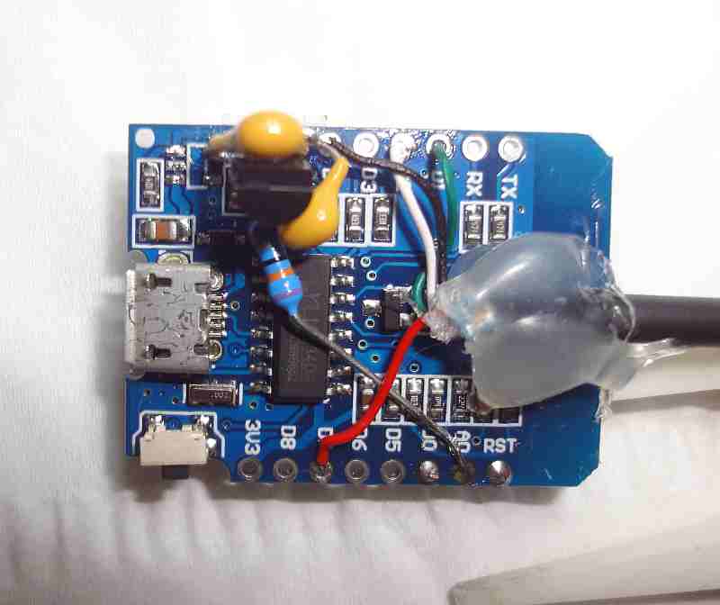

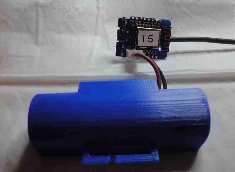

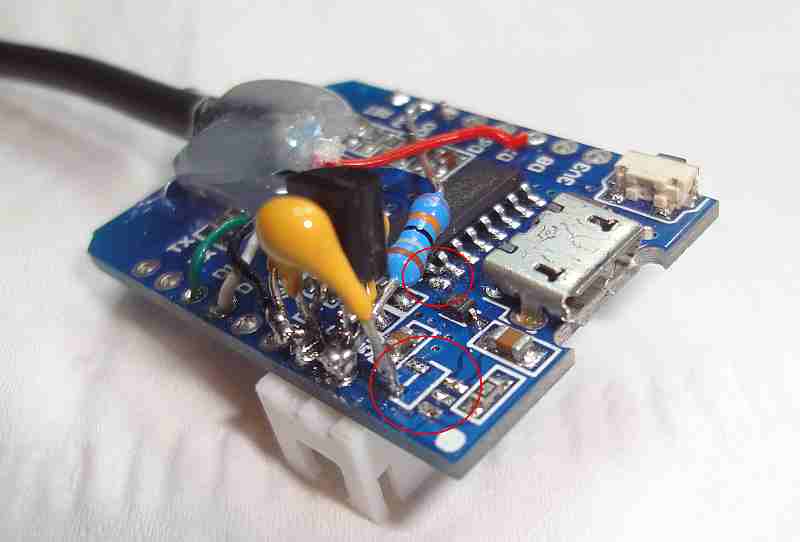

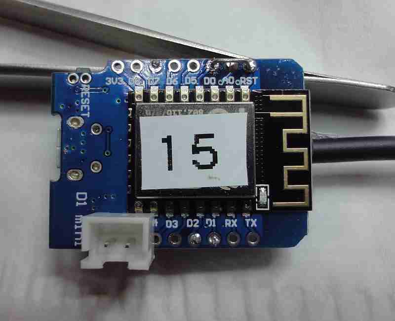

in the last weeks I tried out some hardware modifications to minimize the power consumption of a Wemos D1 mini (clone from China). At least I was able to reduce the power consumption of the breakout board down to 70µA during deep sleep. All measurements I did refer to a 5V power supply.
I started with the original board equipped with a BMP280 with a running current of 81 mA, a deep sleep current of 6.1 mA. The BMP280 was connected to the 3.3V outlet of the board.
At first I desoldered the onboard voltage regulator and added a HT7333 directly to the board. The output pin of the HT7333 I soldered to the 3.3V connection point of the old regulator (be careful, its easy to rip off the connection point off the board), ground and input pin I soldered to the ground/5V pins of the board. At the same time I soldered a Molex connector from the upper side of the board to the 5V and groung connections of the board.
I got current peeks up to 350 mA being pulled out of the power source during wakeup of the esp. By adding two capacitors of 10µF the peek is avoided. Replacing the voltage regulator reduced the running current by 1.5-2 mA, the current during deep sleep aroung 1 mA.
Second I desoldered the ground pin of the onboard CH340. This reduced the running current down to 69-70 mA, the deep sleep current by 5 mA down to 150 µA. Gotcha, Thanks to ligeza for these tipps.
The modifications in color: The resistor shown in the picture is a 180k to get the voltage of the lateron connected battery. Last step was connecting the BMP280 power input to a GPIO pin of the board, ESPEasy configuered to pull up this pin. The from BMP280 needed few µAmps can be feeded by a GPIO easily. Now the board pulls 70 mA during awake time, 70 µA during deep sleep. Setting the board to a fixed IP reduces the time the board has to be connected to the AP significantly.
Now the board is connected by the Molex connector to a 3D-printed battery pack, including a 3000mAh 18650 Liion battery and a battery protection/charging circuit. I expect a running time of at least 90 days with one battery, awaking the ESP every 15 minutes.
- Wemos modded1.jpg (22.21 KiB) Viewed 53506 times

as you can probably see on the pictures, my soldering skills are not the best either. But its possible. At least desoldering the CH340 ground pin is it worth to be done.

Here's a link to a write-up of a solar-powered weather station one of my IoT students tackled last year (2019).
Didn't modify the (power routing on the) Wemos D1 Mini as didn't know about the CH340 issues and
I doubt if our soldering skills would have been good enough.
Ran the weather station with no problems at all for a number of weeks during summer-2019 here in the UK.
