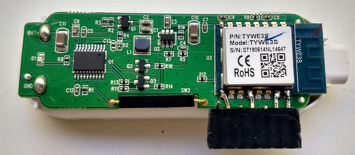

The doorsensor has also been migrated to a SmartNode with custom firmware.

FanOfHue wrote: 20 Aug 2019, 15:02 The doorsensor has also been migrated to a SmartNode with custom firmware.
Can you told use how to flash the firmware? Open the device, soldering wires etc, with a few pictures should be nice. :D

I seems that you can use a project named Tuya-Convert to replace the firmware OTA way, but then you would need an RPI-3. I don't have one, so i took the hardware hack road:
Not really difficult to do. A siimple header gives access to RX/TX and GPIO-0 and that's all you need. I used Arduino IDE to upload the firmware in the same way as with other ESP8266 modules. Tuya modules are also very well documented. Just google for TYWE3S.
When initial upload is done, you can remove the header because future updates will be done with standard ESP8266 OTA.

I found some more info and a tear-down of these devices on a the German forum mikrocontroller.net. It seams that the OTA update with Tuya-convert has been disabled by Tuya with a new firmware and these devices would have the new update. Also some of these devices don't have the esp8266 or esp8285 chip onboard that would enable us to change the firmware to espeasy. Although some items do have a chip with almost the same pinout as the esp-12f so a switch could be made.
What I have not found yet is how we would configure these devices after flashing them with espeasy. What pins are connected where and how do we configure deepsleep to get a sustainable battery life.

FanOfHue wrote: 20 Aug 2019, 20:18 IA siimple header gives access to RX/TX and GPIO-0 and that's all you need.
And of course 3v3 and GND. Can you put the chip in flash mode by connecting GPIO-0 to GND?

Chip/Module used:
Switch Plug ESP8285-TYWE2S
Door Sensor ESP8266-TYWE3S
PIR Sensor ESP8266-TYWE3S
Hand Remote RTL8710BN-WR3
Sirene RTL8710BN-WR3
Led Strip ESP8266-TYWE3L
At least the ESP editions can be flashed with ESP Easy or similar stuff. I'm not aware of any custom firmware for the RTL modules.

Tecumseh wrote: 02 Sep 2019, 23:26 I found some more info and a tear-down of these devices on a the German forum mikrocontroller.net. It seams that the OTA update with Tuya-convert has been disabled by Tuya with a new firmware and these devices would have the new update. Also some of these devices don't have the esp8266 or esp8285 chip onboard that would enable us to change the firmware to espeasy. Although some items do have a chip with almost the same pinout as the esp-12f so a switch could be made.
Switch Plug is like this:
gpio 4 is LED (0 = on)
gpio 12 is relay (1 = on)
gpio 14 is switch (0 = pressed)
The battery operated devices do not need deepsleep config. The second MCU used on these devices controls the power to the ESP. Without trigger, the ESP is just powered off. When triggered, ESP will be powered on.

AFAIK, the door sensor has no GPIO attached to any hardware. Only RX/TX is connected to the other MCU.
I'm working on a serial plugin for ESPCoreRules to read the status from the other MCU and instruct it to power off again.
I have seen an existing plugin for ESP Easy to controll Tuya MCU that might be enhanced to support the Door Sensor.

I also stumbled across the LSC stuff in the action store and decided to give it a try.
In the last couple of days, I have been reverse engineering the door sensor.
My conclusions sofar:
I have removed the WiFi module so I could draw up some course schematic, and the Wifi module only uses its serial connections (RXD0, TXD0).
The reed contact (door sensor) is directly connected to the MCU, which powers on the Wifi module when its activated.
The Wifi module needs to initiate the communication, after some data exchange the MCU will sent the contact state to the Wifi module and the cloud.
I also logged the communication and unfortunately it uses a dialect of the Tuya protocol (see https://images.tuyacn.com/smart/aircon ... a-MCU.pdf ).
The MCU on the door sensor board uses some slightly different command codes than the standard.
The devices functions commands, listed as 0x06 and 0x07 in the Tuya document seem to be merged and have replace command 0x05.
I also checked the Tasmota Tuya protocol support in the Tuya dimmer module, and this does seem to support the switch functionality, but unfortunately it can not support the LSC Door sensor, as it uses the wrong command to communicate it :cry: It however should allow enough communication to allow the MCU to send the contact status to tasmota.
The original firmware is however quite fast in sending data to the cloud, as the total WiFi module power on time is approx 5.6 seconds.
In this time frame the module connects to the Wifi network, and sends the data to the cloud. It then takes several seconds more before a open/close notification is received on the app / phone.
The door sensor uses approx 5.8 - 6 µA when its in idle (no communication).
When the MCU wakes up, the current increases to 580-600 µA (Wifi module was removed from the board)
With the Wifi module I noticed current of 88 mA+ on my PSU (did not accurately measure this yet).
I expect that running Tasmota on the door sensor will reduce battery life as I think that Tasmota will require much more time than the 5.6 seconds to send the data.

I also reverse engineered the serial protocol to find out that it's not really following protocol as documented.
Taken from my plugin comments:
* tuyaSend <cmd>,<len>,<value> Send a serial message to the 'tuya' MCU as used on LSC Smart Connect PIR and Doorsensors
* Still debugging. Official documentation does not seem to match with commands used for PIR/Doorsensor
* tuyasend 1,0,0 Get device info from MCU
* tuyasend 2,1,0 fast blink LED
* tuyasend 2,1,1 start AP/config mode, power stays on, slow blink LED
* tuyasend 2,1,2 LED blink off
* tuyasend 2,1,3 ??
* tuyasend 2,1,4 Get device status from MCU
The main trick is to send command 2 with option 4. The MCU will send the status and will power off shortly after.

FanOfHue
Posts: 96
Joined: 06 Oct 2018, 10:08
Re: New hackable ESP gadgets in local budget store "action" !!!
#42 Post by FanOfHue » 26 Sep 2019, 17:33
jme wrote: 26 Sep 2019, 08:41 Hi,
I just bought a door sensor and a pir sensor.
Could you give us some more detailled info how do you flash it, with wich firmware ?
Can we integrate it with Domoticz ?
Thx
I used the hardware way, using a header (see picture in earlier post). Boot with GPIO0 low to get it into flash mode. This is all standard and must already be documented in great detail all over the internet.
I'm using it with Domoticz. But in my home all sensors are using the messagebus protocol, so the sensor does not directly communicate with Domoticz. It keeps the sensor firmware very lean and mean. I use WindowsRules to catch all messagebus events and that will update Domoticz and the Hue Bridge.

ESPNOW was a small but useful side step to improve the firmware for use on the LSC devices.
For all that have asked for more detailed timing specifics, i hooked up a logic analyzer to get some accurate timings.
Global graph, edge triggered on the reed contact, checking VCC power line and serial communications:
As mentioned, the doorsensor needs or just takes 500 mSeconds before power-up the ESP module. This seems unavoidable.
From there we see three phases, zoom in to the active part:
Bootloader part is fixed to 64 mSeconds.
Init part is currently 78 mSeconds, maybe there's something to gain if we look more into code detail
Communications is 144 mSeconds. In fact only the last one provides the real status, but it seems that we need all to make the "setup" button logic work.
This needs more testing, but for now i'm happy with the results.
The ESP is active for only 300 milliSeconds.
