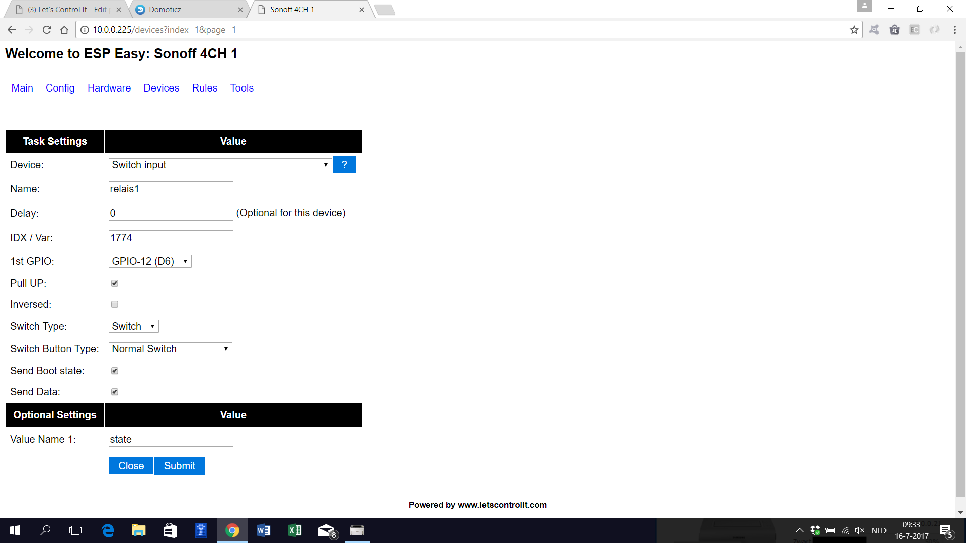

And a screenshot of one of the four devices:
Screenshot of one of the buttons:
Schermafdruk 2017-07-16 20.15.01.png (96.39 KiB) Viewed 18291 times
Schermafdruk 2017-07-16 09.33.15.png (97.07 KiB) Viewed 18335 times

#3 Post by manjh » 16 Jul 2017, 09:37
LisaM wrote: 15 Jul 2017, 21:09 Rules + devices screenshot please!!!
Done.
