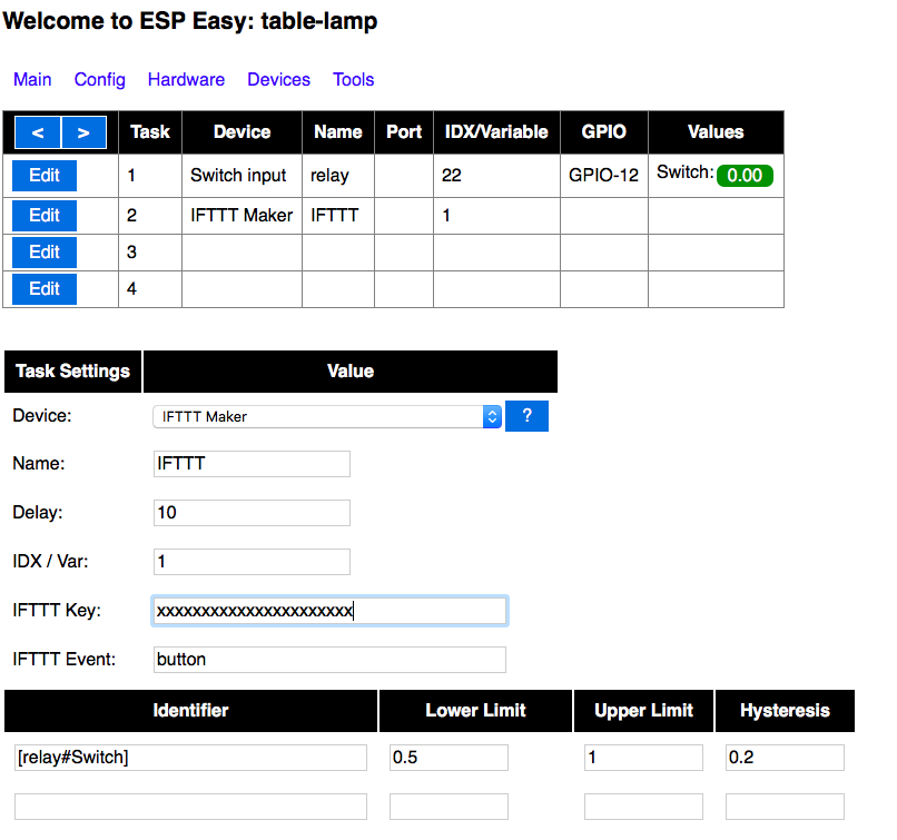

The configuration screen for IFTTTMaker looks like this:
You will need to provide your IFTTT Key and the IFTTT Event name as the two main parameters. The IFTTT Key is a unique string which identifies you to IFTTT and the Event Name is the name of the trigger which you will send to IFTTT.
‘IFTTTMaker’ can monitor up to 4 sensor values – the example shown above only monitors two. The standard parameter Delay specifies how often the values are checked.
The first field is the name of the sensor value in the form [%tskname%#%valname%]. The second and third parameters are the lower and upper limits and the last is the hysteresis. Thus, in the case of the examples above, a single trigger event called “ESP01” will be sent to IFTTT when [DHT22#Temperature] goes above 25 degrees. Once the trigger has been sent, so long as the temperature remains above 23 (Upper Limit – Hysteresis) no further triggers will be sent. If the temperature drops below 23 and then again rises above 25 then another trigger will be sent.
The IFTTT interface allows three data values to be sent to IFTTT along with the trigger. I have specified these as:
Value1 - the Identifier such as [DHT22#Temperature]
Value2 - the current value of the temperature
Value3 - a concatenation of the Lower and Upper Limits in the form [LL/UL].

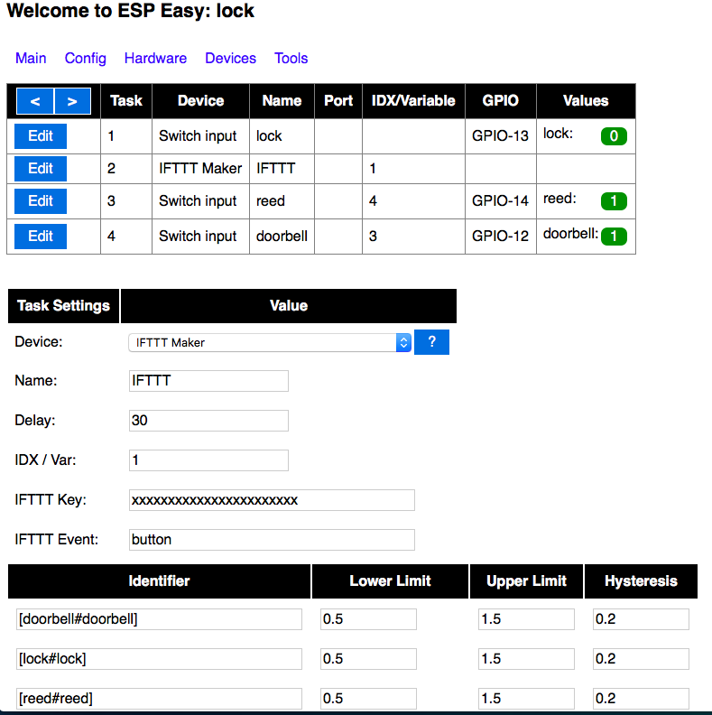

how to get device identifier for device doorbell ?

I suppose the value of [doorbell#switch] changes from 1 to 0 when the doorbell button is pressed?
If that is the case then you could set the lower limit to 0.5 and the upper limit to 1.5 with a hysteresis of 0.2.
This would send a trigger event called 'button' to IFTTT.com each time your doorbell button is pressed.
You must log onto your IFTTT account and make up a 'recipe' to tell IFTTT what you would like it to do when it receives that trigger event.

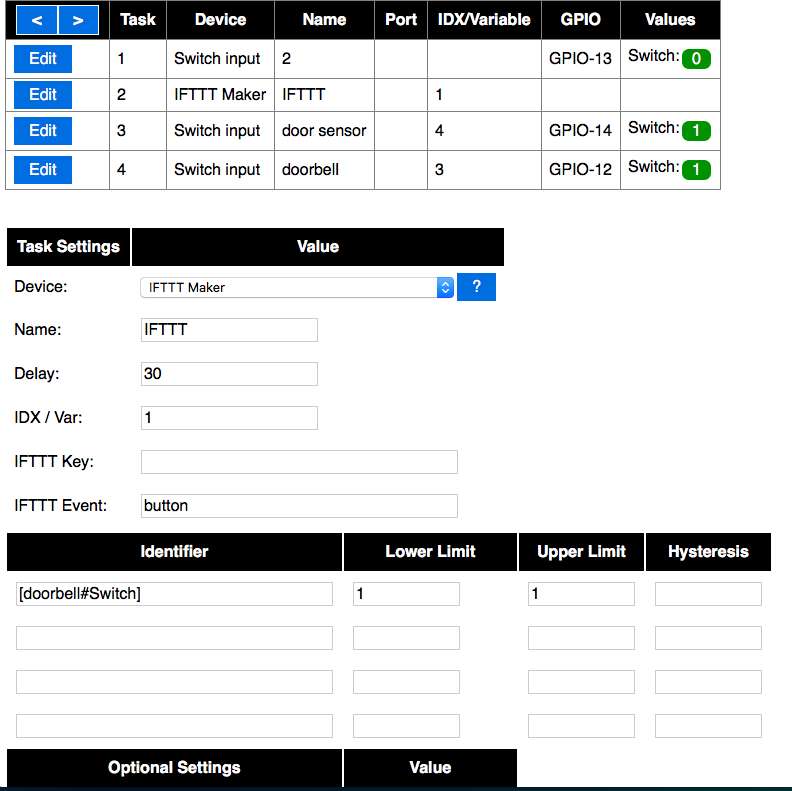

i am unable to make it work with this esp device controlling my door lock , doorbell and reed sensor

You are only checking the value every 30 seconds - it's quite possible that you are simply missing the event.

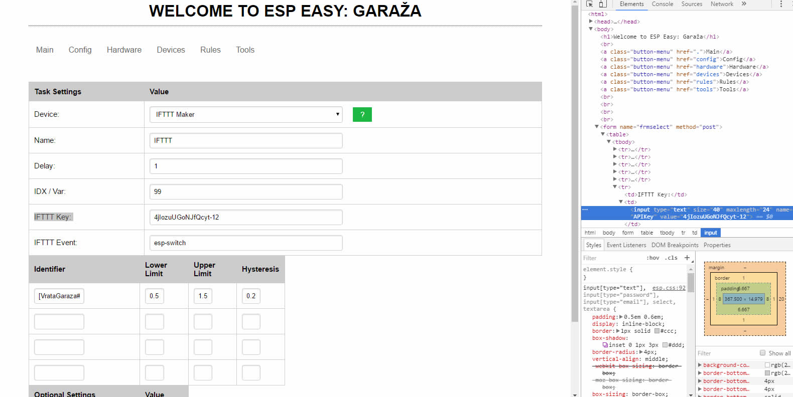

For everyone running into the same problems as doxikus. Just open the _P209_IFTTTMaker.ino and change the lines
string += F("<TR><TD>IFTTT Key:<TD> <input type='text' size='40' maxlength='24' name='APIKey' value='");
strncpy(Template[0].Ident, WebServer.arg("APIKey").c_str(), 24);
Just change the 24 into something so the key fits.
