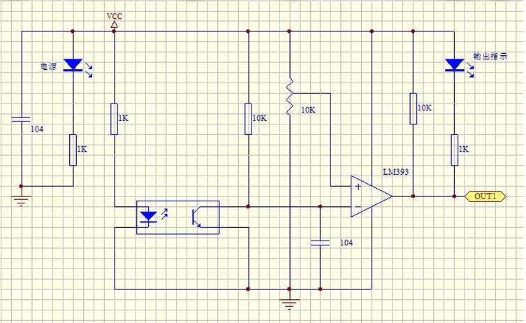

And you got the wrong picture. I am using this here:

well, it's basically the same circuit, just your one has a trim resistor - which is partly useless as it can be driven fully against Vcc and GND.
The comparator will never do anything from these positions down to about 15..20% of the turn.
Anyways.. I have to say these breakoutboards have not the best circuit design. i would have given that additional capacitor
and two more resistors making it into a precisely working tool. Not much of cost at all.

#9 Post by Shardan » 08 Dec 2016, 15:47
there is a slight difference between the schematic I found on the web and the one you showed:
The inputs of the comparator are swapped. As you said the signal is "high" if the sensor gets a
white spot it's your schematic that is correct in this case. "High" says the "Out" LED is off!

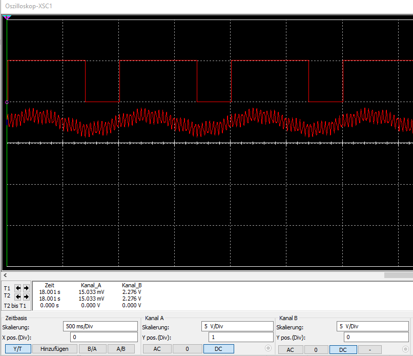

Did not work well for me in MultiSim ...
I did some tests and this could work fine ... See pictures.
But I have to figure out what voltage output comes from the IR-reflection sensor.
Will measure that and put it into the simulation ...
regards
Dominik

#11 Post by moelski » 08 Dec 2016, 20:57
Also works in very noisy environment ...

And even here i would put a capacitor in parallel to R3 to keep the reference voltage clean.
Seems to work nicely in noisy environment as shown from the diagrams.
