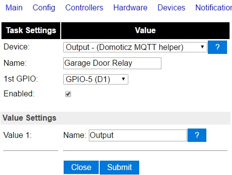

I seemed to be missing the "IDX" field in my setup. I have seen other screenshots with the IDX field. Am I doing something wrong?

Re: Missing IDX on Output - Domoticz MQTT Helper
What controller do you have activated?
The controller I have enabled and working is "Domoticz MQTT".
In case anyone runs into this issue:
I had a bit more time to look into this...
I was using the latest source on mega. The issue appears to stem from the changes made here https://github.com/letscontrolit/ESPEas ... 7fec799e52 which requires Device[deviceCount].SendDataOption to be true to show the IDX field.
I recompiled with that option to true on P029 and now the field appears and all is good.
Also, noticed the following issue. I was attempting to run this from Domoticz MQTT and it was not receiving MQTT messages. I think the messages Domoticz publishes on domoticz/out is greater than 256 bytes, so it was being rejected. I ended up having to change the limit to 512 (in controller.ino & pubsubclient.h) and it appears to be working, not sure how this will impact performance etc..
