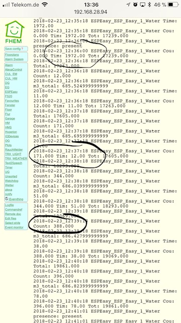

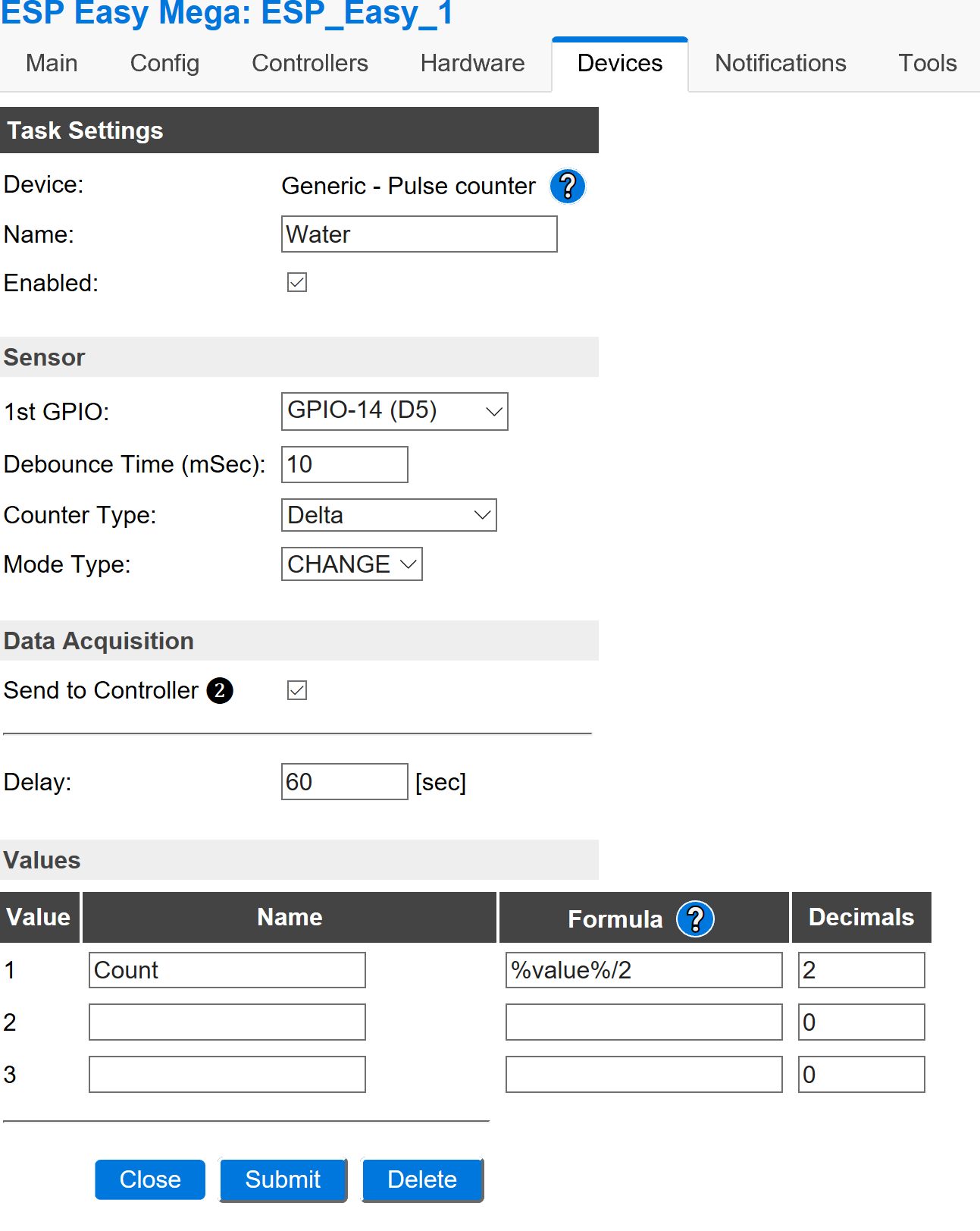

I am using the mega-20180214 build and I experience a problem with the generic pulse counter seems to run into an overflow of the time variable which than seems to set the counter to an irregular high value.( I guess)
In detail:
Before the time variable is stepping over from high value to start by 0 again, the counter variable show values of >100, normal is max 15 for about an minute. Than everything works as good as before. I have seen that several times. Please compare with the log below.
I am using fhem house automation and so I am able to correct this issue in fhem but thats inconvienient...
water pulse count error.jpg (104.49 KiB) Viewed 5901 times
esp easy pulse counter setting.PNG (101.75 KiB) Viewed 5903 times

part of my logfile at that time....I have seen it many times /repeatable in my logs, now I catch the high counters in fhem and only log the good values....
2018-02-23_12:29:18 ESPEasy_ESP_Easy_1_Water Cou: 0.000 Tim: 243692.00 Tot: 17234.000
2018-02-23_12:30:18 ESPEasy_ESP_Easy_1_Water Total: 17235.000
2018-02-23_12:30:18 ESPEasy_ESP_Easy_1_Water Count: 0.500
2018-02-23_12:30:18 ESPEasy_ESP_Easy_1_Water m3_total: 685.510999999999
2018-02-23_12:30:18 ESPEasy_ESP_Easy_1_Water Time: 3848987.00
2018-02-23_12:30:18 ESPEasy_ESP_Easy_1_Water Cou: 0.500 Tim: 3848987.00 Tot: 17235.000
2018-02-23_12:30:56 ESPEasy_ESP_Easy_1_Water presence: present
2018-02-23_12:30:56 ESPEasy_ESP_Easy_1_Water Cou: 0.500 Tim: 3848987.00 Tot: 17235.000
2018-02-23_12:31:18 ESPEasy_ESP_Easy_1_Water Total: 17239.000
2018-02-23_12:31:18 ESPEasy_ESP_Easy_1_Water Count: 2.000
2018-02-23_12:31:18 ESPEasy_ESP_Easy_1_Water m3_total: 685.512999999999
2018-02-23_12:31:18 ESPEasy_ESP_Easy_1_Water Time: 1972.00
2018-02-23_12:31:18 ESPEasy_ESP_Easy_1_Water Cou: 2.000 Tim: 1972.00 Tot: 17239.000
2018-02-23_12:32:18 ESPEasy_ESP_Easy_1_Water Total: 17239.000
2018-02-23_12:32:18 ESPEasy_ESP_Easy_1_Water Count: 0.000
2018-02-23_12:32:18 ESPEasy_ESP_Easy_1_Water m3_total: 685.512999999999
2018-02-23_12:32:18 ESPEasy_ESP_Easy_1_Water Time: 1972.00
2018-02-23_12:32:18 ESPEasy_ESP_Easy_1_Water Cou: 0.000 Tim: 1972.00 Tot: 17239.000
2018-02-23_12:33:18 ESPEasy_ESP_Easy_1_Water Total: 17239.000
2018-02-23_12:33:18 ESPEasy_ESP_Easy_1_Water Count: 0.000
2018-02-23_12:33:18 ESPEasy_ESP_Easy_1_Water m3_total: 685.512999999999
2018-02-23_12:33:18 ESPEasy_ESP_Easy_1_Water Time: 1972.00
2018-02-23_12:33:18 ESPEasy_ESP_Easy_1_Water Cou: 0.000 Tim: 1972.00 Tot: 17239.000
2018-02-23_12:34:18 ESPEasy_ESP_Easy_1_Water Total: 17239.000
2018-02-23_12:34:18 ESPEasy_ESP_Easy_1_Water Count: 0.000
2018-02-23_12:34:18 ESPEasy_ESP_Easy_1_Water m3_total: 685.512999999999
2018-02-23_12:34:18 ESPEasy_ESP_Easy_1_Water Time: 1972.00
2018-02-23_12:34:18 ESPEasy_ESP_Easy_1_Water Cou: 0.000 Tim: 1972.00 Tot: 17239.000
2018-02-23_12:35:18 ESPEasy_ESP_Easy_1_Water Total: 17239.000
2018-02-23_12:35:18 ESPEasy_ESP_Easy_1_Water Count: 0.000
2018-02-23_12:35:18 ESPEasy_ESP_Easy_1_Water m3_total: 685.512999999999
2018-02-23_12:35:18 ESPEasy_ESP_Easy_1_Water Time: 1972.00
2018-02-23_12:35:18 ESPEasy_ESP_Easy_1_Water Cou: 0.000 Tim: 1972.00 Tot: 17239.000
2018-02-23_12:36:00 ESPEasy_ESP_Easy_1_Water presence: present
2018-02-23_12:36:00 ESPEasy_ESP_Easy_1_Water Cou: 0.000 Tim: 1972.00 Tot: 17239.000
2018-02-23_12:36:18 ESPEasy_ESP_Easy_1_Water Total: 17263.000
2018-02-23_12:36:18 ESPEasy_ESP_Easy_1_Water Count: 12.000
2018-02-23_12:36:18 ESPEasy_ESP_Easy_1_Water m3_total: 685.524999999999
2018-02-23_12:36:18 ESPEasy_ESP_Easy_1_Water Time: 11.00
2018-02-23_12:36:18 ESPEasy_ESP_Easy_1_Water Cou: 12.000 Tim: 11.00 Tot: 17263.000
2018-02-23_12:37:18 ESPEasy_ESP_Easy_1_Water Total: 17605.000
2018-02-23_12:37:18 ESPEasy_ESP_Easy_1_Water Count: 171.000
2018-02-23_12:37:18 ESPEasy_ESP_Easy_1_Water m3_total: 685.695999999999
2018-02-23_12:37:18 ESPEasy_ESP_Easy_1_Water Time: 12.00
2018-02-23_12:37:18 ESPEasy_ESP_Easy_1_Water Cou: 171.000 Tim: 12.00 Tot: 17605.000
2018-02-23_12:38:18 ESPEasy_ESP_Easy_1_Water Total: 18293.000
2018-02-23_12:38:18 ESPEasy_ESP_Easy_1_Water Count: 344.000
2018-02-23_12:38:18 ESPEasy_ESP_Easy_1_Water m3_total: 686.039999999999
2018-02-23_12:38:18 ESPEasy_ESP_Easy_1_Water Time: 51.00
2018-02-23_12:38:18 ESPEasy_ESP_Easy_1_Water Cou: 344.000 Tim: 51.00 Tot: 18293.000
2018-02-23_12:39:18 ESPEasy_ESP_Easy_1_Water Total: 19069.000
2018-02-23_12:39:18 ESPEasy_ESP_Easy_1_Water Count: 388.000
2018-02-23_12:39:18 ESPEasy_ESP_Easy_1_Water m3_total: 686.427999999999
2018-02-23_12:39:18 ESPEasy_ESP_Easy_1_Water Time: 38.00
2018-02-23_12:39:18 ESPEasy_ESP_Easy_1_Water Cou: 388.000 Tim: 38.00 Tot: 19069.000
2018-02-23_12:40:18 ESPEasy_ESP_Easy_1_Water Total: 19861.000
2018-02-23_12:40:18 ESPEasy_ESP_Easy_1_Water Count: 396.000
2018-02-23_12:40:18 ESPEasy_ESP_Easy_1_Water m3_total: 686.823999999999
2018-02-23_12:40:18 ESPEasy_ESP_Easy_1_Water Time: 78.00
2018-02-23_12:40:18 ESPEasy_ESP_Easy_1_Water Cou: 396.000 Tim: 78.00 Tot: 19861.000
2018-02-23_12:41:01 ESPEasy_ESP_Easy_1_Water presence: present
2018-02-23_12:41:01 ESPEasy_ESP_Easy_1_Water Cou: 396.000 Tim: 78.00 Tot: 19861.000
2018-02-23_12:41:18 ESPEasy_ESP_Easy_1_Water Total: 20125.000
2018-02-23_12:41:18 ESPEasy_ESP_Easy_1_Water Count: 132.000
2018-02-23_12:41:18 ESPEasy_ESP_Easy_1_Water m3_total: 686.955999999999
2018-02-23_12:41:18 ESPEasy_ESP_Easy_1_Water Time: 5713.00
2018-02-23_12:41:18 ESPEasy_ESP_Easy_1_Water Cou: 132.000 Tim: 5713.00 Tot: 20125.000
2018-02-23_12:42:18 ESPEasy_ESP_Easy_1_Water Total: 20125.000
2018-02-23_12:42:18 ESPEasy_ESP_Easy_1_Water Count: 0.000
2018-02-23_12:42:18 ESPEasy_ESP_Easy_1_Water m3_total: 686.955999999999
2018-02-23_12:42:18 ESPEasy_ESP_Easy_1_Water Time: 5713.00
2018-02-23_12:42:18 ESPEasy_ESP_Easy_1_Water Cou: 0.000 Tim: 5713.00 Tot: 20125.000
2018-02-23_12:43:18 ESPEasy_ESP_Easy_1_Water Total: 20125.000
2018-02-23_12:43:18 ESPEasy_ESP_Easy_1_Water Count: 0.000
2018-02-23_12:43:18 ESPEasy_ESP_Easy_1_Water m3_total: 686.955999999999
2018-02-23_12:43:18 ESPEasy_ESP_Easy_1_Water Time: 5713.00
2018-02-23_12:43:18 ESPEasy_ESP_Easy_1_Water Cou: 0.000 Tim: 5713.00 Tot: 20125.000
2018-02-23_12:44:18 ESPEasy_ESP_Easy_1_Water Total: 20125.000
2018-02-23_12:44:18 ESPEasy_ESP_Easy_1_Water Count: 0.000
2018-02-23_12:44:18 ESPEasy_ESP_Easy_1_Water m3_total: 686.955999999999
2018-02-23_12:44:18 ESPEasy_ESP_Easy_1_Water Time: 5713.00
2018-02-23_12:44:18 ESPEasy_ESP_Easy_1_Water Cou: 0.000 Tim: 5713.00 Tot: 20125.000
2018-02-23_12:45:18 ESPEasy_ESP_Easy_1_Water Total: 20125.000
2018-02-23_12:45:18 ESPEasy_ESP_Easy_1_Water Count: 0.000
2018-02-23_12:45:18 ESPEasy_ESP_Easy_1_Water m3_total: 686.955999999999
2018-02-23_12:45:18 ESPEasy_ESP_Easy_1_Water Time: 5713.00
2018-02-23_12:45:18 ESPEasy_ESP_Easy_1_Water Cou: 0.000 Tim: 5713.00 Tot: 20125.000
2018-02-23_12:46:03 ESPEasy_ESP_Easy_1_Water presence: present
2018-02-23_12:46:03 ESPEasy_ESP_Easy_1_Water Cou: 0.000 Tim: 5713.00 Tot: 20125.000
2018-02-23_12:46:18 ESPEasy_ESP_Easy_1_Water Total: 20125.000
2018-02-23_12:46:18 ESPEasy_ESP_Easy_1_Water Count: 0.000
2018-02-23_12:46:18 ESPEasy_ESP_Easy_1_Water m3_total: 686.955999999999
2018-02-23_12:46:18 ESPEasy_ESP_Easy_1_Water Time: 5713.00
2018-02-23_12:46:18 ESPEasy_ESP_Easy_1_Water Cou: 0.000 Tim: 5713.00 Tot: 20125.000
2018-02-23_12:47:18 ESPEasy_ESP_Easy_1_Water Total: 20125.000
2018-02-23_12:47:18 ESPEasy_ESP_Easy_1_Water Count: 0.000
2018-02-23_12:47:18 ESPEasy_ESP_Easy_1_Water m3_total: 686.955999999999
2018-02-23_12:47:18 ESPEasy_ESP_Easy_1_Water Time: 5713.00
2018-02-23_12:47:18 ESPEasy_ESP_Easy_1_Water Cou: 0.000 Tim: 5713.00 Tot: 20125.000
2018-02-23_12:48:18 ESPEasy_ESP_Easy_1_Water Total: 20125.000

I that a cut-and-paste thing? Some lines have "Count" and some "Cou"

#6 Post by zwehn » 07 Mar 2018, 23:04
The status message is devided into one device status as all where cou stands for count, and than we have the single variable count as well which is needed to handle it seperated, a fhem standard......
