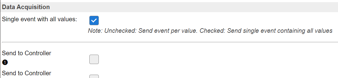

Based on this discussion I added a new feature and will now make a test build for you.
See the last commit on this PR: https://github.com/letscontrolit/ESPEasy/pull/3439
Re: pulsecounter acting strange after latest changes
See for test build:
https://github.com/letscontrolit/ESPEas ... -758278897
This allows you to set the checkbox to combine all values of a task in a single event.
UPDATE:
eveything seems to be working after all
important to mention is that if we use the values combined then we MUST USE #All
aparently the #Count, #Total and #Time do not work to trigger events
So in my code i needed to change Watermeter#Count into Watermeter#All
Yep, indeed you need to change the event to use "#All" in the rules block handling the event.
I'm glad we had this discussion, as it gave me an idea for a very simple optimization which also makes the rules a lot less complex in the end.
Especially on plugins like the pulse counter which can be updated very irregularly.
I guess further optimizations on the pulse counter are mainly on the accuracy of the pulse counting and thus may probably only be possible on ESP32 as that one has proper interrupts on GPIO pins and can provide a lot more insight in the actual pulse received.
