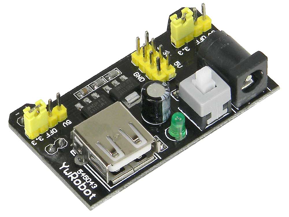

To overcome that problem, I tried using one of these as power supply for the sensor: http://www.mpja.com/images/30175-large.jpg , while keeping the 3.3v power supply for the ESP. Unfortunately the result stayed the same.
