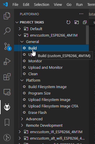

Now I just take all files from git source "as is". No Custom.h, normal, default SDK. No my changes except uncomment "#define FEATURE_SD: in default "define_plugin_sets.h" file.
Then from VS terminal run:

Have you removed the define for SD_FEATURE (or how it is called) and also performed a clean build?
pio run --target clean
(this does clean all environments, or the defined "default" environments)
mackowiakp
Posts: 543
Joined: 07 Jun 2018, 06:47
Location: Gdynia/Poland
Re: SD support compilation errors
#11 Post by mackowiakp » 25 Nov 2019, 18:03
Yes, both from VS menu and from VS terminal.

I've deleted everything and re-install from the ZIP all the source . I just remove esp32 reference in platformio.ini default_envs = custom_ESP8266_4M1M
as I don't need to compile for ESP32
Then I press in left platformio menu "build" for normal_ESP8266_4M1M as you told me that by using Custom.h, there is an auto-detect of this specific file. it compiles fine but does not use custom.h (I adapt #define BUILD_GIT with a specific string I don't see on Espeasy UI when upload the code to my ESP8266. ==> custom.h not used...
if i click on "build" custom_ESP8266_4M1M , I get SDCard compilation issue :-(
I'm lost

Just curious, how are you building?
I do select the build env in VS code like in the screenshot I have attached to this post.
2020-12-17 20_41_03-define_plugin_sets.h - ESPEasy - Visual Studio Code.png (21.65 KiB) Viewed 30861 times
And it is building just fine.

#29 Post by tparvais » 17 Dec 2020, 20:58
yes, this is what I did before I finally change a litle bit the init file.
by pressing that ==> SDcard issue
