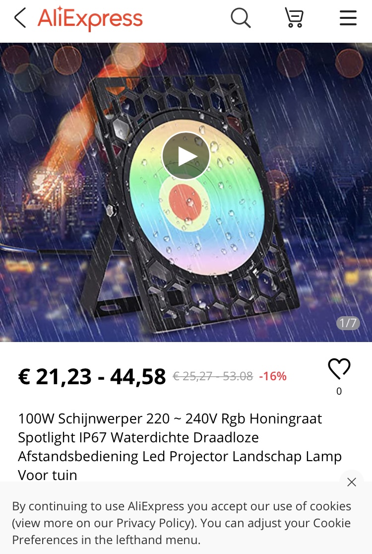

Ive bought a few 50W RGB floodlights from Aliexpress. They were advertised for 100W but yes, for 20 euro even 50w is nice.
Opened them up. They are a pretty cool design. There is no switched power supply like 99.9% of all other leds. Instead it uses just a rectifier and enough leds in series. So theoretically it will not fail as easy as all other china floodlights with ubercheap and crappy driver modules.
Each color pulles approx 70 mA, with 233v mains this nets 49va. Im unsure what the power factor is but lets assume they are 50W items.
