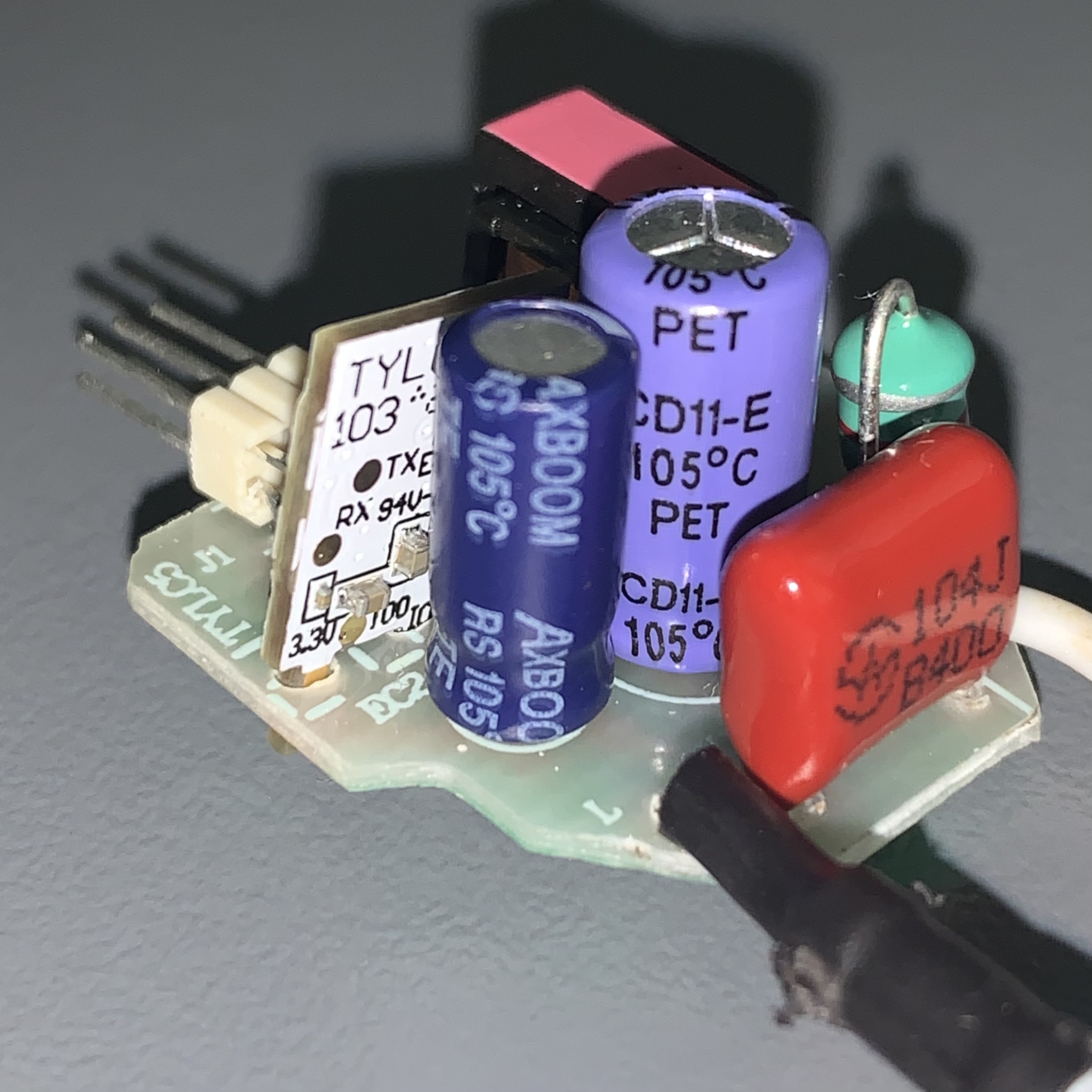

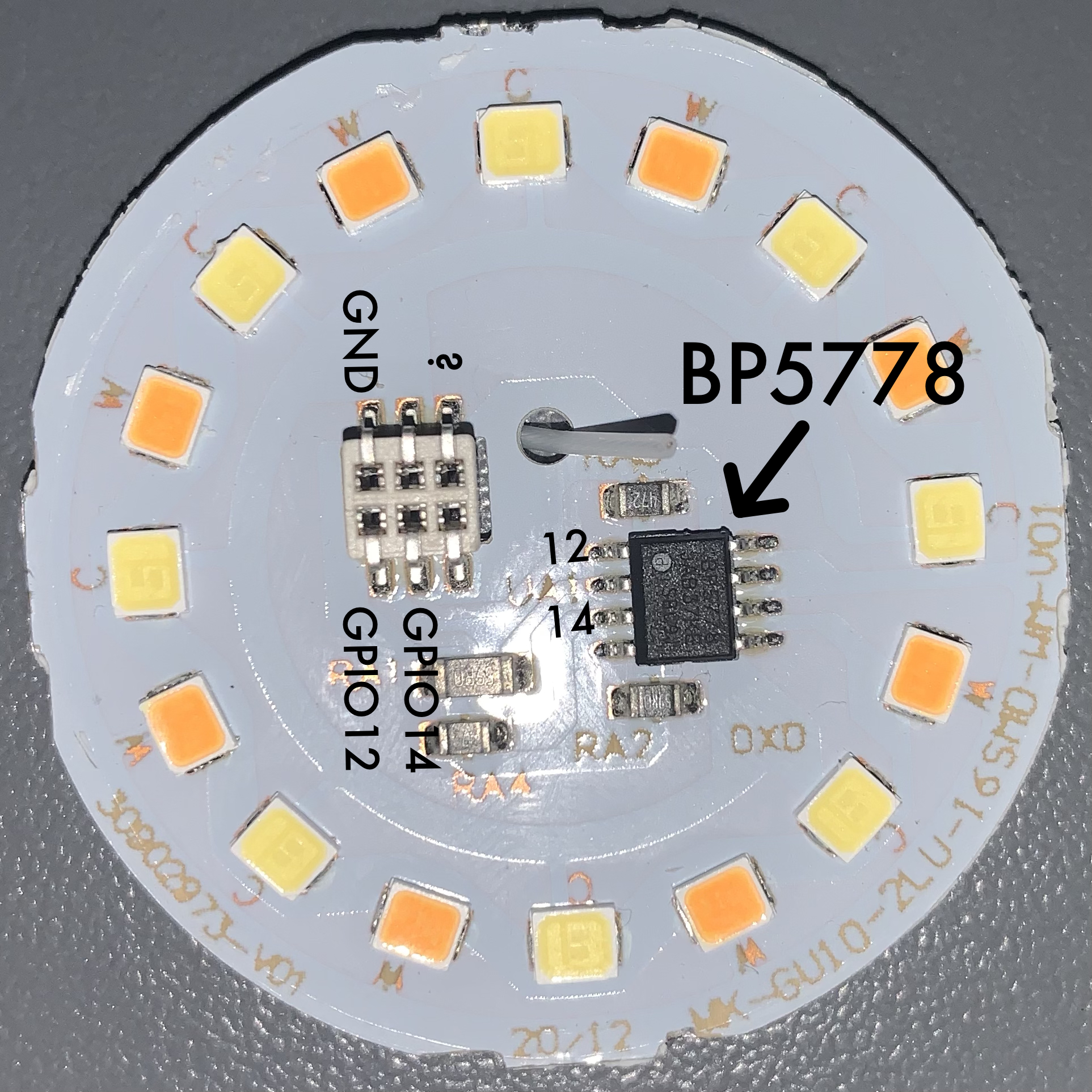

#111 Post by FlorisK-Delft » 18 Sep 2020, 21:47
Dear readers,
Did someone get the new Action, LSC Smart home, GU10 CWWW (white ambiance)(tuya) to work?
I have multiple GU10-Lights, I installed ESP-Home on some and on another one I installed Tasmota (by deassembling them and then flashing them). They both show up on my network and can be controlled. But I can't manage to find the right settings to make the spots give light.
I tried the following with Tasmota (and the same with ESP-Home, PWM and SM2135):
{"NAME":"GU10_LSC","GPIO":[0,0,0,0,0,0,0,0,38,0,37,0,0],"FLAG":0,"BASE":18}
and
{"NAME":"LSC RGBCW GU10","GPIO":[0,0,0,0,0,0,0,0,181,0,180,0,0],"FLAG":0,"BASE":18}
To be clear, it is about the white ambiance light and not te RGB lights. With disassembly I got so far to conclude that there is no SM2135 chip but a BP5778 chip. And has as brain the TUYA TYLC5 (ESP8285). And got the schematics of the PCB. See the pictures for more information.
Mvg,
Floris
