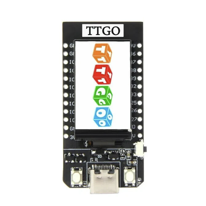

What's about this one attached? AllInOne with color TFT. It doesn't fit all the way in, but from the looks of it you can remove the display; then it fits...
Hardware specifications:
     Chipset: ESPRESSIF-ESP32 240MHz Xtensa® single/dual core 32-bit LX6 microprocessor
     FLASH: QSPI flash 16MB
     SRAM: 520KB SRAM
     USB to TTL: CH9102
     Modular interface: UART SPI SDIO I2C LED PWM TV PWM I2S IRGPIO ADC capacitor touch sensor DACLNA preamplifier
     Display: IPS ST7789V 1.14 inch
     Working voltage: 2.7V-4.2V
     Working current: Above 60MA
     Quiescent current: About 120uA
     Working temperature range: -40 ~ +85
     Size & Weight: 51.52*25.04*8.54mm (7.81g)
LILYGO®TTGO T-Display (1.14 Inch LCD color) ESP32 16MB WiFi Bluetooth Module

Those boards with display attached often are not easy to separate from eachother and extend the wiring as they will be using those flexible PCBs to connect.

... hmmm ok ... If the displays are glued that's not so nice... I just need the display swap 90° so that the board stay upward behind. Maybe this combination is available separate with a longer cable...

As said, that TTGO module with 16 MB flash doesn't allow the display to be removed without breaking it. And a separate OLED display often comes with a connector mounted at 90 degrees, making it at least 2 cm thick in total, without cutting off or de-soldering the connector pins.
Also, that same TTGO module needs a specific fix, as it is probably wrongly labelled, as the current release build doesn't support it, but I got that fixed in this PR 8-)
There are also a lot of separate models of TFT displays available, as shown in the documentation for P095 and P116.

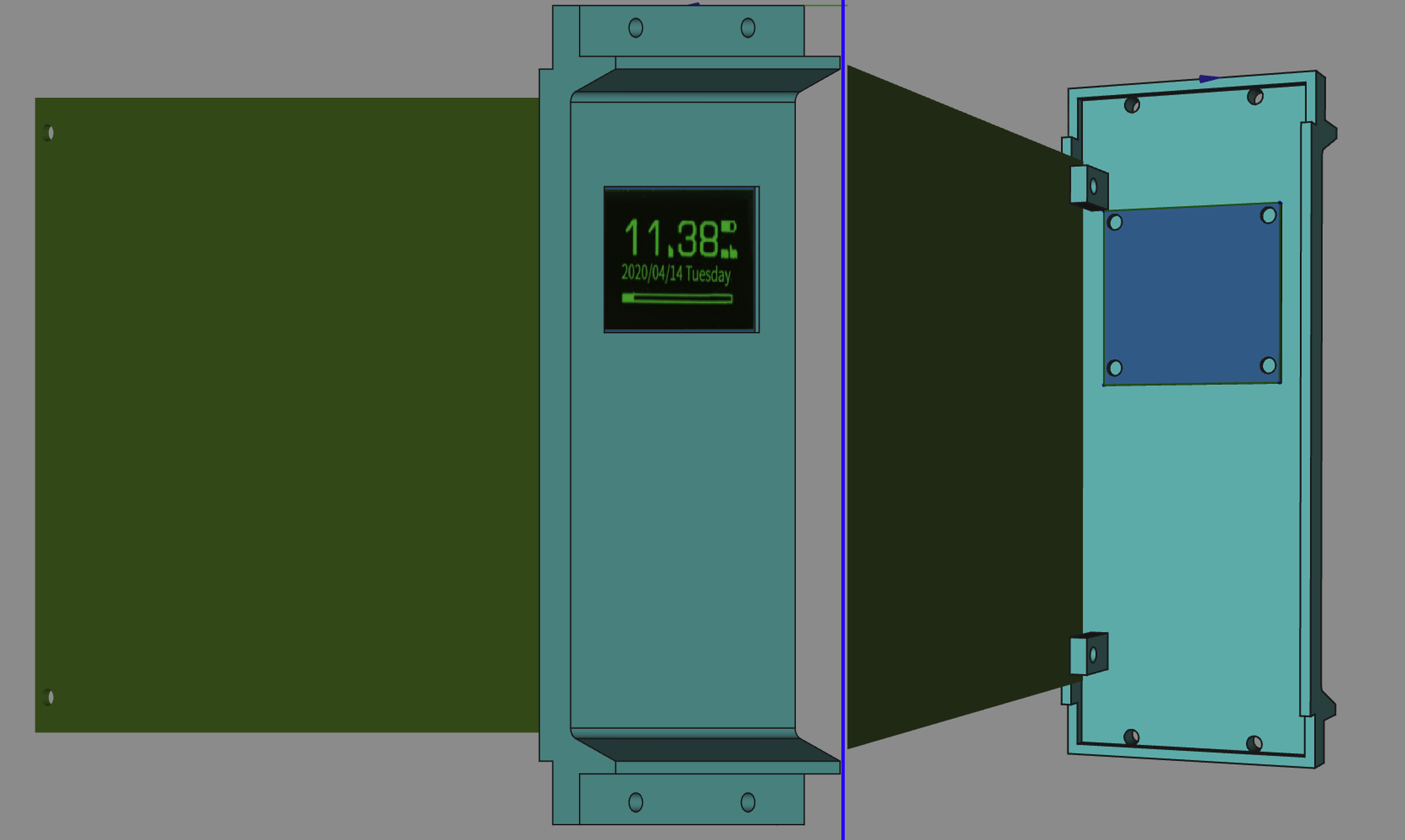

today the displays are arrived here. I'll probably take the 1.3" OLED. That fits best into a 50mm front panel.
In the CAD I still have to insert a button for the time-controlled switching on of the display and perhaps an LED that flashes every second (or something similar).
The GPS module arrived here yesterday. I only tested it on the PC and it works perfectly so far.
Now I'm just waiting for the ESP's...

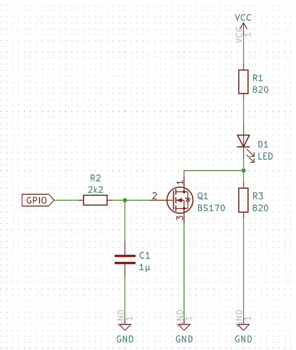

Momentary switches with DUO or RGB - LED are exorbitant expensive... :cry:
On... Plan B...
I will use a momentary with a white or blue LED. The LED are ever on but with very low intensity. I think it's a good idea, if I let the LED show a heartbeat every second. I can switch a parallel resistor to the LED via FET.
Question here: Is there a simple possibility to send a puls to any port synchronized with the seconds I catch from the GPS and stop it if the GPS-signal is lost? The you can see on the 1st view if all ok without the need to push the button and enable the display...
DLzG
Micha
Re: Counting time, calculate and display?
#28 Post by TD-er » 26 Mar 2024, 17:14
Yep, you can just schedule a looptimer via the rules to turn on/off a running (repeating) longpulse command.
In this periodical timer event you can check the fix status. If it has a fix you can be sure the received time is also correct.
But there are lots of ways to achieve the same. :)

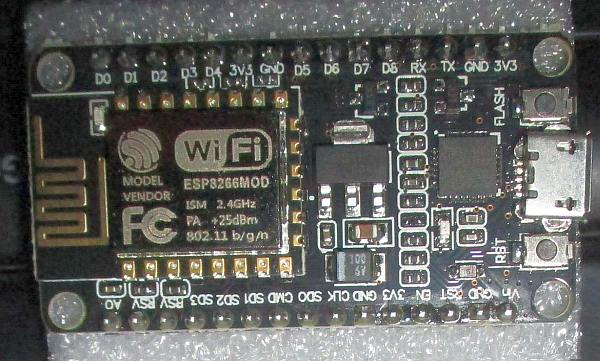

today the ESP was in the post box. They look different then what I have ordered. May you like to take a look? I have a bad feeling about it...
Ordered this: https://www.ebay.de/itm/314302581059?var=612943993669
Got 5 piece of the one attached...
Some other...

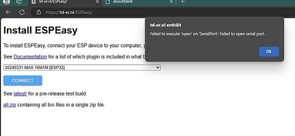

Is meanwhile only the WebFlasher supported? The WebFlasher don't work with FireFox and also not with EDGE.
Can I flash that old school either? And if there are a new offline flash tool since last year? Pls hint me there...

#38 Post by Ath » 03 Apr 2024, 15:06
The image you show is an ESP8266, so that's not going to accept any ESP32 build...
Included in the downloads from the Release page we have the original Espressif (Windows) Flash Download tool, where you have to flash an ESP82xx binary at Address 0, and for ESP32 (all derivates) the .factory.bin binary, also at Address 0.
Edge and Chrome are supposed to work with the Web flasher, but you have to allow the page access to your COM port (assuming Windows has recognized that port).
It is possibly you first need to install a driver so the device is recognized by Windows as a COM port, you can check that in the (Windows) Device Manager after connecting the ESP. I can't read the text on the serial chip on your board-photo, but the often used CH340 should be auto-recognized.

Ath wrote: 03 Apr 2024, 15:06 The image you show is an ESP8266, so that's not going to accept any ESP32 build...
Ok, then my bad gut feeling didn't let me down.
I wasn't 100% sure whether the ESP32 might be called something else. But when you say they screwed me over, that match with my gut feeling.
So at the moment no need for trying to flash any ESP32-FW into this crap ...

#47 Post by TD-er » 04 Apr 2024, 11:38
On more modern boards you can see some imprint in the metallic cap in the lower left corner stating some info on the memory/flash size.
However on older boards you will only find something like "WROOM-1" or something like that.
The difference between ESP8266 and ESP32 is quite easy to see as the ESP32 has more pins and the module is more square.
The one you did receive was mentioning "ESP8266MOD" which is quite clearly not an ESP32.
