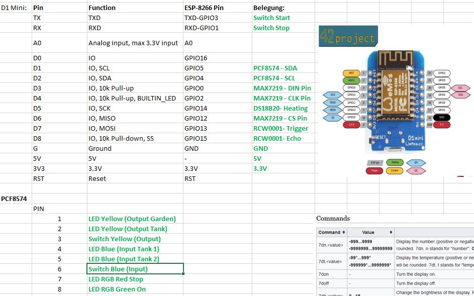

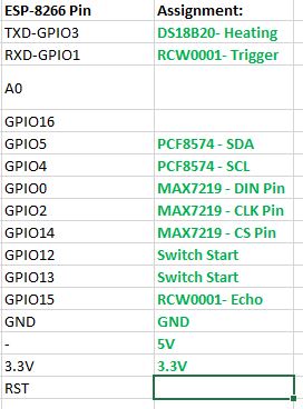

today I finished connecting all equpiment I like to connect to a D1 Mini which is running ESPEasy.
In total should be connected:
-RCW-0001 Ultrasonic Distance Sensor
-Max7219 Display
- 4 Switches
- 4 LED
- 1 RGB LED using R&G
In total the GPIOs are not sufficient so I planned to expanded the GPIOs by 1x PCF8574.
But today I added to the working RCW+Max7219+ 2 Switches (Start & Stop) the rest of 4 LEDs + 1 RGB LED and 2 Switches. This addition also included the PCF8574 and finally I identified that 1 GPIO is missing. Had only GPIO16/D0 free but had the need to connect 2 Switches (Start & Stop) which before already worked at GPIO4 & 5. But 4&5 are now used for I2C connection.
Therefore I thought it should be possible to disable serial communication in the advanced ESPEasy settings and make use of GPIO 1 & 3 for these two switches. But so far it isn´t possible/working. The Push Button push isn´t recognized by ESPEasy and I´m struggeling why.
In general all switch are connected to GND and the push connects GND to the GPIO.
The LEDs are connected to 3,3V (Anode) and the Cathode is connected to a GPIO (of course a resistor in between).
Can you please help me checking if this is possible what I like to do (first) usage of GPIO 1 & 3 for the 2 switches and (second) if my allocation in general can be used this way. I´m struggeling with the settings and the charakteristics auf the GPIOs (PullUp or No-Pullup internal etc etc.)
Thank you very much in advance. In case any information are needed please let me know.

Re: D1 Mini usage of GPIO1&3 (RX/TX) for Switches and general allocation?
This looks like a setup that should work (I've re-used RX and TX myself in several ESP01's and Sonoff S20's), but you really need to use external pull-ups when connecting switches/buttons, so the only question I can think of right now is: Have you used external pull-ups (4k7 - 10k) on RX and TX?
(The internal pull-ups are way to high in ohm (80k - 100k) to work reliably for wires > 10 cm, they act as antennas when not closed)

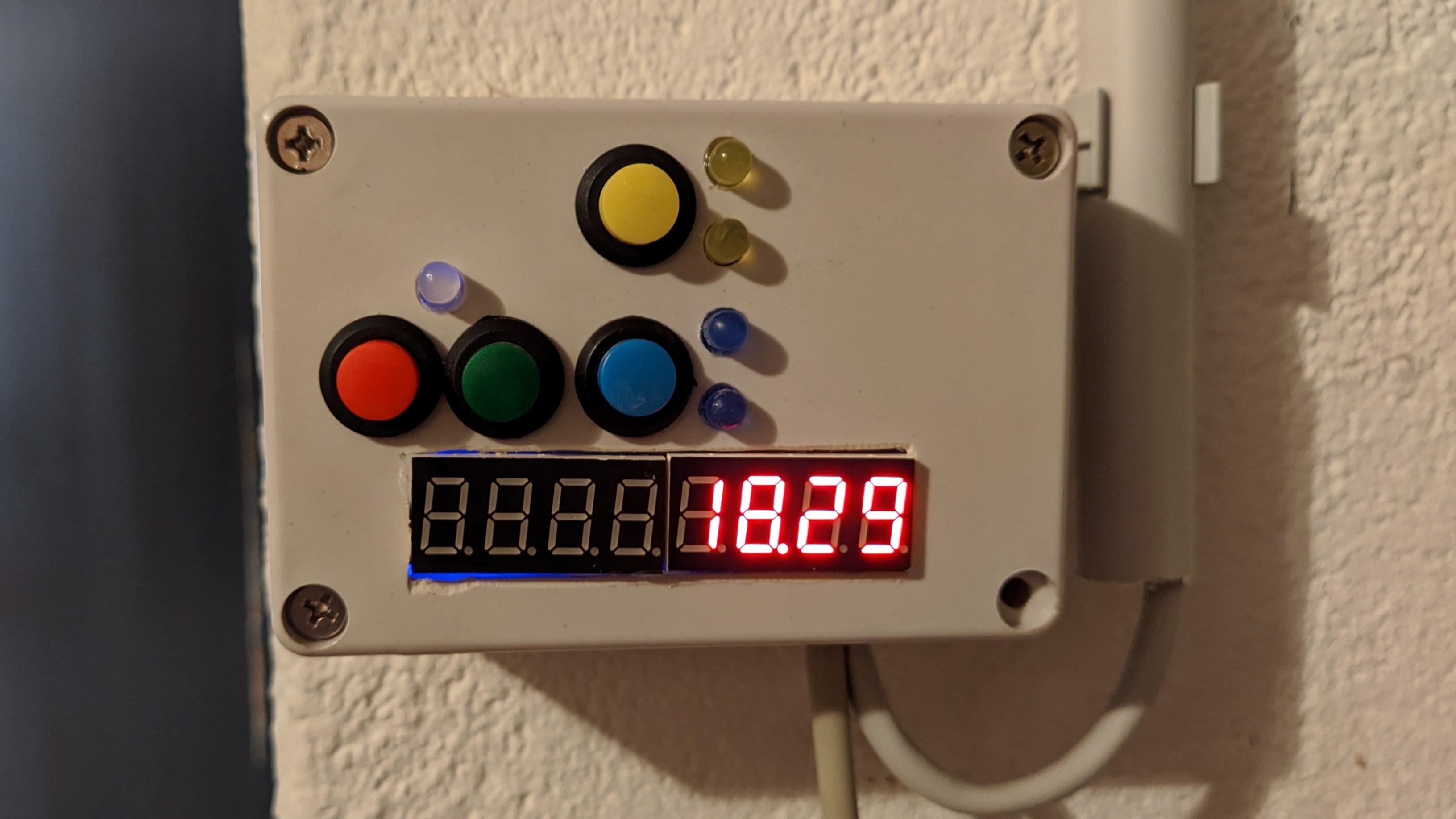

Thx for your reply.
No I have not used external pullups for RX & TX. As you can imagine from the pictures (D1 mini inside of this Box) the Red and Green Button are connected directly to GPIO 1 & 3.
The Buttons (other Pin) are all connected to GND. For the connection from button to GPIO I used prefabricated Dupont cables and cutted them by ~3/4 so would guess the cable is ~7/8cm long.
Sorry, a bit late for me....you suggest connecting 3,3V -> 4,7kOhm->GPIO in addition to pull the GPIO up to high level in case push button is not pressed, right?

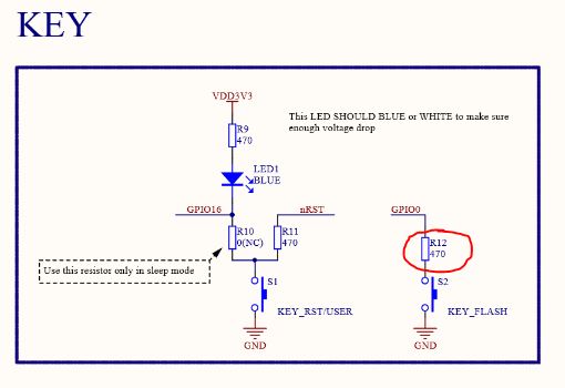

What I meant was the separate part of the NodeMCU schematics where they describe the resistors surrounding the push buttons of the board.
true
Think you mean this. see attached and will add this resistor for RX & TX.
Yep, but keep in mind GPIO-0 is already pulled up by a 10k or 12k resistor to make sure it boots in the correct mode.
GPIO-0, GPIO-2 must be pulled up at boot
GPIO-15 must be pulled down at boot.
GPIO-16 is special as it cannot have an interrupt set to its state.

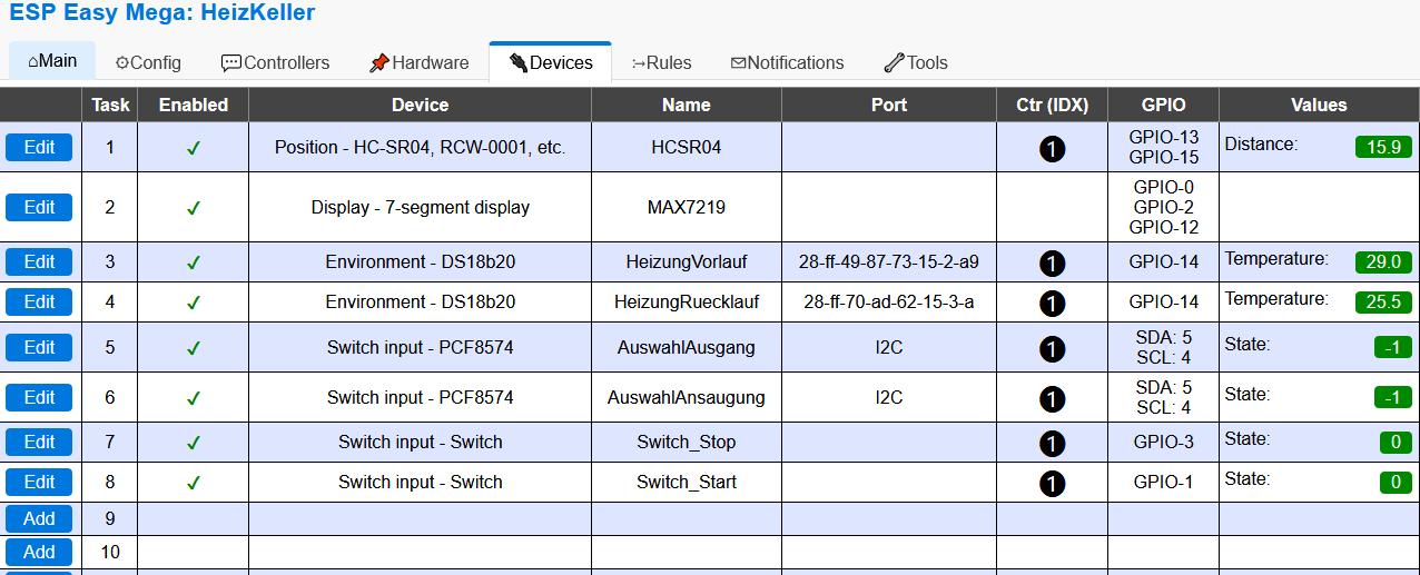

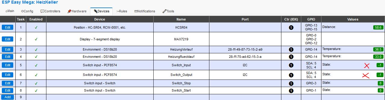

Thx, the PCF8574 is already in place and connected.
Because Start/Stop Button at GPIO 1/3 will earliest work on friday, I thought of using the other 2 buttons (yellow, blue) which are connected to pcf8574 for start/stop until then.
Selection possibility by MotorOperatedValves isn´t mounted yet.

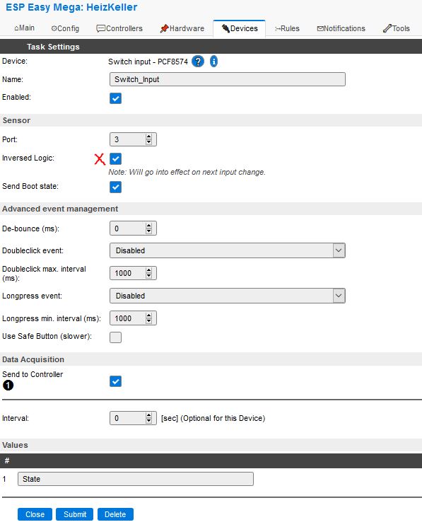

Checked the wiki regarding PCF8574 before and this helped to build up the LED circuit to sink the current, because current operability is limited.
But I´m not sure how in detail the switch input should be configured and later on the result will look like.
e.g. Because of sink the current I thought of "Inversed Logik" in the setup must be ticked?
Based on this the switches are showing a result of -1 at the moment without beeing pushed. This looks strange to me because expecting a 0.
- pcfswitch.JPG (58.67 KiB) Viewed 26246 times
- devices.JPG (82.42 KiB) Viewed 26246 times

Ah, the I2C Scan does not show the PCF8574 anymore. There must be a problem. Will check the wiring on friday.
Does it show the address? In that case: code has been changed that on 'memory challenged' builds the names of I2C devices are no longer shown, only the address is shown, as this is a fixed set of names, but that costs some resources that are left out in this build.
If it says 'No I2C devices found' (or smth similar) then you could have a wiring issue.
Thx, had seen adress 0x20 after a scan on sunday but now it shows "No I2C devices found" so there is sth wrong I have to check.Ath wrote: ↑07 Sep 2020, 13:08Does it show the address? In that case: code has been changed that on 'memory challenged' builds the names of I2C devices are no longer shown, only the address is shown, as this is a fixed set of names, but that costs some resources that are left out in this build.

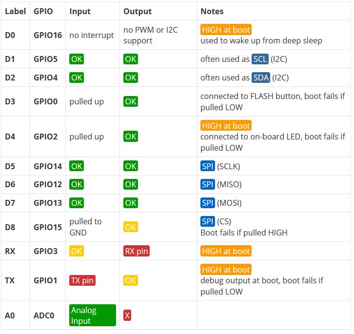

It is always a good idea to initialize the values at boot.
Also the ESP does output some data to the serial port during boot, so if the pins must absolutely not be changed at boot, then you should use another pin.
See:
https://espeasy.readthedocs.io/en/lates ... on-esp8266
http://rabbithole.wwwdotorg.org/2017/03 ... -gpio.html
https://randomnerdtutorials.com/esp8266 ... nce-gpios/
Last one might be the most clear to read as they do have a nice table with boot states.
Thx, this table/information is great! So will reallocate the buttons for start/stop to other GPIOs. Seems to be better/easier than filtering a valid push or unvalid high from boot procedure.TD-er wrote: ↑07 Sep 2020, 16:02
Do not have a feeling which of my used equipment is to be used best / uncritical for this bootup behaviour of (High) GPIO 1 & 3.
According the table I will first try GPIO 12 & 13 for the buttons. The Trigger of the RCW-0001 distance sensor and the CS-Pin auf the Max7219 will then be connected to GPIO 1 & 3. Hope this will work stable.
Or according this link and my experience. GPIO 4 & 5 is most uncritical and will work for the push buttons. But I use I2C now and these are the standard GPIOs. So have to switch I2C to other GPIOs. Do not know if the I2C communication ports "like" a high at bootup or this is uncritical.
I2C is most of the time quite forgiving.
Only some devices may act a bit strange, but as long as the clock and the data line are not likely to act together, I don't think any device may think it is addressed.
If so, you can also swap the SDA/SCL.
I think it is best to use at least those pins that allow to be pulled up, or are already pulled up.
So GPIO-15 is a big no-no for I2C and GPIO-16 as that one doesn't allow interrupts.
But better test first. I'm not 100% sure if ESP82xx does act differntly on using other pins for I2C, but I know some available boards do have other pins assigned, so it should work just fine I guess.
GPIO-0 is also perfectly fine for a button, as long as you don't press it during boot.
For example Sonoff's use GPIO-0 always for a button, which makes flashing also a lot easier.
GPIO-2 is often connected to the LED. Some ESP12E/F/S modules have a blue LED on the module itself, which is then connected to GPIO-2. (inverted)
If you need UART, you can also swap the pins of Serial0 to GPIO 15 and 13 (need a PNP transistor on GPIO15 to make sure it can boot).
This way you have hardware UART and not using the pins that will receive data during boot, before ESPEasy is sending anything.
Thx, think now I have to try and see what will work.
Current status is to start testing according following re-allocated asignment:
- Reassignment.JPG (32.49 KiB) Viewed 26167 times
Big Thx! According this allocation it is working and so far also by reboot of the ESP8266 no High signal/Start signal according the push buttons.
Think this is the solution for me, Thx!
