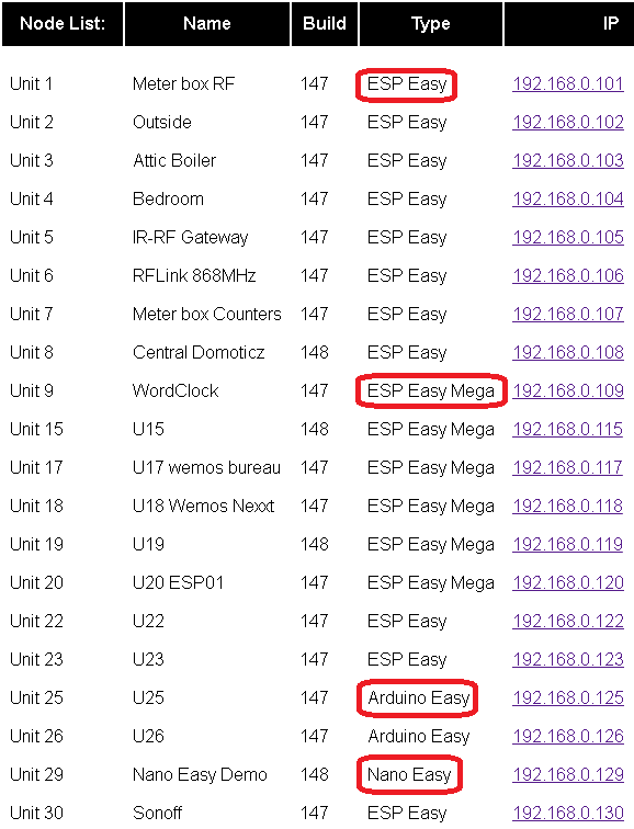

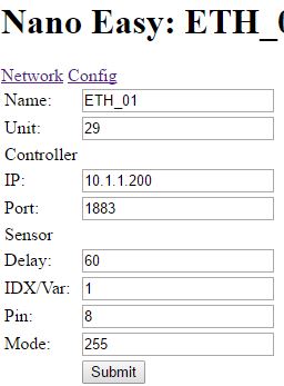

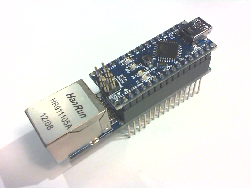

Another node type added to the list:
Very limited webgui: (if it runs at all...)
You'll have to compile this yourself, source available:
http://www.letscontrolit.com/wiki/index.php/NanoEasy

kniazio wrote:Will it be available for Arduino Uno?
It should work on Uno, Nano, Pro Micro and any other board with an Atmega328 chip as long as an ENC28J60 module is connected to the SPI bus
