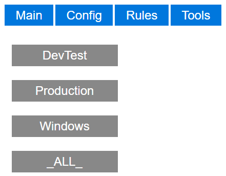

Re: "SmartNodeRules" concept idea
That should be solved on github now. In the mean time, a new feature has been added to show nodes in groups. A new command:
Config,Group,<group name>
has been introduced. Th main page now shows a list of groups based on the nodelist. Click on a group to show all nodes within that group.
