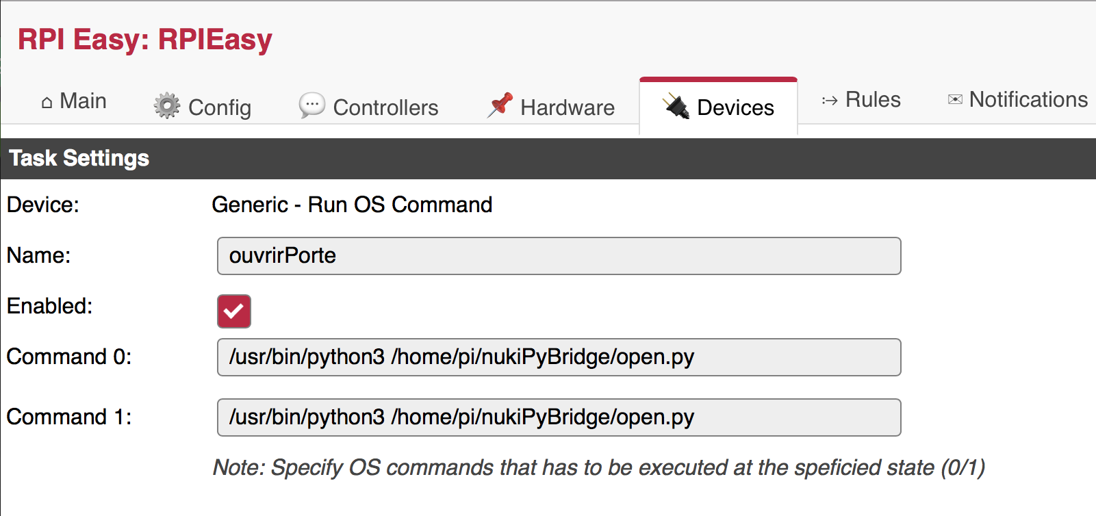

I try to use Generic - Run OS Command device, to launch a python script. I also tried through the submit command of the tool menu, but the only answer I get is Unknown command.
in the ssh terminal, when using the exact complete path to the script that I use in the "Command" box and it works... (rights are OK, had a +x). I must be doing something wrong, but can't get what. Have you got any idea?
Thanks! Laurent

laurentm wrote: 29 Mar 2020, 15:36 in the ssh terminal, when using the exact complete path to the script that I use in the "Command" box and it works... (rights are OK, had a +x). I must be doing something wrong, but can't get what. Have you got any idea?
You mean you've tried "/usr/bin/python3 complete/path/of/pythonscript.py" ?
This is the complete path with the executable.

#213 Post by enesbcs » 01 Apr 2020, 19:03
laurentm wrote: 01 Apr 2020, 18:01 in the ssh terminal, when using the exact complete path to the script that I use in the "Command" box and it works... (rights are OK, had a +x). I
16:56:29 : CMD: /usr/bin/python3 /home/pi/nukiPyBridge/open.py
16:56:29 : Unknown command: /usr/bin/python3 /home/pi/nukiPyBridge/open.py
There has to be some misunderstanding. Command box in RPIEasy is not for Linux commands, it will never work in that way. It is meant for internal ESPEasy/RPIEasy commands.
Currently the only place that an OS command can be added in RPIEasy is the "Generic - Run OS Command" plugin settings page... and it can be triggered by a virtual switch from Domoticz with this IDX or with taskvalueset command...
Otherwise i can add a new command like "eval" to open external python files for internal execution if needed.

#214 Post by laurentm » 01 Apr 2020, 21:34
enesbcs wrote: 01 Apr 2020, 19:03
Thanks for the explanation. No need for that. But if I tried it that way, it's because the Run OS Command doesn't trigger the script either... See my config :
When typing TaskValueSet 2,1,1, it triggers the right task (it's task 2):
20:24:00 : Event: Clock#Time=Wed,20:24
20:25:00 : Event: Clock#Time=Wed,20:25
20:26:00 : Event: Clock#Time=Wed,20:26
20:26:49 : CMD: TaskValueSet 2,1,1
20:26:49 : Event: ouvrirPorte#State=1
But the python script isn't launched... I also tried with sudo, but without success. Is there another log I could check to understand what happen "under the hood"?
Thanks! Laurent

#215 Post by enesbcs » 01 Apr 2020, 22:09
laurentm wrote: 01 Apr 2020, 21:34 But the python script isn't launched... I also tried with sudo, but without success. Is there another log I could check to understand what happen "under the hood"?
I've tested it now. When i am trying to execute an invalid command i am seeing this error message on the Linux Console:
22:03:06: CMD: taskvalueset,rcmd,State,0
/bin/sh: 1: dfsf: not found
22:03:06: Event: rcmd#State=0
Beside of that if you change log level (tools->advanced) to "Debug More" than if there are any output from the command execution and there were no error occured, than it will be printed. Try it with simple commands first, such as "ls".

#216 Post by laurentm » 01 Apr 2020, 23:03
enesbcs wrote: 01 Apr 2020, 22:09 Try it with simple commands first, such as "ls".
OK, so I changed log level, and then set Command 0 to ls. It works (I don't paste everything, but it's obviously listing the ripeasy directory). I then tried to put a wrong command, as you did, for Command 0, but the output is empty, unlike you... weird. The python script command still doesn't return anything (as if it was wrong, although it works in a Terminal window).
With Command 0 as ls
True
21:31:26 : _C001_DomoHTTP.py
_C002_DomoMQTT.py
_C004_ThingSpeak.py
_C008_GenHTTP.py
_C009_FHEM.py
_C010_GenUDP.py
_C013_ESPEasyP2P.py
_C014_GenMQTT.py
_C015_Blynk.py
_C016_DBStore.py
_C020_LoraDirect.py
_C021_BLEDirect.py
_C022_ESPNow.py
_C023_IFTTT.py
commands.py
Here with a wrong command in Command 0 :
True
21:43:00 : Event: Clock#Time=Wed,21:43
21:44:00 : Event: Clock#Time=Wed,21:44
21:44:15 : CMD: TaskValueSet 2,1,0
21:44:15 :
21:44:15 : Event: ouvrirPorte#State=0
The same "nothing" output with the python script :
21:31:26 : Event: ouvrirPorte#State=0
21:31:54 : CMD: TaskValueSet 2,1,1
21:31:54 :
21:31:54 : Event: ouvrirPorte#State=1
Well, I'm stuck... I think I'm gonna reinstall everything to be sure that I didn't make a mistake somewhere. Thanks for your help and above all, thanks for all the work you did to develop rpieasy!
Laurent
enesbcs
Posts: 587
Joined: 18 Jun 2017, 11:02
Location: Békéscsaba, Hungary
Re: RPIEasy
#217 Post by enesbcs » 02 Apr 2020, 19:14
laurentm wrote: 01 Apr 2020, 23:03 The same "nothing" output with the python script :
21:31:54 :
Thanks! I will look after deeper at the weekend.
In the meantime perhaps you could try to save command to an .sh script file and add some debug lines, such as create file, write log on startup in the linux script for more testing.

Assuming that your python script has the execute bit set like
chmod +x /home/pi/nukiPyBridgeOpen.py
Please add as first line in your python script
#!/usr/bin/env python3
and then try with
, so without the /usr/bin/python3
Or
make the first line in your script
#!/usr/bin/python3
and then try with
, so again without the /usr/bin/python3

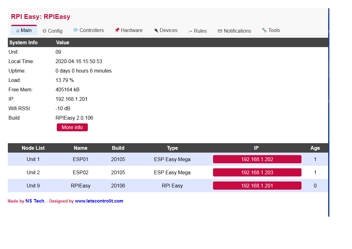

About Easy P2P. For simplicity I will setup a ESP8266 & a RPI zero with RPIEasy.
At esp8266, setup P2P controller and enabled. UPD port 8266 as communication port (defined at advanced)
3 sensors connected (DHT22, BH1750, BMP180) and setup with connection to P2P controller.
Sensor are at task 3,4,5 of esp8266
At RPIEasy only P2P controller required at 8266 UDP Port.
At home of each device are shown all nodes that communicate each other (that works)
After a few seconds (or 1 minute) esp8266 must populate tasks 3,4,5 of RPIEasy (that not works).
Final step is to enable at RPI Easy tasks 3,4,5 and voila data are available from 8266 to RPIEasy.

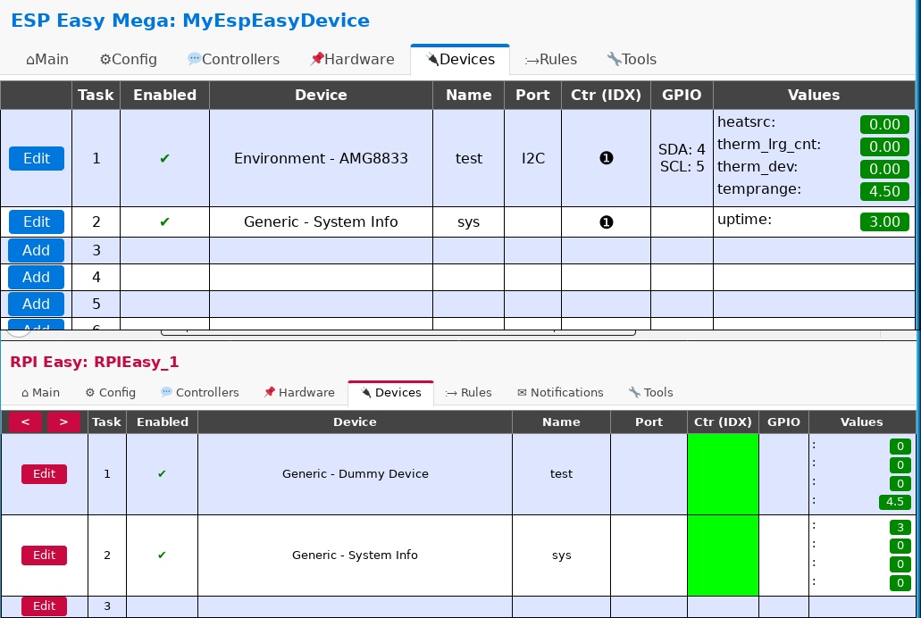

I've added a System Info device to Task 2 at an ESPEasy, checked the "Send to controller" checkbox, and at the RPIEasy side the same task is appeared with Disabled state. I checked it to enabled and the datastream from ESPEasy to RPIEasy is started at the interval setted at the ESPEasy side. It just works. Did you started RPIEasy at root rights? UDP cast messaging is not enabled to simple users.
(At RPIEasy side if it is the receiver on the Device page the Controllers checkbox is off i hope?)
Hint: Device creation only triggered once at RPIEasy side: when you press the submit button on the device page at ESPEasy side.
The green cell means that it is a remote device, not a local one.
