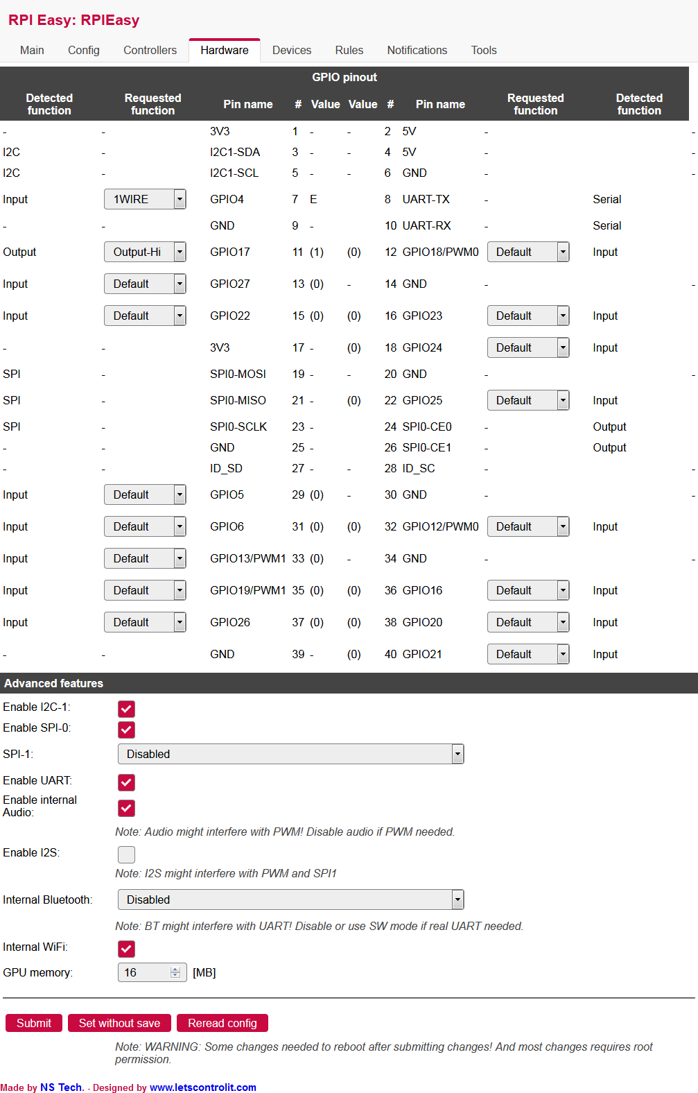

#88 Post by asuz » 15 Mar 2019, 19:50
Is there any option that RPIEasy remember last state of GPIO after reboot?
enesbcs
Posts: 587
Joined: 18 Jun 2017, 11:02
Location: Békéscsaba, Hungary
Re: RPIEasy
#89 Post by enesbcs » 16 Mar 2019, 11:08
asuz wrote: 15 Mar 2019, 19:50 Is there any option that RPIEasy remember last state of GPIO after reboot?
Raspberry has 3 option for output pin state at boot-time:
1/Output (in real world this is also changes to Low at boot)
2/Output-Lo
3/Output-Hi
I've added "Preserve state at startup" option to P029 Output helper plugin. It restores output pin state on selected GPIO to the last known one, which is saved at normal restart/shutdown. But as RPIEasy is an application it will kicks on several seconds after OS boot...
asuz
Posts: 175
Joined: 31 Oct 2018, 18:22
Re: RPIEasy
#90 Post by asuz » 16 Mar 2019, 11:57
enesbcs wrote: 16 Mar 2019, 11:08
2/Output-Lo
3/Output-Hi
You mean that RPIEasy already include P029 Output helper plugin for remember last state of GPIO? If yes mine always forget last state :(. (RPIEasy 0.19.075).

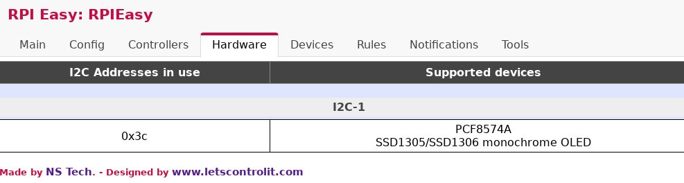

By the way how can I connect LCD screen like 20X4? I see there is options for OLEDs but not LCD's
enesbcs
Posts: 587
Re: RPIEasy
#91 Post by enesbcs » 16 Mar 2019, 18:10
asuz wrote: 16 Mar 2019, 11:57 You mean that RPIEasy already include P029 Output helper plugin for remember last state of GPIO? If yes mine always forget last state :(. (RPIEasy 0.19.075).
Strange, because it is working for me. I have setted GPIO17 to Output type, added a P029 device, setted to HIGH with "gpio,17,1", and after rebooting from Tools->Reboot than the RPI is restarting than P029 device value stays 1 and in Hardware->Pinouts&Ports i also see it HIGH, and also the Logs says that it setted to High (Event: o17#State=1).
Did you downloaded new lib file also? Did you deleted and recreated P029 device or did you use an existing entry? Did you checked and submitted "Preserve" setting at P029? And examine logs please...
LiquidCrystal_I2C LCD? At this time this is not supported, but i have somewhere one for testing. I am opening a new issue for it.
enesbcs
Posts: 587
Re: RPIEasy
#92 Post by enesbcs » 16 Mar 2019, 23:43
Please try latest commit. After i set specific GPIO to high, i've done a reboot, and i get this:
22:51:48: Pi Zero W 40 pins
22:51:49: Event: o17#State=1

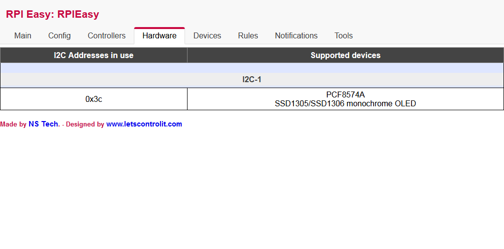

asuz wrote: 18 Mar 2019, 13:32 Another issue is LCD and OLED's at RPIEasy. I cannot get display even oled or lcd. Here is dependencies page. I test my oled and lcd at nodemcu so there is nothing wrong with them. What can I do to solve that issue?
Please show me your Hardware->I2C Scan page contents, and the Logs at the time when you enabled the LCD/OLED plugin.

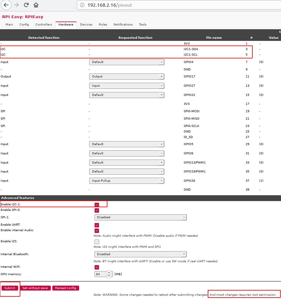

I am attaching some pictures which you have to see before even thinking to enable any I2C related plugin.
I2C Scan
I2C Scan

asuz
Posts: 175
Re: RPIEasy
#96 Post by asuz » 18 Mar 2019, 21:38
enesbcs wrote: 18 Mar 2019, 19:55 I am attaching some pictures which you have to see before even thinking to enable any I2C related plugin.
Thank for responce, my Pinout&Ports page is similar to yours but how can I sure about my root permissions?

#97 Post by enesbcs » 18 Mar 2019, 22:19
asuz wrote: 18 Mar 2019, 21:38 Thank for responce, my Pinout&Ports page is similar to yours but how can I sure about my root permissions?

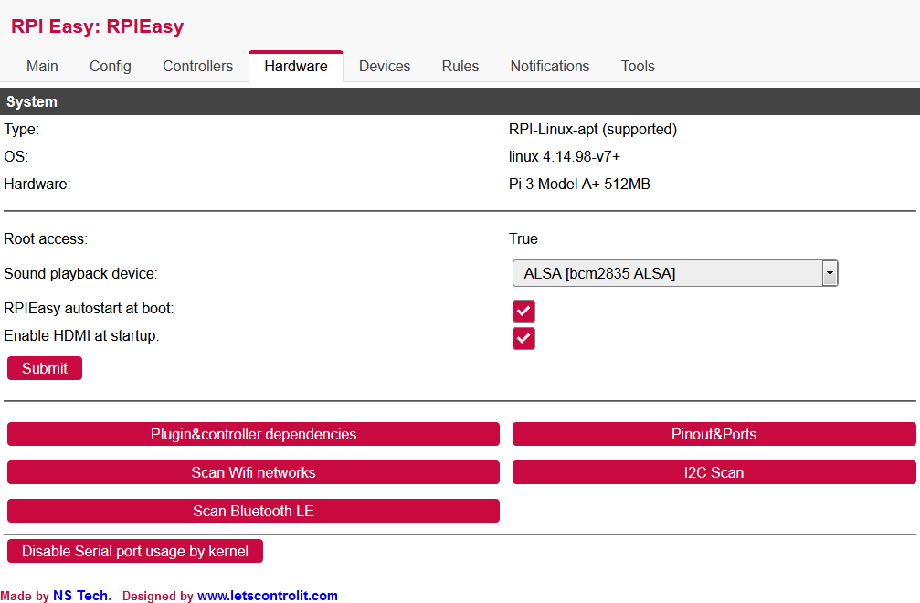

It's pretty simple. on hardware page, there are a red warning if you are not root, and at Pinout&Ports there are no submit button if you have no root rights.
How about I2C scanning?

#98 Post by asuz » 18 Mar 2019, 23:02
enesbcs wrote: 18 Mar 2019, 22:19

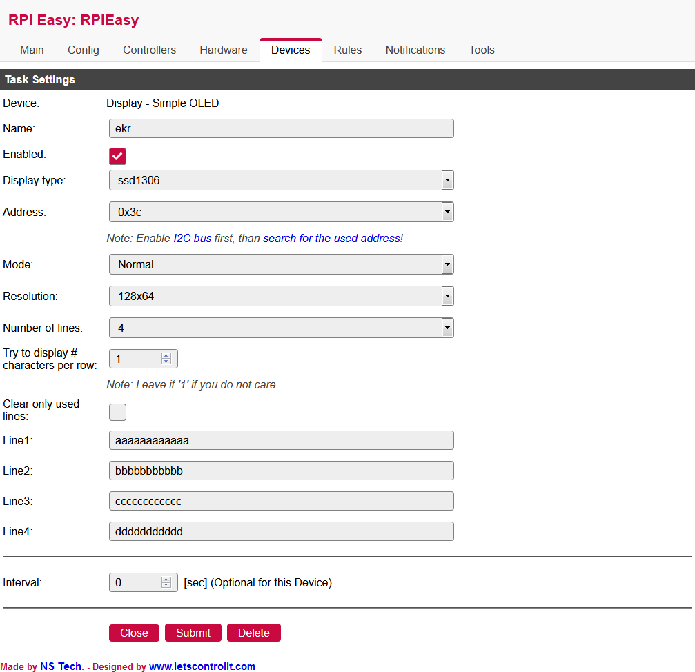

Sorry about it but here is the pages for your reference, there is nothing at my OLED. Am I missing something? Please can you check?

#99 Post by enesbcs » 19 Mar 2019, 06:56
asuz wrote: 18 Mar 2019, 23:02 Sorry about it but here is the pages for your reference, there is nothing at my OLED. Am I missing something? Please can you check?
Try to set interval to 5 sec or any non-zero value... this way it's content written in the setted interval.

#100 Post by asuz » 19 Mar 2019, 10:24
enesbcs wrote: 19 Mar 2019, 06:56
Thanks for that suggestion, it works with non-zero values. Actually I donot touch that area beause it says "Optional for this Device". Maybe that helps somebody after me. Thank you very muchhhhh again :)
