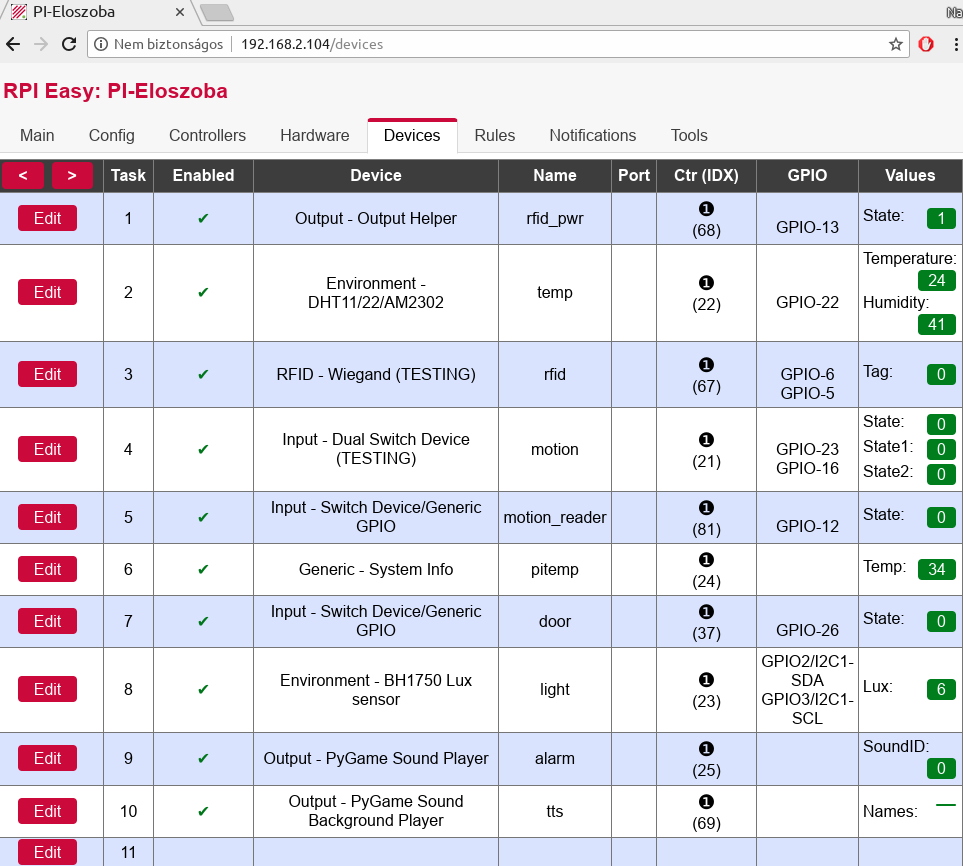

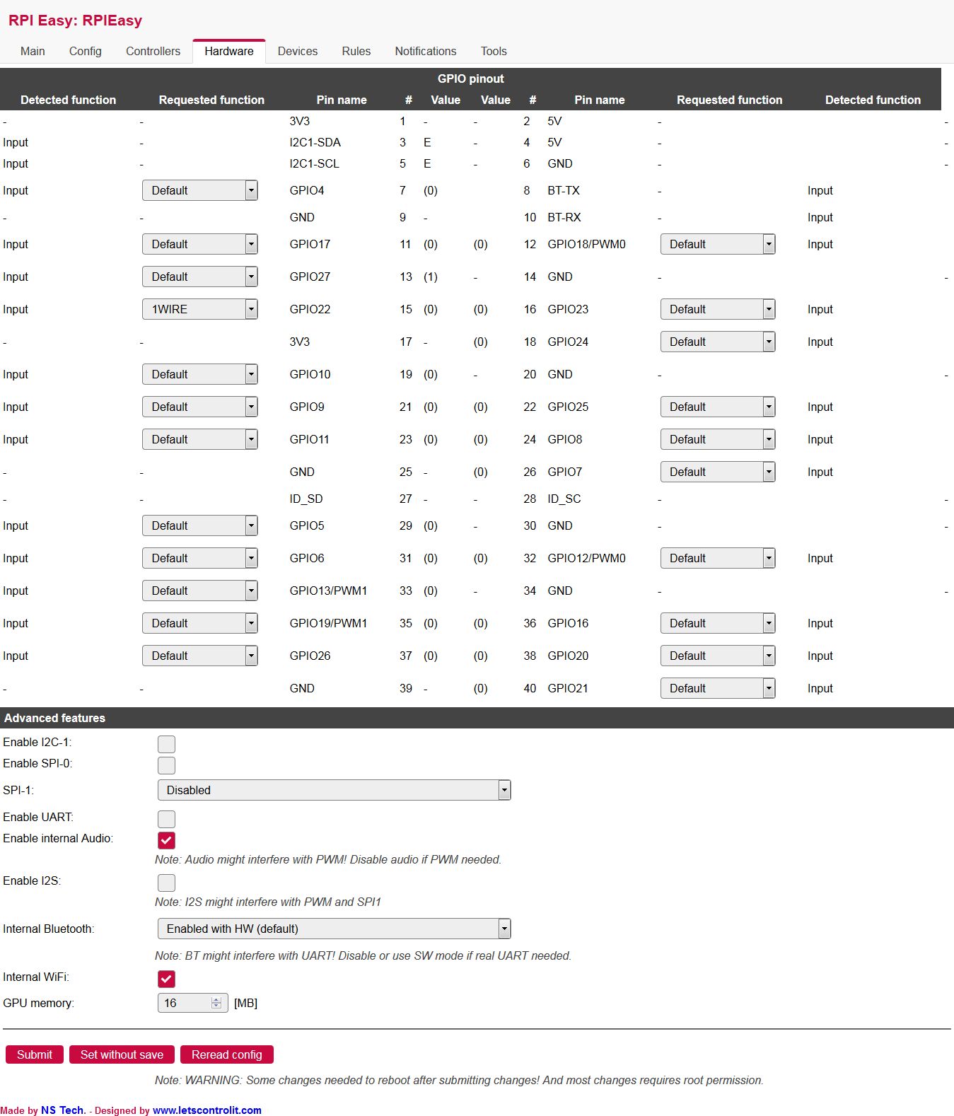

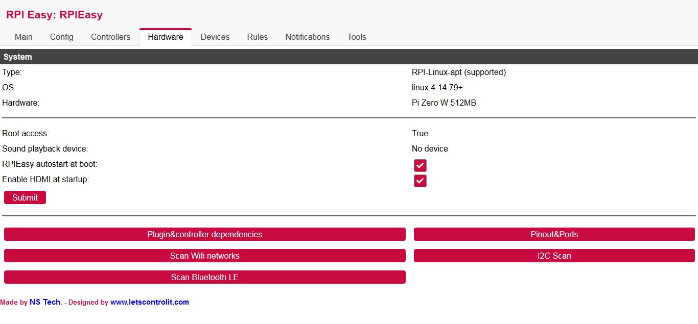

It's almost time to say Happy New Year... but instead i want to introduce my new project: RPI Easy.
If there is anyone who has a Raspberry PI and wants to use it's GPIO with sensors in a similar way, that ESPEasy offers (special thanks to the ESPEasy Dev Team!) than this project he is looking for.
I like ESPEasy, I have several ESP8266 at my home, but also have some Raspberry PI Zero W, which consumes not so much, despite their computing capacity. So it looked like a logical step to me, to rewrite my old python sensor handlers, and merge somehow with the ESPEasy user interface... it was harder than i thought. Earlier i used RPI's with several different and personalized python codes, but today (after six month of development) i decided that RPIEasy reached a milestone, and i publish it.
The project needs some testers and feedbacks. :) I do not say that it is stable, instead i say the truth: it is a beta development version, with a lot of work to do.
But hey, it is free and open source...
https://github.com/enesbcs/rpieasy
An image says more than thousand word, so:
RPIEasy main
RPIEasy main
RPIEasy devices
RPIEasy devices

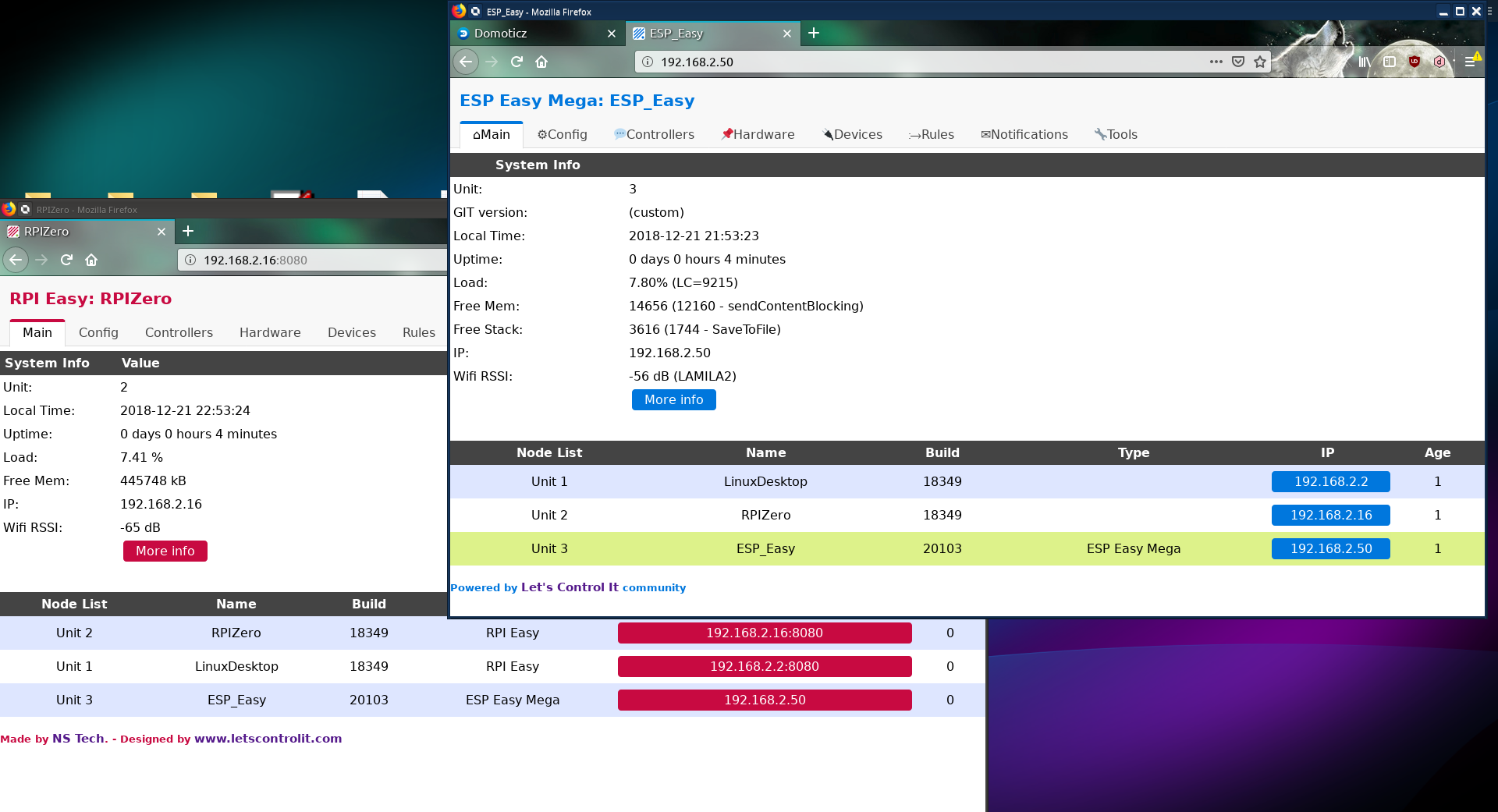

I forgot to mention, that ESPEasy P2P controller need to be enabled, to join the network, but as i see, it is obvious. :) And as you see, i missed sorting in the unit list, adding it to the issues.
Also the "Type" only shows up on RPIEasy node listing but not from within the standard ESPEasy node list.
-D

iron wrote: 30 Dec 2018, 20:28 Also the "Type" only shows up on RPIEasy node listing but not from within the standard ESPEasy node list.
It needs to be fixed at the ESPEasy code, not in the RPIEasy. :)

You can check the capacity of your PI with the "top" command, if it is below 100% than it has some reserves...
Port selection is automatic.
If you run it as root, it will try to use port 80 (as only root can use ports <1024), if it fails (not root or used by other program), than try to use 8080, if none of the above available tries to use 8008. I do not really want to provide port selection because i have a network scanner program, and if i do not know what ports to search, it will be hard (slow) to find them on the network.
Hint: A lot of settings, for example GPIO pin working mode (input, output, hardware pwm), dependency install, wifi scan only can be reached as root.

Please post "cat /boot/config.txt" and PrtScr from RPIEasy Hardware page and PInout&Ports page with GPIO22.
