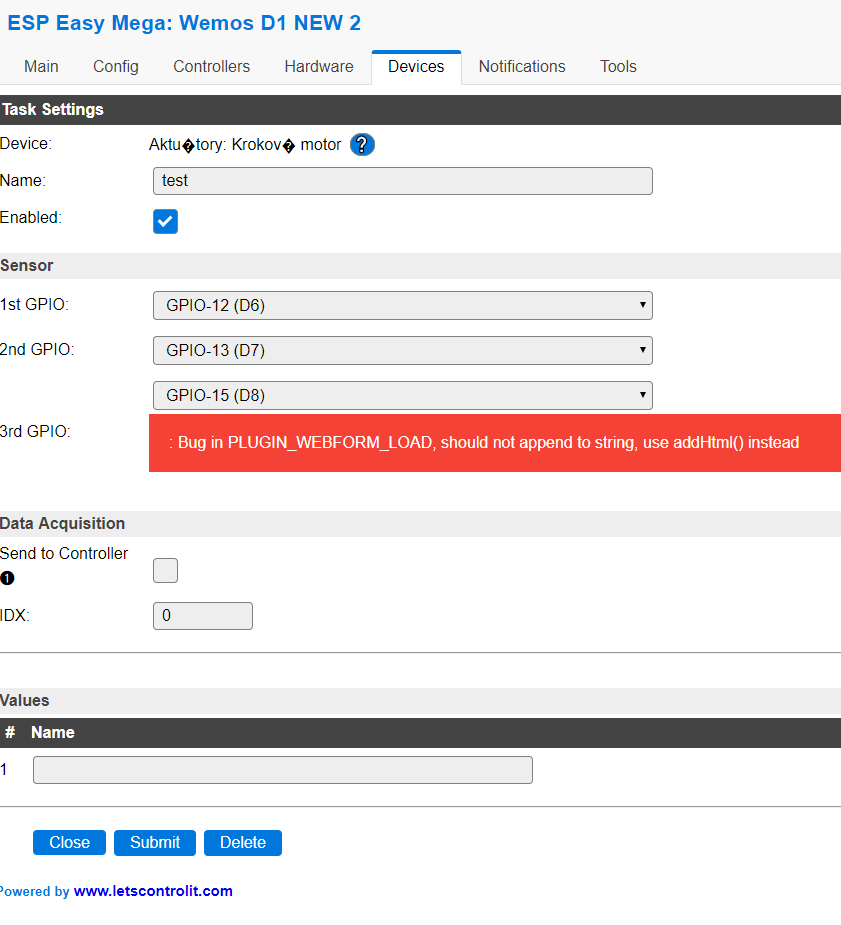

Compile did work without any errors. But what HTTP requets to send to control this steppermotor?
Domosapiens
Posts: 307
Joined: 06 Nov 2016, 13:45
Re: Stepper Motor
#9 Post by Domosapiens » 29 Mar 2017, 00:45
YES!!
My baby makes its first steps!
DIYEd,
did you find HTTP request capabilities ?

i am using the code from the fist page of this thread. Compiling and uploading OK.
When i try to add the motor plugin i get this error:
Is that something i can ignore? Doesn't look like it. Am i the only one with this error?
Would be thankful for an advice.
Thank you
ED

#30 Post by Monster Beat » 10 Aug 2018, 16:29
Is there anybody using it with actual mega firmware?
there is less about stepper motors in the forum nobody usig it?
Monster Beat
Posts: 4
Joined: 03 Nov 2016, 23:13
Re: Stepper Motor
#31 Post by Monster Beat » 10 Aug 2018, 17:02
EDsteve wrote: 18 Jun 2018, 21:07
Thank you
ED
Same Problem here...
