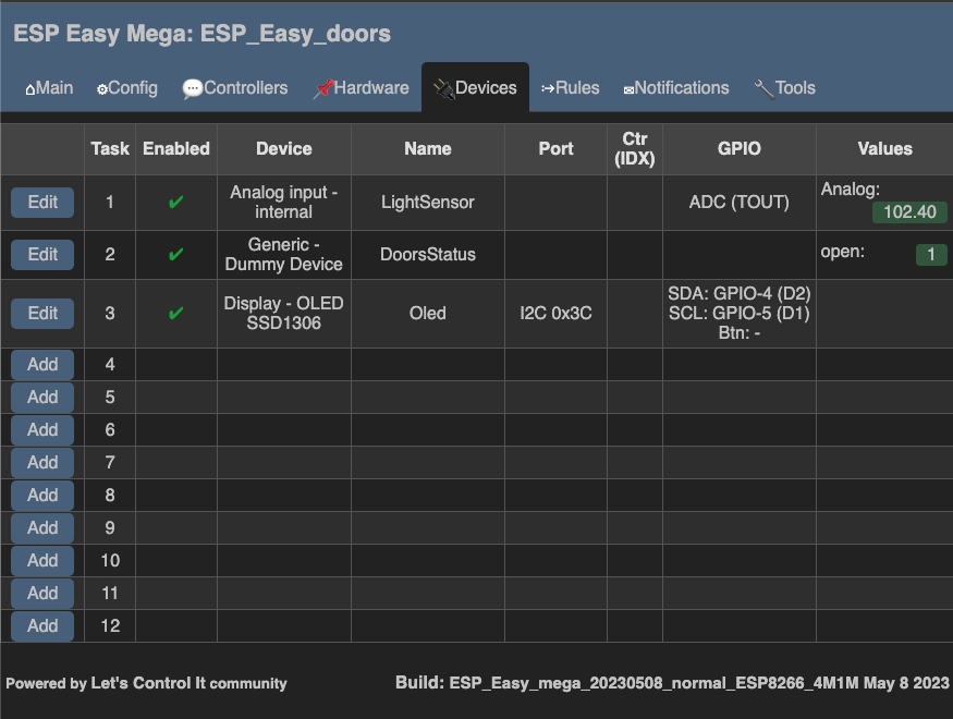

"Final" WittyCloud rules; playing with OLED too. Test run on timer, real operation will use TD-er recommendation - sunset/sunrise Clock#Time (thanks!):

okite
Posts: 15
Joined: 30 May 2016, 23:51
Re: DRV8833 + ESP Easy
#14 Post by okite » 26 Jun 2023, 13:01
OLED info screen:

#26 Post by okite » 23 Jul 2023, 14:18
Repaired...
on System#Boot do
 LoopTimerSet,1,10
  GPIO,12,0
  GPIO,13,0
  //GPIO,14,0  DRV8833
  OLEDCMD,clear
  OLEDCMD,on
 Endon //System#Boot
 on Rules#Timer=1 do   //top loop
 OLEDCMD,on
  If  %iswifi% !=0 And %isntp%=0 // connected but got no time, then reboot to get time
  reboot
  Endif
  If %iswifi%=0 and [DoorsStatus#open]=0 //not connected, thus open the door, if not at night
   if [LightSensor#Analog]>60
    LongPulse,12,1,34 //open doors
    TaskValueSet 2,1,1 //doors open
    Endif
  Endif
//on Clock#Time=All,%sunset% do //will run at sunset
  if [LightSensor#Analog]<5 and [DoorsStatus#open]=1
   // GPIO,14,1 //motor wakeup for DRV8833
    GPIO,12,0
    LongPulse,13,1,33 //close doors
    TaskValueSet 2,1,0 //doors closed
    // GPIO,14,0 //motor sleep for DRV8833
   Endif
 //Endon Clock#Time
 //on Clock#Time=All,%sunrise% do //will run at sunrise
   if [LightSensor#Analog]>60 and [DoorsStatus#open]=0
    GPIO,13,0
    LongPulse,12,1,36 //open doors
  //Endon Clock#Time
  Endif
 Endon //Rules#Timer 1
Thanks for all advices!
