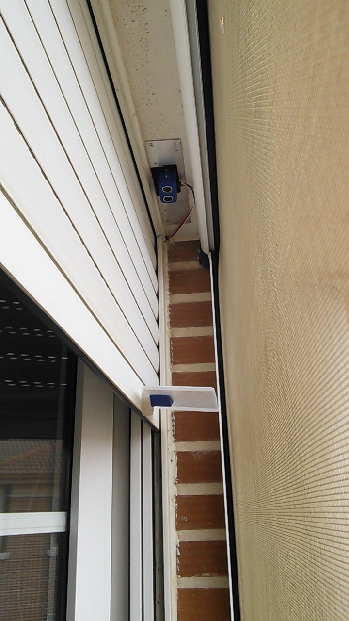

Yes, please! I need a plugin to control my blinds. I read two buttons (to rise/lower the blind locally). I then operate one of two relays to move the blind motor accordingly. I have created rules so that only one relay is activated at a time (I can send commands either locally or using MQTT).
I then use a HC-SR04 ultrasonic sensor to get feedback with the current blind position.
I have found that the HC-SR04 is missing many measurements when using rules, so right now I am forced to use two ElectroDragons to test the concept properly until I get a dedicated blind plugin.

The reason to use an element to get the distance is:
- Get feedback to see if the command was executed. I use it too to get the position of my garage door as a double check (I use also a reed switch to get the closed position).
- Use distance as a goal. E.g. I can tell the blind to go up/down to a certain position.
I first tried to use rules just to execute the blind logic (with no measure value involved) but they were slow and sometimes both relays were activated at the same time.
This is how I have implemented it. I modified device _013 (now _129) and the measurements are executed 10 times per second. I use 5 readings to calculate the median value (I had erratic values from time to time). The new 'blind' device (_130) uses 4 GPIOs to read up/down buttons and to control up/down relays; it is also able to get the readings from device _129 to decide when to stop.
I am not able to attach the two plugin files (_P130_BLINDCTRL.ino and _P130_BLINDCTRL.ino) here. I even tried to rename them to .txt with no success.
