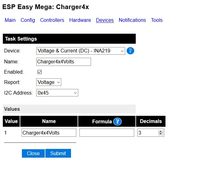

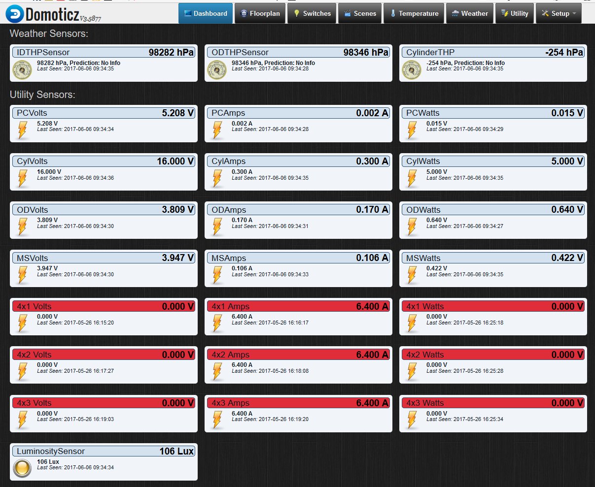

I'm using Release v2.0.0-dev10 and trying to configure my INA219 devices but am unable to select the IDX value from Domoticz. ...though I'm pretty sure that this was avalailable in Release v2.0.0-dev08. Consequently, my Domoticz displays are all red for these devices. Please see attached screenshots.
Please advise if I've missed some configuration change or whether this is really a bug.
Please note that even when using Release v2.0.0-dev08 with the IDX settings, Domoticz still couldn't see the device data.
Domoticz cannot see ESPEasy devices.
No longer any field element to add Domoticz IDX value.

I think in 2.0.10 IDX is removed and changed IDX = TASK.

vuhams wrote: 08 Jun 2017, 16:08 I think in 2.0.10 IDX is removed and changed IDX = TASK.
As every task number starts with "1" in the ESPEasy firmware
that won't work i think.
It seems it has been replaced with something other...
but i don't know with what... the column still is in the task list.

Plugin INA219 was reworked after release 10. Should be fixed in next release

JKD wrote: 10 Jun 2017, 10:40 Plugin INA219 was reworked after release 10. Should be fixed in next release
At least the reworked plugin is not in the sources yet.
Just tested a build from actual sources.
