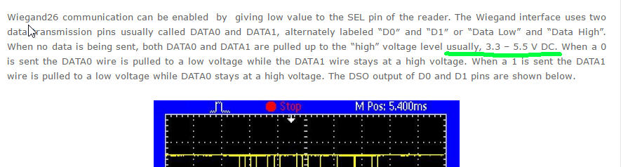

Re: Wiegand26 input from Fingerprint - not RFID Tag
i searched and think:
if the fingerprint wiegand d1/d0 had logic-level of 3.3v,
my setting with the mosfet level-shifter may distroyed the 3.3 side?
because the level-shifter needs 5V on the high-volt side, which had maybe be gone into the 3.3 logic of the fingerprint-reader on wiegand d0/d1?
dont know, but found, that wiegand really could be also 3.3v...
http://www.rhydolabz.com/wiki/?p=9134

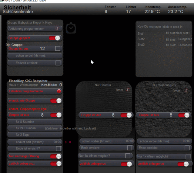

maybe worth copying some ideas from my screenshot? i have timers with one-shot opening, group-access over single-access, 8hrs validity for ...
- Zwischenablage02-keymatrix2.png (94.68 KiB) Viewed 62252 times

yeah, cool idea with rules.
in my personal stetting, i send the ID allways from the reader direct to my homeserver. either way if finger or key.
on the homeserver, i check if the ID has a valid timeslot for opening.
so i limit the parcel-and-post-service-keys to workdays from 09:00-18:00 as valid time for openings.
feels only more secure...
if you take the id from the list, surely no key-open anymore.
but i was wondering, how the chinese inventor thought to solve the problem, to remove a key which is lost and therefore cannot be presented to the reader anymore for removal..
timeslots could be done with rules also, thats a good direction to go...
maybe a plugin with web-input-forms would be the best option for any future-plans with key-system...

Re: SOLVED/Working: Wiegand26 input from Fingerprint - and RFID Tag
simplified my setup,
as i found that one can risk to give 5V on the GPIO of the ESP module,
i left out the level-shifter. It is working!
i addtitionally hooked up a modern NFC-Reader-Breakoutboard (ISO/IEC 14443)
http://www.elechouse.com/elechouse/inde ... ts_id=2242
to have both frequencies on NFC/RFID.
