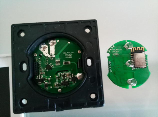

#1 Post by enesbcs » 20 Jun 2017, 01:21
It can be found on ebay as "WiFi Touch Wall Switch Compatible Work with Alexa", and look likes as the following pictures shows. 1-2-3 button and black/white version also available.
With the 64x57mm size of its back, it will not fit in neither 65mm nor 80mm diameter in-wall socket. Maybe in external mounting box will do...
It has an app named Yewelink, tried with it, sniffed the communication with Wireshark: after a short check-in to taobao.com the device logged in to the Amazon cloud. Also see some kind of MQTT communication, but i want to use my own server. (I do not like cloud based solutions)
So i opened it, found an ESP8266MOD inside.
Found the RX, TX, GND on the 2x7 pin JP1, and a possible 3.3V location. (orange cable connected on picture)
On ESP8266 the GND has to be connected to GPIO0 at startup, than disconnect, after that it can be flashed with esptool (dio, 4mbit...)
I flashed with ESPEasy R120, but unfortunately this model does not have connected any relay to any GPIO of the ESP. Only ESP8266 RX/TX connected to a PIC16F1829 and the PIC is the main controller. Added Ser2Net device and try to listen packets. I hoped it will similar to Sonoff Dual, but i have no luck, packets were really different.
Fortunately i have found "Serial Communication Protocol Standard Edition" at https://docs.tuya.com/en/download/
I have created a working plugin and i added it to the Software section of this forum.

I've found another WiFi light switch, i hope it also will be a Tuya clone with ESP8266.. I've ordered today and waiting. It's EU version with rounded back according the pictures.
update: it's arrived, i've disassembled it to see what's inside.
Real EU version, with rounded back, neutral line needed, also an on unusual place.
The ESP-12F module had a really interesting place above the first button directly under the glass. ESP module UART directly attached to a dedicated MCU, and the MCU controls the relays. (NO ESP GPIO used, UART seems standard Yewelink/Tuya solution)
In the inside it looks like a bit crowded:
Sorry for the quality, my LG phone is not a photo machine.
ESP UART is not accessible through pins, as the previous model, instead it need some soldering, i think... if i had some time, i will flash it with ESPEasy. I've found 3.3V&GND pins to ESP, other pins connects the relays with the MCU as i see.

So I will post here my investigations (or create a new post?) Since this seems to me in the context of your work.
Here is my model:
compatible tuya
dimmer
3 buttons (+, on / off, -)
equipped with an ESP8266MOD
bought less than 15 € (postage included)

face led touch
dxfantome
Posts: 11
Joined: 25 Apr 2018, 09:29
Re: Yewelink/Tuya WiFi Touch wall light switch
#30 Post by dxfantome » 19 May 2018, 19:52
inside
dxfantome
Posts: 11
#31 Post by dxfantome » 19 May 2018, 19:53
inside

dxfantome wrote: 19 May 2018, 19:52inside
Nice! The four pins on the left side i think will be the VCC-RX-TX-GND, started with the sqaured one.
But i do not see any serial MCU on this device.

#34 Post by dxfantome » 19 May 2018, 22:47
there is a world on the other side of the first pcb
dxfantome
Posts: 11
#35 Post by dxfantome » 02 Jun 2018, 17:02
I see one "CR302 B751T004BG" ??? what's this ? :?:
and
I see one "8S103F3P6" :
this is 8bit MCU STM8S in tssop20 case
http://www.st.com/content/ccc/resource/ ... 226640.pdf
the four pin with the one square is not VCC-RX-TX-GND
is not connected to esp8266mod but is just connected to MCU
is VCC- SWIM-GND-NRST
the pin SWIN (Single Wire Interface Module) is communication protocol and debug module :geek:
http://www.st.com/content/ccc/resource/ ... 173911.pdf
the pin 21(U0RXD ) of ESP8266mod is connected to pin 2(UART1_TX) of MCU
the pin 22(U0TXD ) of ESP8266mod is connected to pin3(UART1_TX) of MCU
So even if the components and the jtag are not exactly the same, it seems that the logic remains the same. a esp8266 that manages only the wifi and communicates via tx rx has an MCU that manages all the hardware. it remains to be supossed that on Tx Rx transits the game of classic command of "tuya" :D

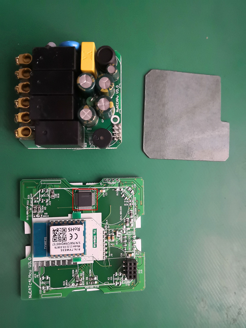

Hello All, Need help regarding Tuya 4 gang Wifi Touch Wall light switch.
It has TYWE3S with esp8266 wifi chip. It also has MCU. I want to reprogram it and want to use it in home assistant. I also attaching its board view. Does anybody have its schematic or GPIO function list or some helpful material?
Also what is the IC number of MCU?
4 gang wifi switch pcb_4.jpg (289.51 KiB) Viewed 643426 times
