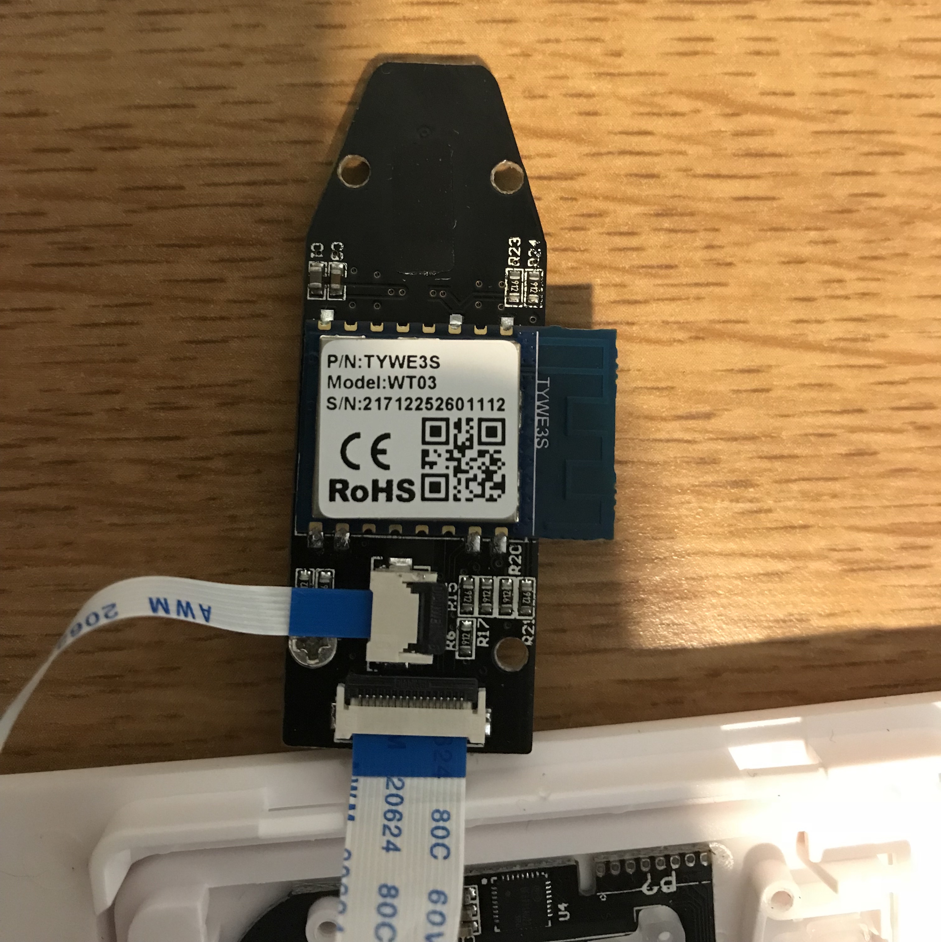

The dimmer seems to be a combo of a Nuvoton 8-bit micro (N76E003) + A Tuya (TYWE3S) + Byd IT Capacitive Touch Key Controller (BF6911A22) from what I can tell. It seems like there is a UART connection between the Nuvoton & TYWE3S, but not usre how the touch key controller is connected. There doesn't seem to be any GPIOs on the TYWE3S

Here are some images of the switch.
