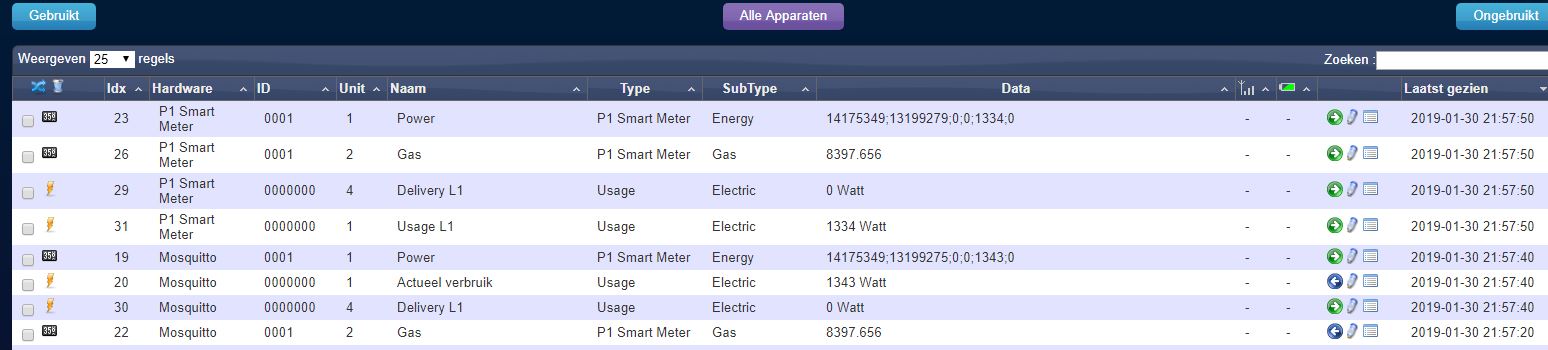

Re: ESPEasy P1 Smart meter dead
Hello Rob,
meanwhile I have been able to flash the ESP8266 with the proper firmware. after adding the device in Domoticz several devices were shown in the setup window including the desired data. But strange enough only "Usage L1" and "Gas" with values that are being updated. However when I click the log button in the Utility nothing happens and I don see graphs.
Another thing is that I am missing the L2, Amp and Kwh high and low.
What am I doing wrong?
- Knipsel.JPG (90.55 KiB) Viewed 28103 times
