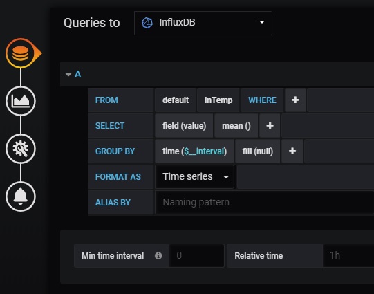

Here's a screen capture from Grafana 6.0.1, and I figure there is something in here that I have setup incorrectly? The InTemp is the table in the InfluxDB and it was automatically found.

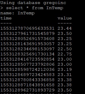

Here's the database table... Here's the Node Red config... What am I missing?? I am open to questions and ideas, and again I appreciate any advice from the members of this forum.

Update!!
So I managed to get Grafana to display the temperature data. Had to 'hack' the query to get it to work... see below. Not pretty, and Grafana tries to change it back when I edit.
I am thinking my problems are coming from how the data is presented to the Influx database, either starting from how the data is pushed to Node-Red via MQTT or how the data is handled by Node-Red and written to the InfluxDB.
At the moment I am 'publishing' two seperate temperature data streams (InTemp and OutTemp), but am thinking it might be best to just publish a single stream with all temperature data and let InfluxDB handle the keys side of things. Have no idea how to do that, so more reading and research.
SELECT * FROM "OutTemp"
