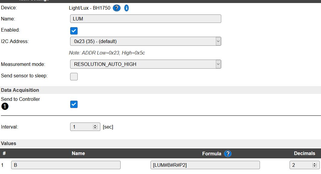

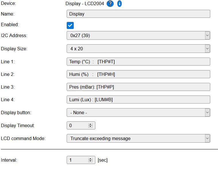

.. nope ... I'm too dumb for that
Where I have to insert it? In the Formula-field at the sensor or in the line-field at the display?
- capture_002_05072019_205641.jpg (47.62 KiB) Viewed 16796 times
- capture_001_05072019_205549.jpg (43.39 KiB) Viewed 16796 times

Re: LCD: right-aligned values ???
If it's not working to add that to those [....] Inside the settings of the LCD task you need to use the LCD command inside rules.
