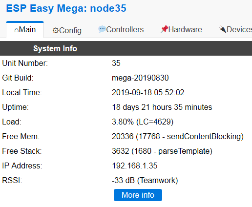

Re: Hardware Watchdog Reboots
Just checked one of my Wemos D1 Minis and found it had been running for over 18-days without a reboot.
This one has capacitors (large and small) fitted to the +5V and +3.3V power rails.

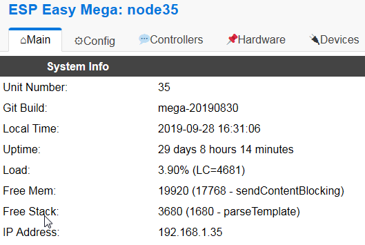

Just a quick update...
Just checked one of my Wemos nodes and was surprised that it had gone for 29-days without a reboot !!!
- ScreenShot035.png (18.35 KiB) Viewed 87293 times
Good to hear it is not only my own nodes having again double digits in days uptime
We're moving in the right direction again... finally.
Still, not all nodes I have are that stable, so we're not there yet.

But after a few weeks it started to be weak again.
So after i flashed a new firmware the ESPs (5 pieces) where online for about 2 weeks.
Then a reboot after a week, then after 2 days and now i do not even get a full 24 hour.
So this is what i can see at the devices.
Hope that helps and can be improved in future.
I need at least a full day without reboot.
Have a great Day
