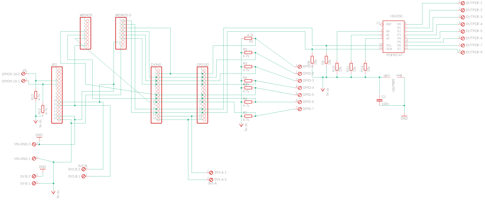

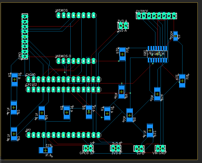

i thinked a board that can allow using this heather pin female:
https://it.aliexpress.com/item/32861400 ... hweb201603_
nodemcu v2 cp2010 ; nodemcu v3 cp340 ; wemos d1 mini
on board i foreseen a pcf5874 connected on TX and RX pin
and i use the suggestion of put on remaining GPIO 4.7k resistor pull up
i used for firts time eagle cad, i attach to you a picture of schematic and bord on 2 layers
it's my firts time, i spend all yesterday night and all today
maybe can someone check if i'm on right way?
i see this prototiper:
https://cart.jlcpcb.com/quote?orderType ... aseNumber=
maybe if my circuite is correct i can ask for a quotation to print my board and assemble the components
what do you think?
in this way i can fix wire using fix screw, i choose phoenix connector that should this one:
https://it.aliexpress.com/item/33010961 ... hweb201603_
then i need to build a cover to put this pcb board on house junction box
thanks for support

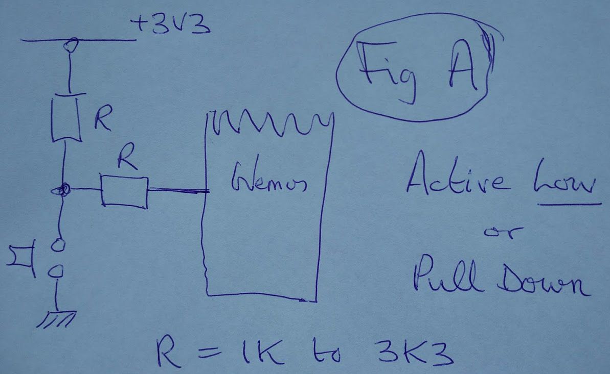

- dynamicdave
- Posts: 258
- Joined: 30 Jan 2017, 20:25
- Location: Hampshire, UK
Re: wiring new house for espeasy and power supply
Sorry I'm a bit late to the party...
I'm paranoid about connecting a voltage directly to an input pin (just in case it was mis-configured as an output).
I just use an extra resistor to limit the current and protect the input pin.
I usually use two resistors connected as per the attachments.
Fig-A is wired as an Active LOW or Pull-Down circuit.
Fig-B is wired as an Active HIGH or Push-Up circuit.
Any resistor value between 1K and 3K3 should work fine.
Regards, David

- Posts: 230
- Joined: 13 Apr 2017, 23:09
hi, i finalize to add two resistor.
can please someone check the wiring and very if all is ok?
thanks so much to all
- Posts: 230
for example:i chosed PCF8574T SOIC-16 and the pins: a0;a1;a2 will be connected to VCC or GND ? i find some different usage....
where should i connect int pin ?
is it correct to put condensator 100n from VCC and GND of pcf8574 ?
the connection of pull down resistors is correct?
i will use toe socket for nodemcu V2 Cp2102, that on left side will be commond with nodemcu V3 CH340 and another socket for wemos
what do you think?
what do you think?

i thought to use pull down, so active low, because looking at this:
https://espeasy.readthedocs.io/en/lates ... /GPIO.html
i will use gpio5 and gpio4 as SDA, SCL
the output of pcf to control relay (so 8 output)
and the gpio of esp8266: gpio14, gpio12, gpio13, gpio0, gpio2, gpio3(rx), gpio1(tx) as input, in total i will have 7 input from nodemcu.
i understood (maybe wrongly) that if i choose pull up i can have some problems using for example gpio0 and gpio4, gpio1 because if they will put on low at boot the esp will not boot.
so, if you can please help me looking at my schematic for example at gpio0:
i painted inside the black circle the resistor that i used. they go to VCC 5v
so, is it correct?
thanks for reply to another newbee stupid question.
The thing is why active low is used, the chips can often switch only very little power on high (like 100µA), but much more like 25mA to low (ground) in case of the pcf8574 (max of 100mA).

at the end...i'm thinking to develop my board (it will be posted open source, and i already posted above some sketch with schematic and pcb) because, using a pcb you will have some advantages:
pin heater to install the esp8266 (nodemcu or wemoss) and you can easy remove / subristute it at necessity
inside pcb i will place some phoenix connectors so i can wire and fix with screw cables for input of wall switch, more strong connection compared to doupont connection
i would like to place inside my pcb also pinheater with same pitch of this relay board, so you have just to put above inserting the female pinheater of my pcb into male pinheater of relaybard. It will be simply snapped in, so no connections
what do you think?

I glanced over your PCB designs and please oh please add filters in the inputs to mitigate noise in the long cable runs. Google "ghost switching".

i'm asking about hight trigger for two reasons:Stejin wrote: ↑04 May 2020, 10:15 These relays trigger (depending on the version) with "low", so why you ask for high trigger buttons? (basically a button)
The Buttons in your installation will never trigger the relay directly. Thats the essential part of home automation, to split trigger and actuator/relay completely with a centralized brain controlling everything.
one is you sentence here:
i undestood that was better to use active on hight.
Second reason is that i want to use this as button:
https://hobbycomponents.com/sensors/901 ... uch-sensor
in this page you can see how it works. it can be used as active hight (default) but also with active low (connecting with a link point A)
in this case(A=linked=active low) the outpin of TTP223 will give +5v and go to 0v when it is pressed. the led on the TTP223 will alwayas stay on, and when i press it switch off...so not so good.
it's possible to flip the led working? or possible to remove led from the board keeping the board working also without led?
yes, this relay trigger with "low" but you can manage flagging "invert relay" in tasmota and also in espeasy. or inside rules using #state=0 to trigger and #state=1 to not trigger
so i think that's not a matter using button that trigger on hight and having this relay trigger on "low"....are two different things that can be cooperate, correct?
understand. but why not powering the relay isng JD-VCC ?
in this case it's possible to power on the relay with a separate power supply, of course in this way you will need a power supply for NodeMCUs and a power supply for relay boards, but you will have power separate to logic, or i'm wrong.
Please consider that i'm not electronic guy, so i just documented my self reading/seraching, so i can be wrong and i'm here to learn and find a best way to operate
last question related to power supply unit.
if i buy a power supply, what is the best?
https://www.aliexpress.com/item/4000545712429.html?mp=1
https://www.aliexpress.com/item/4000192 ... 37559%2323
https://www.aliexpress.com/item/3276980 ... 37559%2323
are from same company but i do not undertand the differences...
about the power, what can be a suitable power for this project?
As jimmys01 suggest adding filters probably means capacitors which increase chargup time for the trigger line. Which means active high will probably not work at all, because the time to charge the line could be longer then a button press. Thats why active low is used.
here i ask both of you,
can you please attach a schetch how to connect the capacitors in my schematic to use push buttons?
maybe specify active low and active high.
thanks so much!!!
