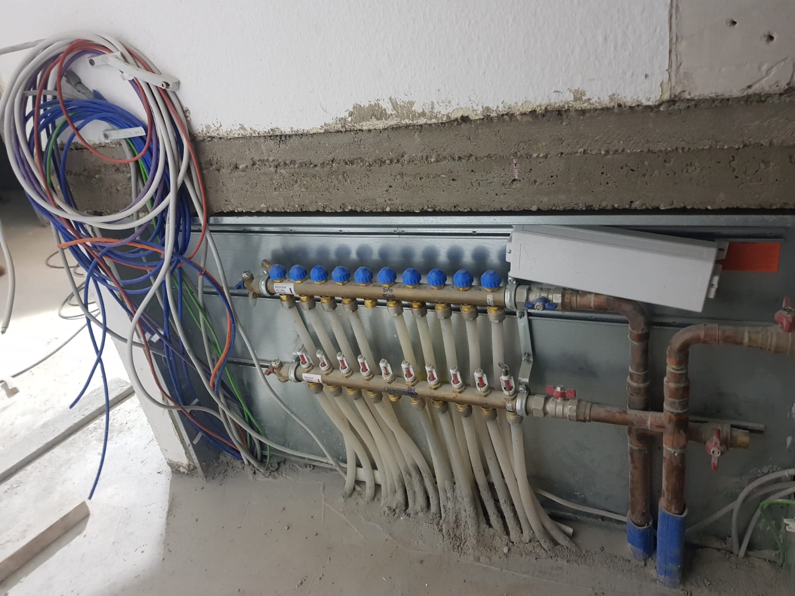

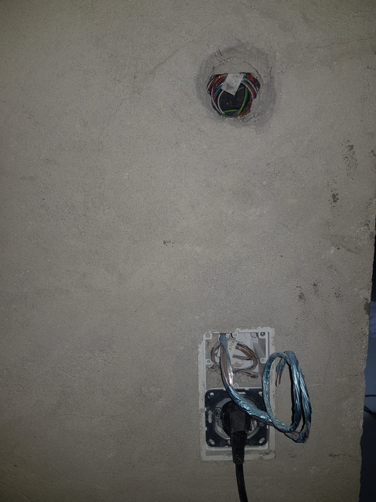

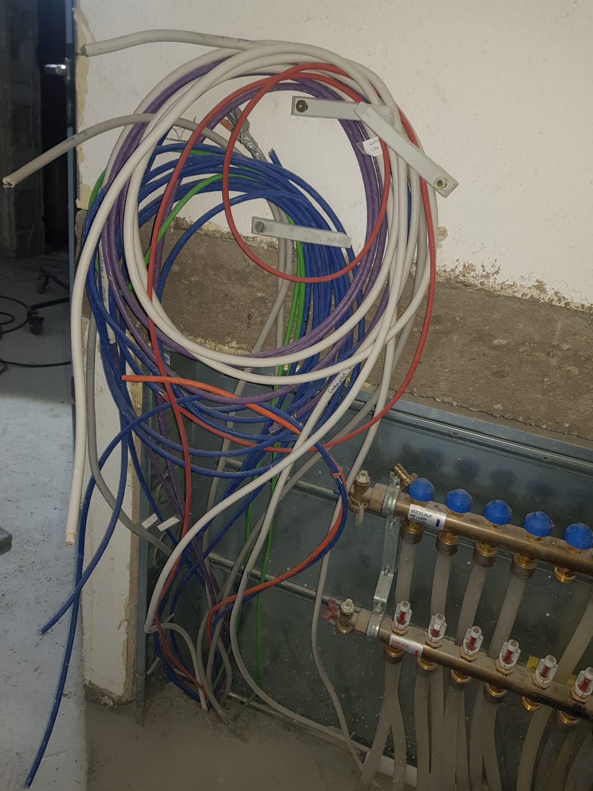

Here we go with the pictures
in every room I have the light switch at 1,2m and at 1,5m I have cat7 cable, 230V and KNX cable for maximum flexibility.
Now I could install in every room at 1,5m one ESP with an environmental Sensor or I can connect this sensor directly at the Cat 7 cable which goes to the underfloor heating distributer Box. The cable length of each cat7 cable is roundabout 3 to maximum 8 meters.
The ds10b20 will be attached only to the return lines of the heating Box with extreme short cable lengths with Max 1m.
Re: 8 evnironment sensors SHT31 via I2C Multiplexer, cablelength
Just to be sure...
You don't have low voltage cables along with the mains power lines in the same PVC tube, right?
The Dutch NEN1010 regulations do not allow to have low voltage and mains lines in the same tube.
I can imagine other countries have similar regulations and I also would like to keep our users alive and kicking
You are absolutely right.
The 230V goes from 1,20m (light switch) to 1,5m without being connected. It will be connected in future if there is needed 230V.
In my case i use 230V OR the Ethernet cable that also isn't attached. The KNX cable the same. Only piece of wire going into the light switch that also has KNX. If needed it will be wired if not it's only nice to have.
This is my method to be absolutely flexible in the next twenty or thirty years. After this period of time i don't think that i need that stuff anymore. Getting old your interests will be completely different ).
