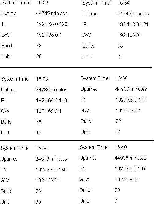

I must say that I did not encounter these mac issues anymore with R78, so it must have been fixed somewhere between R57 and R78. Although most of my units are sensors, they are stable. Also my Sonoff unit with relay is stable. This is unit 30. Just checked some uptimes on my units:
