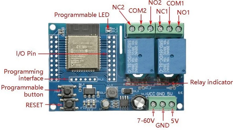

I'm using the following board : Two Canal ESP32-WROOM-32E. See Picture. I use it to close my garage door if it's left open.
I use a relay that sends pulses to open or close the door.
The problem is when the boot card the two relays make a small pulse. In my case, this activates a door movement.
How can I configure ESPEasy so that when it starts up, nothing happens to the relays?

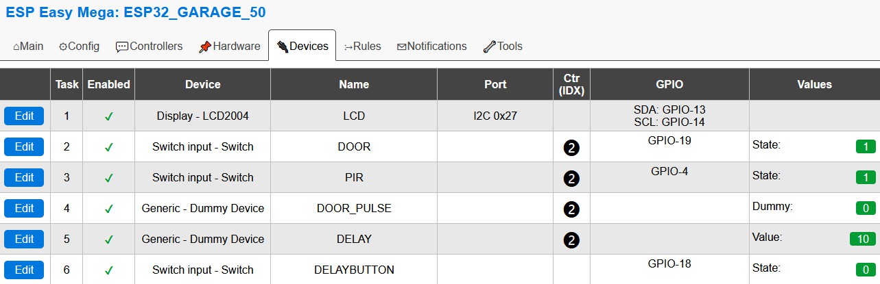

For information here my Rules:
// Info : See Rules 2 / Stand vom : 04.12.2023 /Ho
on System#Boot do
notify 1 //Send Email System Boot
TimerSet,1,0 // Stop Loops
TimerSet,2,0 // Stop Repeat
AsyncEvent,PIR#State=[PIR#State] // Let the PIR eventhandler take care of the logic
LCD,4,1,%ip% // Show IP
on Door#State=0 do // Door is open
event,Progress
LCD,1,1,""
LCD,2,1,"Das Tor ist offen "
on DelayButton#State=1 do // Set Delay ON
TaskValueSet 5,1,40 // Slow Prog.Bar 40s
event,Progress
LCD,4,1,"Pause ist EIN V[Delay#Value]"
on Progress do
let 1,%eventvalue1|20% // Display with 20 characters
LoopTimerSet,1,[Delay#Value],%v1% // Repeat timer 1 every x sec. for n times
on Rules#Timer=1 do
LCD,1,1,{substring:0:%eventvalue2%:********************} // Timer Line 1
if %eventvalue2%>15 // Reached 70%?
Pulse,17,1,1400 // Pulse Alarm
end
if %eventvalue2%=%v1% // Have we reached 100%?
lcdcmd,clear
LCD,1,1,"Die Tor geht zu!"
Pulse,16,1,400 // Pulse on GIPO 16 to close the Door
TimerSet,2,20 // Timer to check it door closed after 20s else repeat
On Rules#Timer=2 do // Door timer
if [Door#State]=0 // Door still open?
LCD,1,1,"Tor schliessung !.."
TimerSet,2,20 // Repeat wait timer 2 until door closed
TimerSet,2,0 // Stop timer 2
on PIR#state do // Will be triggered when PIR state changes
if [Door#State]=0 // Door open?
if %eventvalue1%=1
TimerSet,1,0 // Stop countdown
LCD,1,1,"ACHTUNG PIR Meldung!"
AsyncEvent,Progress // Using default
On DOOR#State=1 do // Door closed
lcdcmd,clear
LCD,2,1,"Das Tor ist zu"
LCD,4,1,"ATEHO 03.12.23 V[Delay#Value]"
TaskValueSet 5,1,10 // Set to fast Prog.Bar 10s

Re: Two Canal ESP32-WROOM-32E. Relais send pulses when booting!
Some pins always do send out some undefined pulses when the ESP boots.
See: https://espeasy.readthedocs.io/en/lates ... e-on-esp32
Not sure if this also applies to your setup.
It is best to pick the state which is the default state at boot for the most harmless situation.
I assume the most harmless situation is to not have a motor running.
Or do you need to trigger a short connection to simulate a button press of an existing garage door opener?
You can have a look at the boot states on the Hardware tab, to see if you can select a state which will not trigger a pulse during boot.
But keep in mind this selected state will only be set after loading the settings, which takes roughly 300 - 400 msec after boot.
I have the same issue with GPIO 17. It´s pulled low for a split second.
The relays on your board seems to be attached to GPIO 16 & 17. Do both relays turn on at boot. (my relay on GPIO 16 is fine)
Setting the boot state didn´t help me. but using another GPIO
(which is a bit more complicated with a ready made board but not impossible
But the strange thing is, that your relays seem to be active on high. Mine are acting on low. Your relay on GPIO 17 shouldn´t theoretically turn on at boot...
GPIO 16 and 17 on a classic ESP32 (not the -S2/S3/C2/C3/C6) are sending out some 80 MHz signal during boot as those would be used for PSRAM if it was present.
So the ESP tries to find the PSRAM and thus sends out some quite high frequency pulses to these 2 pins at boot.
I couldn´t find any issues related to that. I would be strange to sell boards that trigger the relay every time at boot. Could this be an ESPEasy-only problem?TD-er wrote: ↑04 Dec 2023, 16:24 GPIO 16 and 17 on a classic ESP32 (not the -S2/S3/C2/C3/C6) are sending out some 80 MHz signal during boot as those would be used for PSRAM if it was present.
Edit: no, it isn´t
Ok, i was testing...GPIO 16 is HIGH and GPIO 17 is LOW for fraction of time at boot.
Thank you very much for your help.
I also tried setting the GPIO boot states to Output Low, but that didn't solve my problem.
I will try to put a small capacitor between pins 16 and 17 to ground.
Just for information. I just received the same card and took the opportunity to do some additional tests.
If I erase all the ESP32 software and power up the board. Then the relays have absolutely no reaction. As soon as I download ESPEasy, without any configuration, then again I have this problem where the relays switch on for a few milliseconds on power-up.
Try adding a delay at the beginning of your on System#Boot rule.
Just for your information:
I've gone back to my card to redo a test with the latest version of ESPEasy: Git Build: mega-20240414
I also added the suggestion of setting a delay at boot time.
// System#Boot rule with a delay using the Delay command
On System#Boot do
delay,3000 // Pause for 3000 milliseconds (3 seconds)
But this didn't solve the problem, which can only be solved when the card is powered up with ESPEasy. Both relays close for a few milliseconds. This does not happend without ESPEasy Firmware.
On System#Boot do
Just to be clear, your relais are using either GPIO-16 or -17?
I can make a build with disable PSRAM support for ESP32-classic, so there should not be any checking on those pins at boot.
The signals on those pins are of quite high frequency though, so I am a bit surprised the relais do react to it, unless this 80 MHz signal is levelled out to be like somewhat "half" the logic level.
Hello TD-er,
Yes you are right this board with the two Relay are using GPIO 16 and GPO17.
Best Regards
Otto
Best Regards
Otto
Which build type do you need?
I can make a test build for you with PSRAM disabled so you can test if that's the fix.
I used the following build : ESP_Easy_mega_2024xxxx_normal_ESP32_4M316k.bin
Hmm that's odd, as I apparently already disabled PSRAM for ESP32-classic builds back in January.
See: https://github.com/letscontrolit/ESPEas ... dfd09294b1
So in build 20240229 and later this was disabled.
