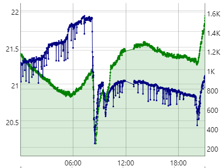

Now, just for curiosity, current consumption graph of SCD40's single measurement

Posts: 5
Joined: 24 Nov 2022, 07:26
Re: Sensirion SCD4X family modules
#36 Post by rado » 26 Nov 2022, 21:12
Here are my readings (green is the temperature).
I've set correct altitude and today I've still got readings around 200ppm:
there is also lot of sudden drops for short time (although home was empty for most of the day).
I'll try to bring it outside when I'll have more time.
#37 Post by TD-er » 26 Nov 2022, 21:34
Sudden drop of temperature is really strange.
Is it possible the connections to the chip are flaky?
For example unstable power supply?

#38 Post by rado » 27 Nov 2022, 09:02
I still have it on breadboard, I've checked the output and it seems there are some restarts. Maybe it drops after restart, it is possible that first readings after sensor powerup are lower. I'll rebuild it to PCB
rado
Posts: 5
#39 Post by rado » 29 Nov 2022, 08:16
Sudden drops are resolved now as I've switched from breadboard to PCB. But it seems strange to me, that in closed empty room co2 have dropped by 300ppm over night. I have good windows and also humidity was constant whole night so I don't think the fresh air made it into a room
#40 Post by TD-er » 29 Nov 2022, 08:34
As with all kinds of transfer (heat, air concentration, etc), the transfer speed increases proportional to the difference of what needs to be transferred.
Heat transfer speed is faster when the difference in temperature is higher.
That's why you can heat up a room with a relatively small radiator, only if you supply hot water. With relatively colder "warm water", like with a heat pump, you need a much larger radiator. (e.g. a heated floor)
The same applies for gas mixing.
If the concentration differs between gasses, the exchange rate is faster. It slows down when more gas molecules have exchanged.
Just compare it with 2 jars of marbles. One with red, one with blue marbles.
If you randomly exchange 2 marbles from each jar, your first exchange will for sure be a red one from one jar and blue from the second one.
However, after some exchanges, you will be more likely to exchange a different color.
This decrease in exchange rate is showing perfectly in your chart.
You do have some natural ventilation and without people or animals in the room, you will not add CO2. Thus the CO2 concentration can only become lower.
