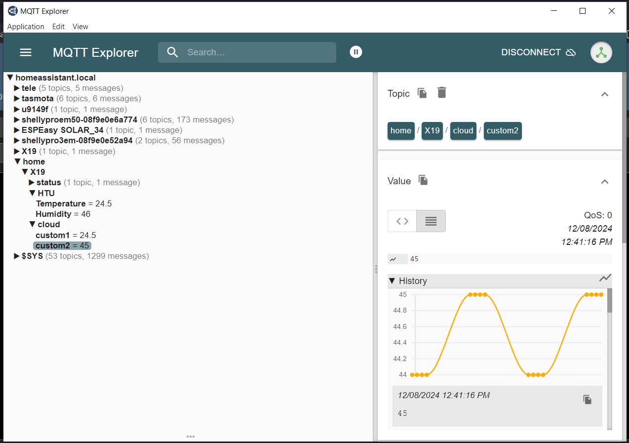

Hello again,
Started to play with two controllers flip flop.
I have a 4MB ESP12s board with a HTU sensor attached Task1 send data to controller2, aka local homeassistant and task5 should send data to remote mqtt, controller1 but it doesn't
I made a rule, every minute, for testing: every minute controller2 is disabled for 15sec and taskrun5 seems not sending any data to mqtt1 server
I tried on task5 to set interval 5s, 0 ... same result, not sending anything. Should I use "publish mqtt" command or I'm missing something?
Checked the status of controllers, works accordingly: controller1 enabled 15s / controller2 disabled , then controller2 enabled 45s / controller1 disabled

Re: Using two mqtt controllers same time
In mqtt explorer, without flip/flop rule, HA mqtt enabled,aka controller2 everything works as expected
cloud with two entities, custom1 and custom2, but Task 5 should send data only to controller 1, not to controller2.
And the data collected by task5 , send data to controller2 instead of controller1, so I have no data sent to controller1
With rule flip/flop enabled, I have this
Notice , in HA broker appears And the data collected by task5 , send data to controller2 instead of controller1, so I have no data sent to controller1
Tried a delay of 2s after enabling controller 1, no effect
Log
