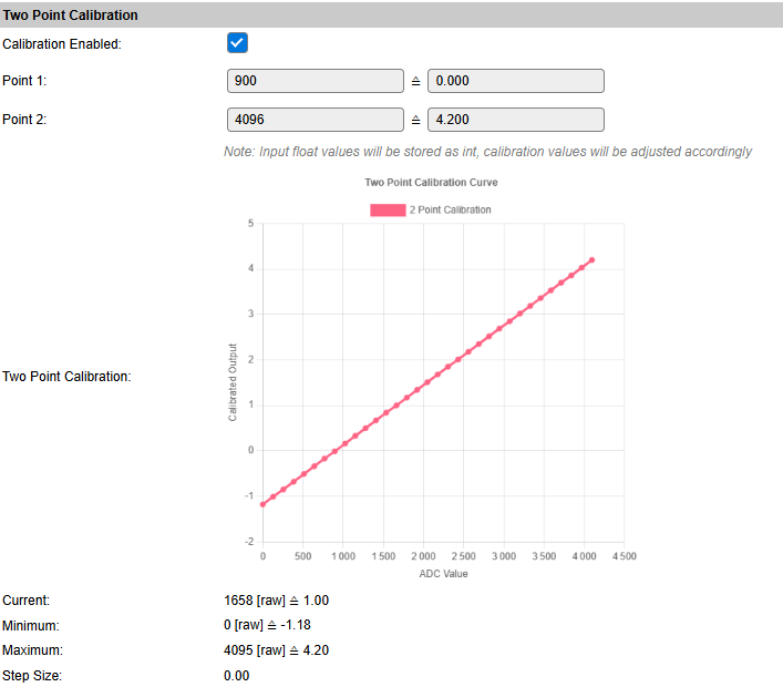

Re: Analog 2points calibration lost after power reset
The calibration is done in the task
- Calibration anaolg value.png (32.03 KiB) Viewed 3466 times

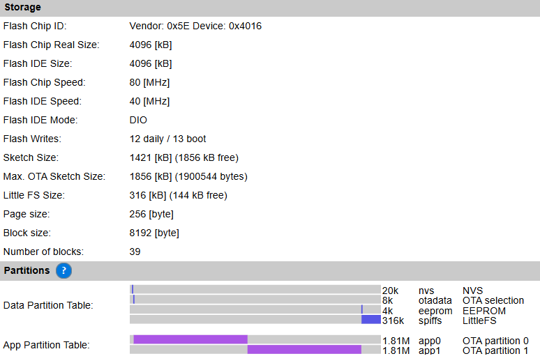

Are the settings still available when saving them, going back to the Devices list, then entering the settings page again?
What's the available space on the file system? (Data available at the bottom of the Tools/Info page: "Little FS Size", xxx kB free)
Yes the data are available after a save of the task like all other task.
For the storage please see
- Calibration anaolg value info storage.png (24.98 KiB) Viewed 3460 times
Hmm what is stored on the file system?
You only have 144k free, which is a bit small given the settings file is 128k and with LittleFS it is writing the entire file. (which is the reason why LittleFS is so much less snappy compared to SPIFFS)
I Updated the firmware by OTA and put the bin
The problem stays.
I need to submit the task even without changing nothing to activate the calibration with 2 points . The task come always back to standard calibration
The storage info is as follow :
ESP_Easy_mega_20241222_climate_ESP32_4M316k
- Esp32Chaudiere Storage2.png (25.25 KiB) Viewed 2947 times
