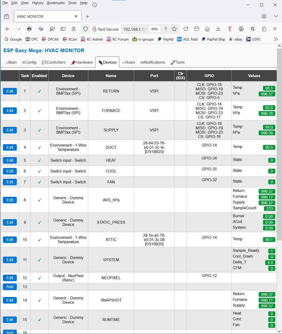

I use five Dummy Device plugins, mostly because they allow me to assign useful names to vars. One of the Dummy's (all of its three values) won't accept data that I store. All remain at zero. So probably not related to RTC.
I haven't had time to further debug this. I am juggling other projects at the moment.

I installed EasyFetch 20250311/efc_chart1. I saw the chart window update, with a few seconds delay between each update. So that is a win.
But after a minute or so the ESP became unresponsive. After several more minutes I was able to reach the default ESPEasy GUI. But each time I tried to view EasyFetch it became unresponsive again.
ESPEasy does not reboot, it just stops responding for a while. Browser reports "The connection was reset." When it is unresponsive the device still acknowledges IP pinging.
In case you see anything important, I've attached the json from the device index that I chart. EasyFetch charts the Delta-T and CFM data in it.
I am using ESPEasy SPIFFS build mega_20250310 ESP32_4M316k. Which build release do you use for your EasyFetch development? And is it SPIFFS or LittleFS?
Edit: The most reliable version of EasyFetch for me is the 20250221/efc6 release. So I have reverted back to it.

In fact the update interval in easyfetch is 2 seconds. So this delay is normal.
This is really strange.
Easyfetch works the same way, the /devices tab of ESPEasy works. It fetches the JSON of the device and your browser draws some nice tiles and puts the data in it.
If ther is an issue, than the /devices page in ESPEasy should also become unresponsive after a while.
Easyfetch is even more conservative with the update interval (2 sec vs. 1sec)
Unfortunately this doesn't help me. If easyfetch displays something, than the JSON is fine. The content of the developer console would be more helpful to see the errormessages.

I have not had the issue while in the native ESPEasy pages. Only occurs when I visit EasyFetch page. And turning off the graph did not solve it.If ther is an issue, than the /devices page in ESPEasy should also become unresponsive after a while.

While on ESPEasy's main page, ping times vary from 43mS to 500mS. And I sometimes see a timeout, which is concerning. RSSI is -43dBm, so signal strength is very good.When testing a continuous ping to the ESP device, are the ping times constant?
Ranges from 395 to 962mS. Avg somewhere in the middle. 8.87kb transferred. But this is the older "working" EasyFetch version.Can you check on the inspect window of your browser on the "network" tab to see how long it typically takes for your JSON loads to complete?

Thanks for the new release. It still hangs on my mega_20250310_climate_ESP32_4M316k device. I need to crawl into the attic and remove the device so I can convert to LittleFS using the latest ESPEasy test build. I should be able to do that in a few days.
Re: maybe easier to use Dashboard replacement
I visited the attic and pulled the ESP32 device. Then it was erased and updated with the latest ESPEasy (mega_20250429_climate_ESP32_4M316k_LittleFS_ETH) via TD-er's webflasher. Lastly I went to your github test repo and installed the latest fetch.html.gz.
But unfortunately the hang problem remains. If I stay on ESPEasy's web pages everything is fine. But if I visit the EasyFetch dashboard the device works for a brief period, then stops communicating. Pinging still functions during the hang and I get a page reset warning in the browser if the page is refreshed. After anywhere from 2-15 minutes, the device reboots, and works again for a short time. Rinse and repeat. This stalling occurs often, which makes operation difficult.
After several hours of poking and prodding, I've made a few observations. Unfortunately I did not have any ah-ha moments that will help with the diagnosis. Here's a summary:
1. I initially reloaded my old EasyFetch configuration (main_efc.json). This did not work at all because all I saw was a mostly blank dashboard page with the home and hamburger icons at the bottom. Deleting the config file restored the default dashboard tiles.
2. If the main_efc.json file is removed, EasyFetch never creates a permanent stall or reboot. I will randomly see it stall for a few seconds, but it always recovers without a reboot. Unfortunately this is not a good solution because I want to customize the layout.
3. I currently have 13 device plugins that report data. During troubleshooting I added a system info device to help debug, for a 14 device total. With this extra plugin, anytime I save the EasyFetch layout, the new plugin is deleted. I can consistently repeat this fault. I tried adding it to the empty #13, as wells as the #16 Task locations; Both experience this deletion issue.
4. As mentioned, I have a lot of plugins on this device. Perhaps this complexity is involved in my sad situation? Below is a screenshot of my plugin configuration.

Yikes, I see some fetch.html.gz load times that are extremely close to 1000mS, which is the page refresh time. So I think you are on to something. That is to say, maybe the reload/refresh needs to be 1500mS?
BTW, when the hang occurs the inspector's "Transfer" column begins reporting NS_BINDING_ABORTED every second.
I didn't perform EraseSDKwifi because I read the github discussion for the new ESPEasy test release. There was some info about how the wifi calibration data would be erased automatically to ensure connection success. So I didn't bother with the extra step. But since you asked, I performed the reset. It seems better now, but still experiences the hangs.
