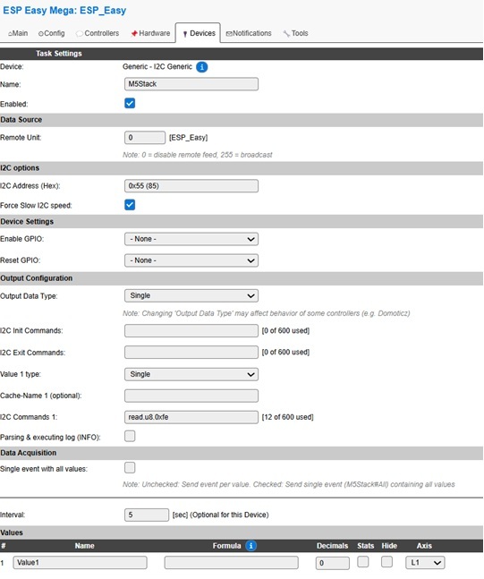

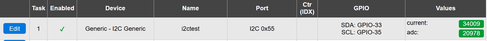

I've created PR #5296 to add P180 - Generic - I2C Generic to enable to read I2C devices 'manually', by getting the required command sequence from the data sheet.
I'll add a command sequence for your M5Stack sensor soon, and also a binary to upload to your ESP32-S2.

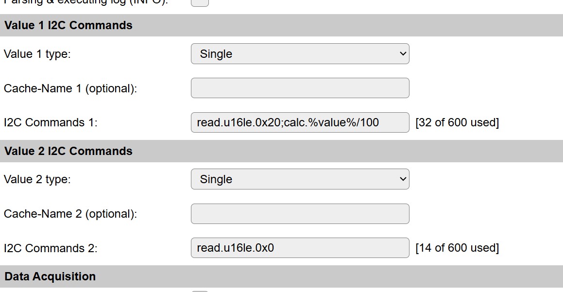

I'm thinking of adding this plugin to all ESP32 Collection builds (including Climate, Display, Energy and Neopixel), so I've built an ESP32-S2 Collection_A build for testing:
This will read the 'Current' value from the M5Stack sensor, divide it by 100 to get the mA value, and assign it to the first (and single) Value1 field.
If you also need the raw ADC value, set the Output Data Type to Dual, and enter this for the I2C Commands 2 setting:
It will read the raw value from the sensor and set that to the second Value2 field. You can rename those Value names, if desired, of course.

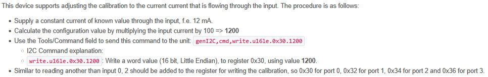

Writing custom commands, like changing the calibration, to the sensor can be achieved via the 'geni2c,cmd,...' command, where for the dots you can add a supported command, as listed in the source (and later in the docs, of course)
You can add the Generic - I2C Generic plugin to an available task slot, give it a name, set the I2C Address to '0x55', set Output Data Type to 'Single' and enter this for the I2C Commands 1 setting:
read.u16le.0x20;calc.%value%/100
read.u16le.0x0

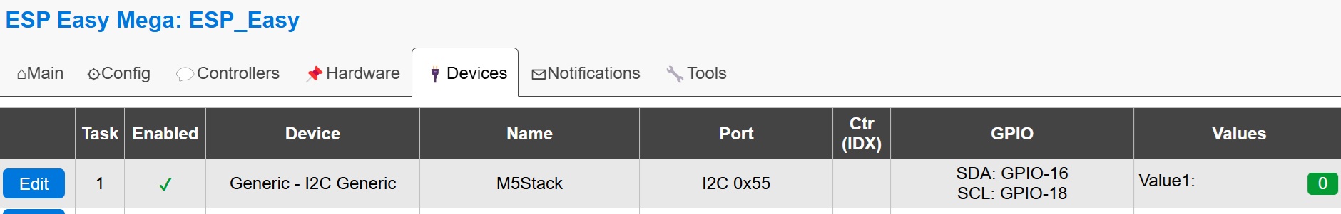

Re: Unknown i2c device - 4-20 mA measurement M5stack
I am sorry, I am not able to flash my wemos s2 mini and I don't understand why....
I was able to flash it online with a normal ESPeasy Version, the ESP Easy Flasher find the device as COM4 but there are always errors..
I tried it with two boards. If I try my C++ programs with Arduino IDE the USB connection sound is coming from time to time, it seems that there is no stable seriell connection. Sometines it is COM4 and then COM5.
I push 0 and RST button and then release RST to bring the device in flash mode, then the USB sound appearrs.

for a simple first test without current source I want to read out the i2c adress, is this command correct ? or to get the calibration current ?
Because for both values I get 0 at the moment
I2c scan finds the device at 0x55
read.u8le.0xFF;
read.u16le.0x30;
There is currently no support for u8le, as little endian doesn't apply to a single-byte value
Using u8 there will probably work better. When never set, and there's no real reason to change, it might return 0 though.
Alternatively you could read the firmware version at register 0xFE using the command read.u8.0xfe
NB: you are putting these commands in the I2C commands field, I presume? Then the Interval should also be changed from 0 to f.e. 10 to have a repeated read, or a taskrun should be applied on the (enabled) task, to get the value updated.
Edit: Corrected Version register to 0xFE (first edit was from memory
for a first test to read out the firmware version, I get value 0, so I think it is wrong
at the moment it is difficult to make tests with this wemos device because I loose the connection a lot of times, don't know if it is a problem of my wifi or of the device....
try more tests tomorrow with a second device....

I've fixed some issues, one of which explains why you didn't get a value from your device... (you could call that a bug, in fact).
Here's a new ESP32-S2 Collection A build for you to test: To get the result available, the I2C Commands should be set to (same as before):

I am back and got new devices.
Unfortunately I had 5 wemos s2 mini which are not original, now I have one directly from wemos and made a test with that device. Unstable wifi is horrorable, I guess that I got shitty boards. In future I will use different boards than s2, but this firmware only works with s2 or not ?
I can read the firmware (version 1) and the i2c adress (85) succesful.
For the current value and the adc I get strange values, I guess that there is a problem with the data type ?
I connected a 4.00 mA source so a value with something around 3.4 mA would be maybe ok without calibration.
I don't know at the moment how many bits the ADC has M5stack use, I can't find a information about it, only one source says 16 bit, so 65536, 20978 seems to be to high...

from M5Stack I got the answer that the function "uint16_t getCalCurrent(uint8_t channel);" is not available and they removed it from the source...
I am sorry but I don't understand how to use the function to send a command. I need this to send the value "1000" for calibration (for 10.00 mA), from the source it would be: with values
register is 0x30
how can I translate this into this?
genI2C,cmd,<i2c-command-sequence>[,<value-index>][,<cache-name>]
I guess I need a rule for that ? An example would be very nice, maybe for the readme two, thanks!
void setCalCurrent(uint8_t index, uint16_t value);
void setCalCurrent(0, 1000);

Ah, some readings are getting visible, great. (I tested using a different, more complex protocol, I2C device).
The documentation is quite unclear on what value to expect, so I picked 100 as the factor, but you can change that to 10000, of course. Or maybe the polarity needs to be reverted, as 34009 decimal is 0x84D9, with the highest bit On meaning a negative value... But in that case it should show -1241, also not close to 4 mA.
Or change the command to only be
read.u16le.0x20
Changing 0x20 to 0x30 will read the current calibration, if that (still) works; removing that feature from the library source doesn't remove it from the device, unless it never worked in the first place
The Arduino library has a function called getADC12BitsValue, which suggests it's 12 bit, but I wouldn't know the actual resolution, again, documentation is sparse.
I'll respond with suggestions for setting the calibration later.

To see if the sign is actually the cause for these strange/unexpected values, you can replace "u16le" by "16le" to get a signed value from the device.

As promised, here's the suggested method for setting the calibration (untested...
